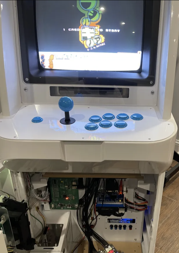

The Jammafier is virtually lag-free, if you couple it with an ossc or retrotink, I dont think you will notice any lag. I havent and Im sensitive to it, so the Jammafier is the way to go if you want to hook up jamma boards with ease to JVS cabs. @invzim is the creator of the Jammafier and Irken Labs is his company/website.
I even use the jammafier in a cab conversion I did since I installed a Taito JVS io for controls, I had extra harnesses and io so why not
