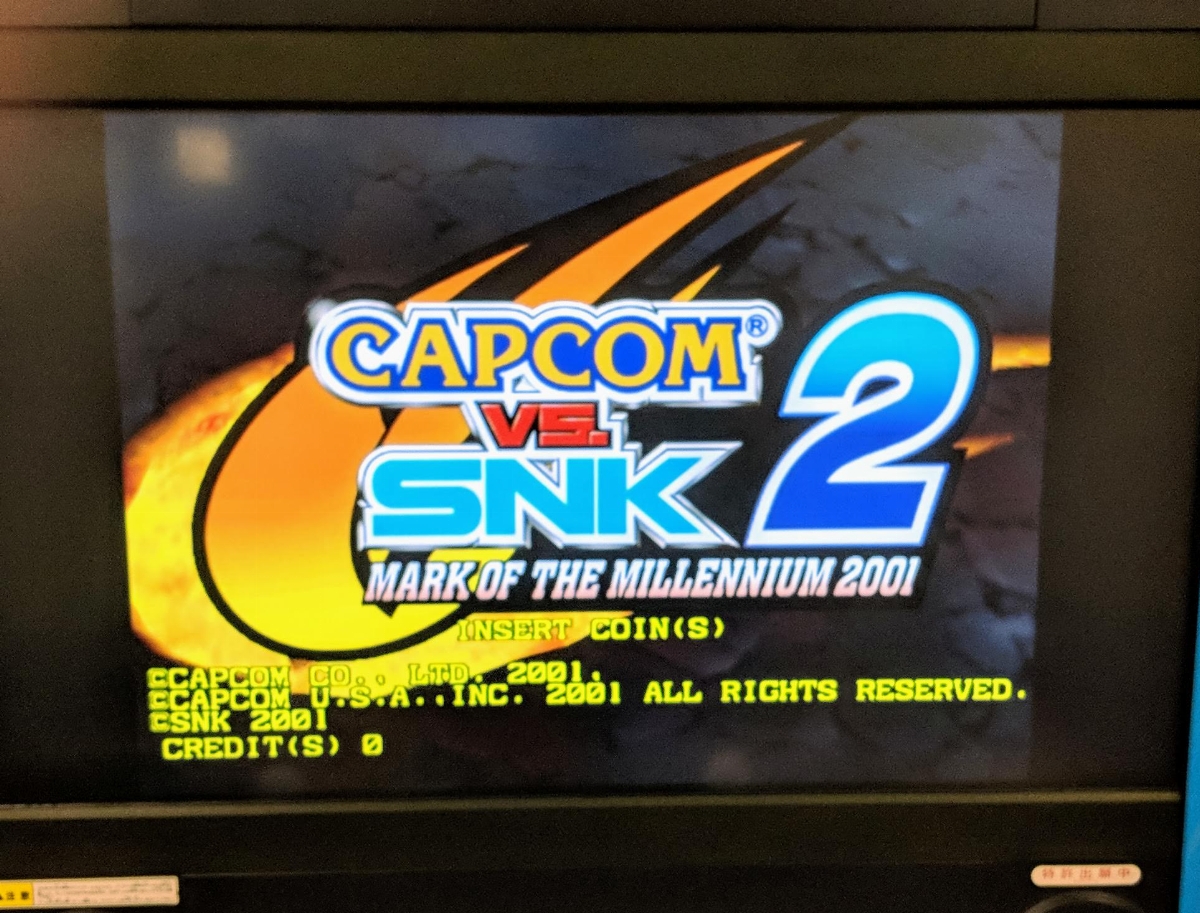

People still asking about this, so I went ahead and did it myself. Soak tested and it worked just fine on my JVS IO. This is for the NetDimm version. If I ruffled feathers on Twitter for my wording, I apologize. I bear no ill will towards AP (this is a pretty fringe case), but all ill will towards Discord.

Led you nowhere is a bit of a stretch when the hex values are posted in this thread.
MetalliC said:
patch is:
offset new_value old_value
00001AAA: 0B 0C
00001AD4: 0B 0C
00001B10: 0B 0C
this patch is for "World" CvS2 version, (GDL-0008 )
