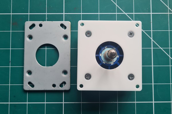

Adapter plate to allow a Seimitsu LS-32 or LS-32-01 to be fitted directed to a Taito Vewlix control panel.

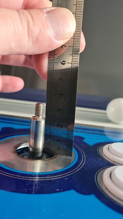

Once fitted, the CP > underside ball distance is approx 24.5mm.
The standard SE or SS mounting plate can be removed and the printed adapter plate fits directly to the joystick using the stock CSK screws.

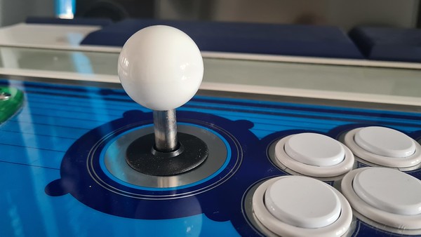

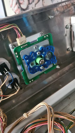

The joystick can be fitted directly to the Vewlix control panel. The E3018350A mount is not required for use with a LS-32/-01.
Access to the control panel studs/nuts is impeded by the LS-32 micro switches or the LS-32-01 PCB so you might find it easier to remove these prior to fitting and then refit once the stick is mounted.
