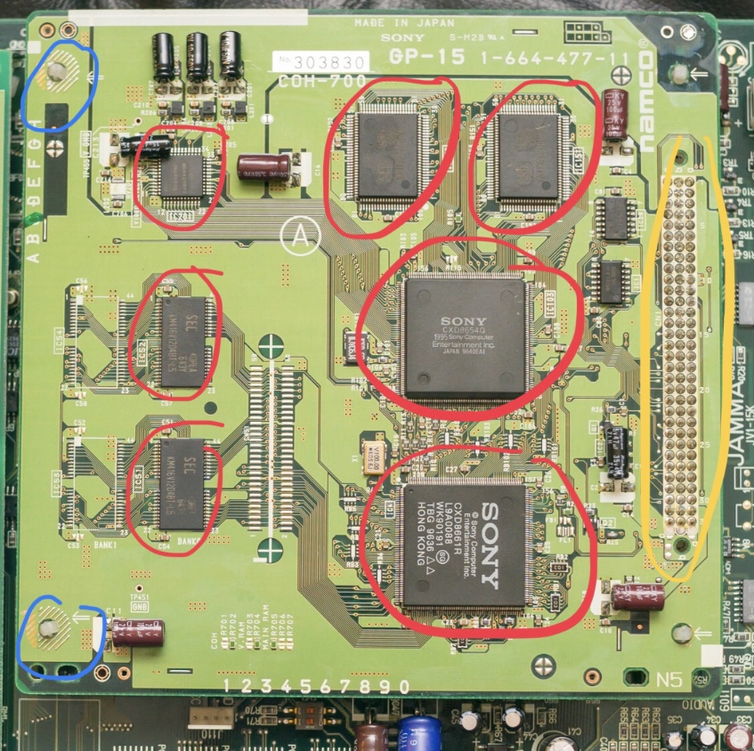

I had the same problem with my Tekken 3 board. I found out that it works when I lift the upper board a bit. Just don’t „click it into the holders“. I hope you understand?! Then I touched each pin of both connectors (top and bottom) to make a good connection and added some flux to a desoldering braid and reflowed the chips (these with a lot of pins) on the top. Now it works perfect again :thumbsup:
I hope it helps you, good luck!
This one:
Don’t click in the blue marked holder for testing.
Reflow the red marked chips.
Touch the yellow marked pins and also on the other side (bottom board).
Please keep in mind this is not my board, I can’t do pictures currently! My board had a missing cap I had to replace it. This board here is from @SmokeMonster and he replaced every cap!
