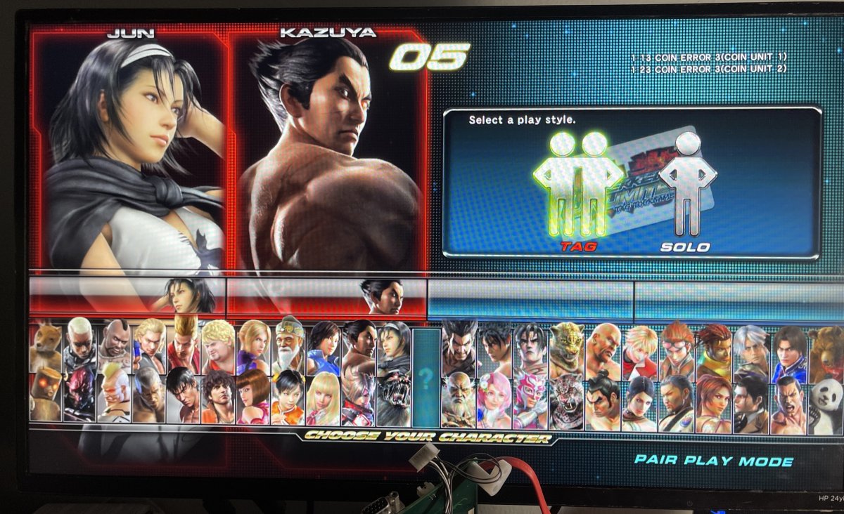

Hello everyone, I recently received another 357C which I have converted to a TTT2U. I got another system as I wanted to know how pair play mode works. What is needed? How do I hook up two systems for pair play?
Ok, this is the info I got in terms of the router IP:192.168.93.11
Unfortunately I can’t try it out as I sold my extra tag 2 unit.

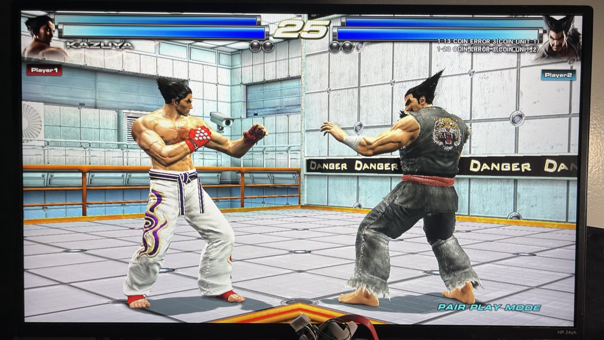

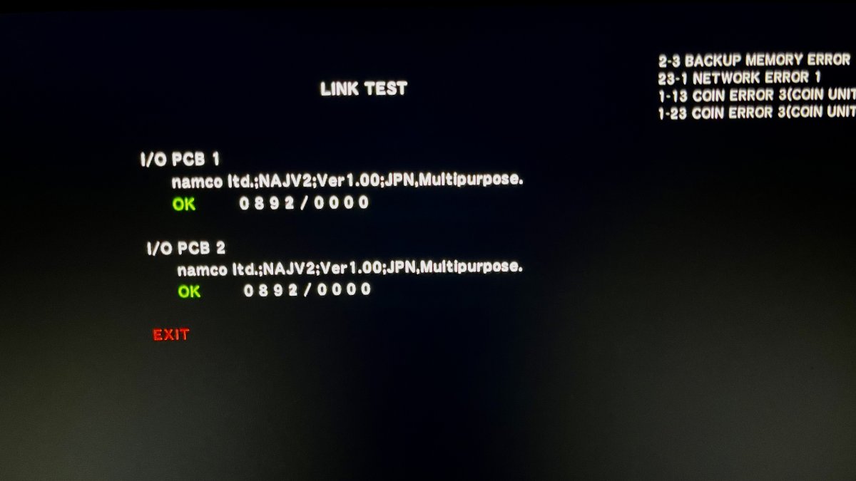

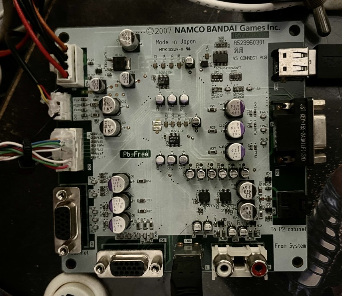

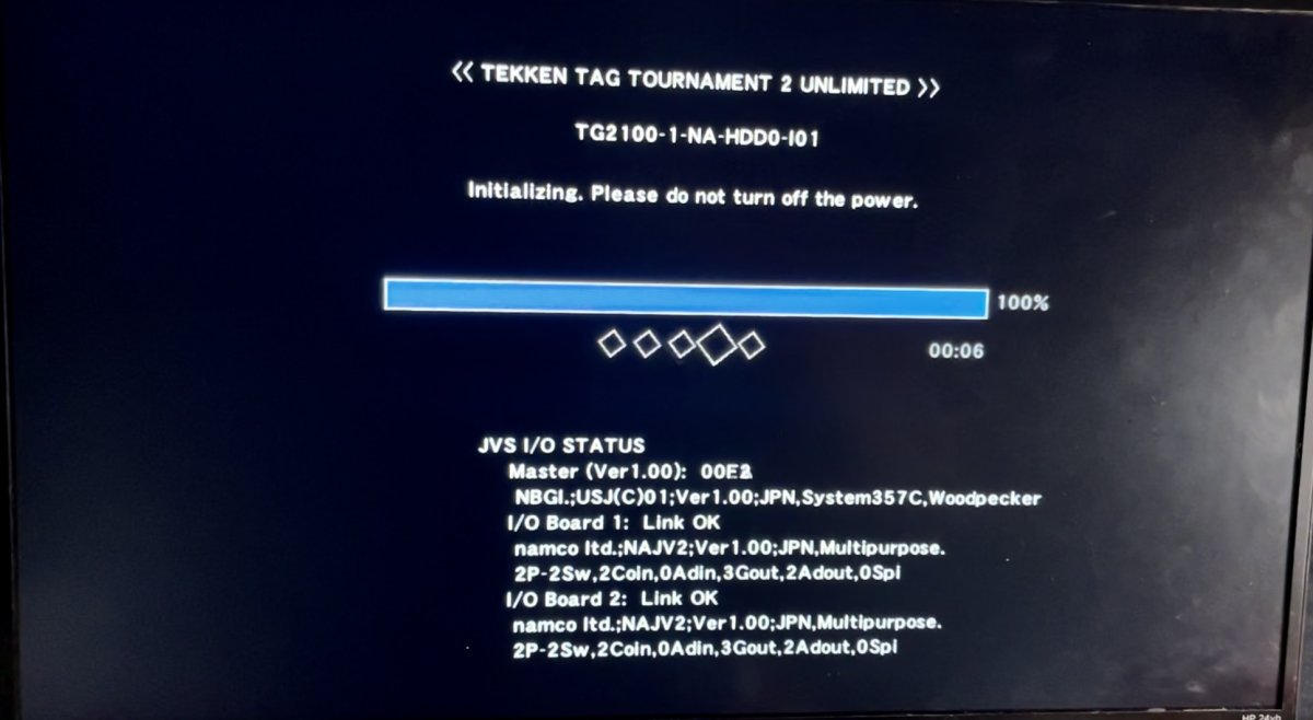

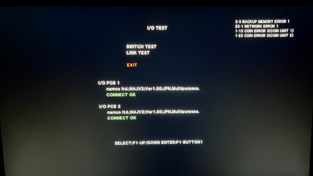

Ok, I finally figured it out but first, huge shoutout to @ArcSys101 for hooking me up with the right part for my little experiment. So, for pair play to work, the game doesn’t use LAN like Tekken 7 or DragonBall Z Zenkai Battle but it uses JVS linking. For my experiment I needed to use the Namco VS CONNECT pcb to get two JVS I/Os to work on one system, I only had two Namco NA-JV2 I/Os to test but they work. So, In order to play in Pair Play mode or easily separate player 1 and 2, you need an I/O or I/O extension that supports JVS daisy chaining.

So it ended up being 1 257 and 2 IO's and the vs pcb
or did you still need 2 257'?
