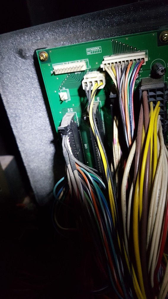

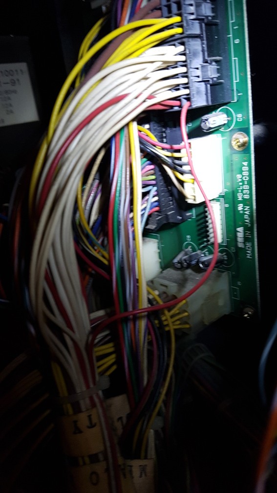

But I wanted to ask you guys for some help if possible, based on the photos attached,
which is my kick harness that I would need to plug into the cpsx adapter from xianxi? As my blast city can had 6 buttons wired in when I got it.
I was thinking this might not be a regular cps harness, as there is no connector on the left most port under the control panel.
Please help me out any way you can! :)

Sorry, I'm pretty new to this - so from the photos I have posted, how do my buttons 4 5 6 appear to be wired in?
Does it look like I could use a cps to Namco adapter, or would I need to change the wiring in some way to get buttons 4 5 6 working on a Namco system 12 board?
Thanks a lot in advance
From what I can tell its wired for jamma,
But the kick buttons appear to be wired in with the regular buttons, rather than on a separate harness or adapter.
Can I simply use a cps kick harness in the cn8 slot on the io board at the same time, without having to rewire how the 4 5 6 buttons currently connect, or would something like that just not work?
Sorry if I am not making a lot of sense, trying to get my head around a lot of this!

The way the Blast is wired all buttons for both players go into Blast-City specific connectors inside the control panel Box, these are then routed down to the "I/O" board in the PCB area. Your JAMMA harness connects to is board, and your "kick harness" will connect to this board, assuming all 6 buttons are wired and working in your control panel you shouldn't need to touch any of the wiring on that part of your cab.
Do you play any 6-buton games on this cabinet currently such as Street Fighter II or other similar 6-button games?
Yes, this is exactly what you want to do. Connect the kickharness from the PCB to CN8 on the IO board and you have buttons 4, 5 & 6 for both P1 and P2 on the auxiliary controller connector under the CP.
