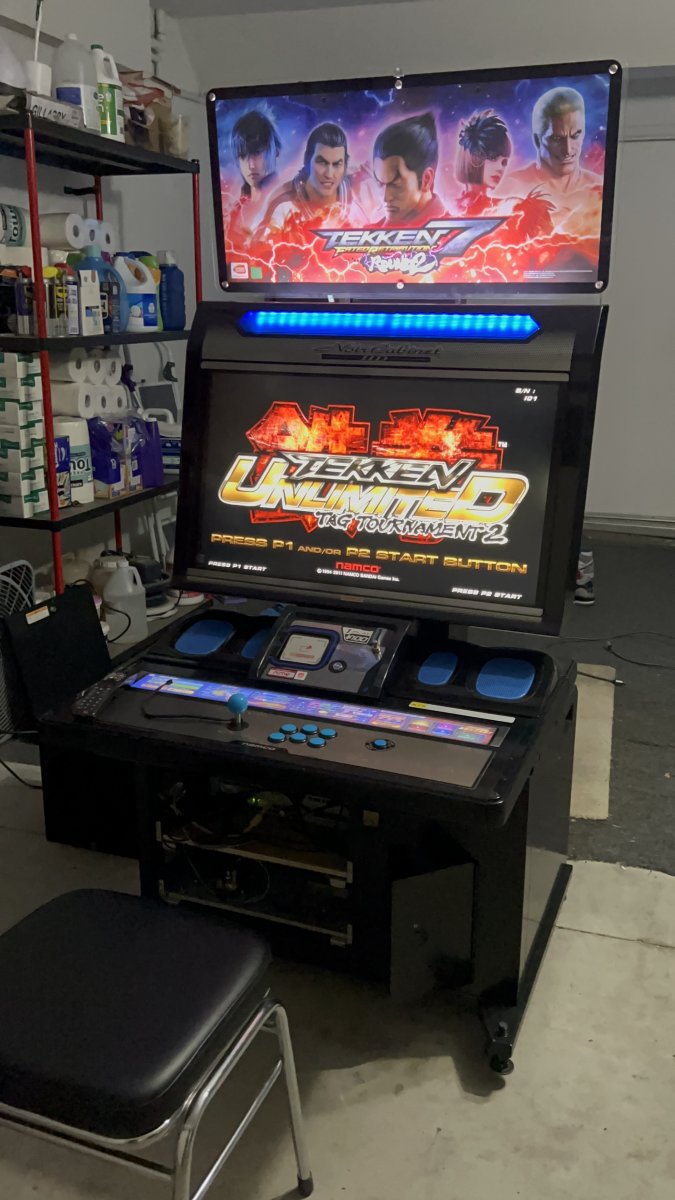

Hello ! I have a problem my TTT2U ;(
How can I fix this ?
Change the cmos battery inside ,there are two cmos battery location
One in the playstation 3 motherboard
One in the internal i/o
It is a easy fix
