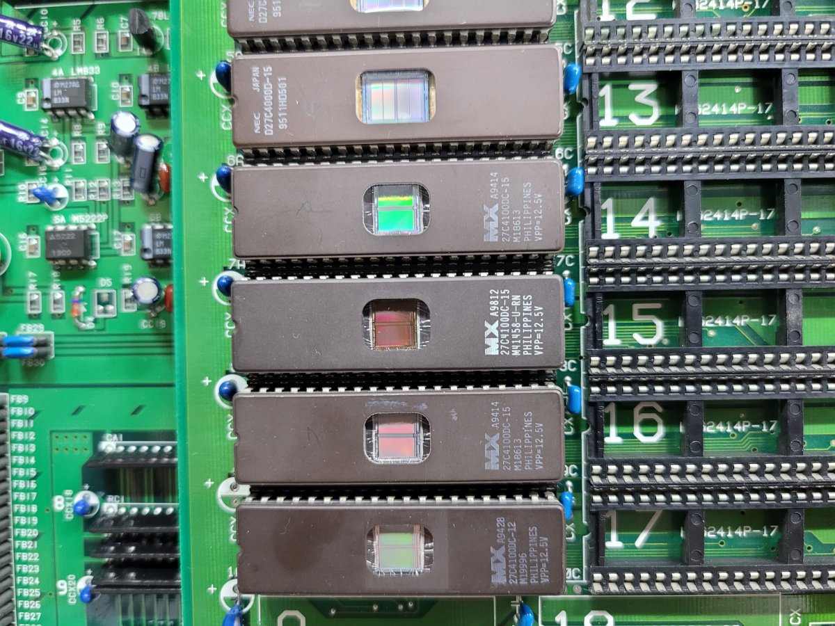

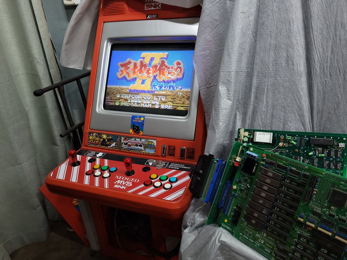

I converted Tenchi wo Kaoru 2 pcb to CPS Changer Tenchi wo Kaoru 2.
I wanted to play Ura mode.
First I changed CPS C-board to normal B-21 board.
And...
I changed 3 EPROMs.
27C400 - wofch_06.rom (non jedec) - my CPS B-board is 91635-B
27C4002 - wofch_22.rom (jedec)
27C4002 - wofch_23.rom (jedec)
And... It works on like CPS Changer version.

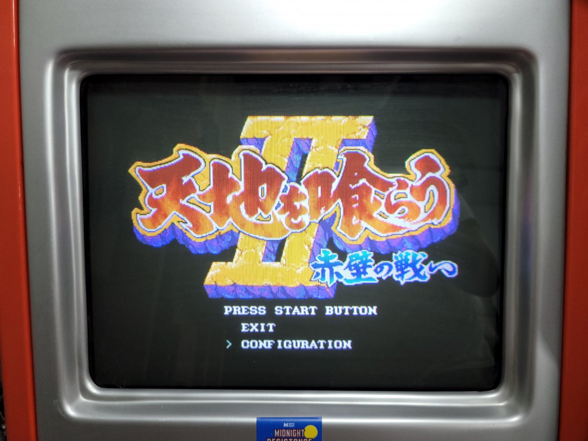

Entering Ura mode
-Configuration Menu
JAMMA 26 + 2p Start (2p Jamma 17)
-Ura mode setting
move to PASSWORD
Press...
(1p JAMMA Pin number)
3(24) 2(23) 1(22) 4(25) 1pCoin(16) Test(15) 3(24)
Press Start

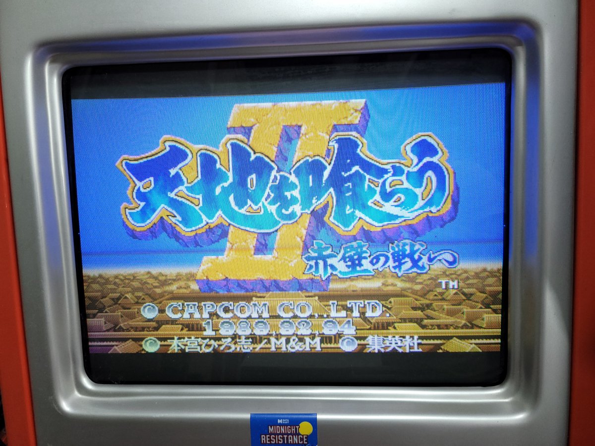

And...
You can see Blue colored Logo of Tenchi wo kaoru2.
