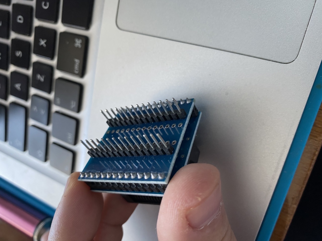

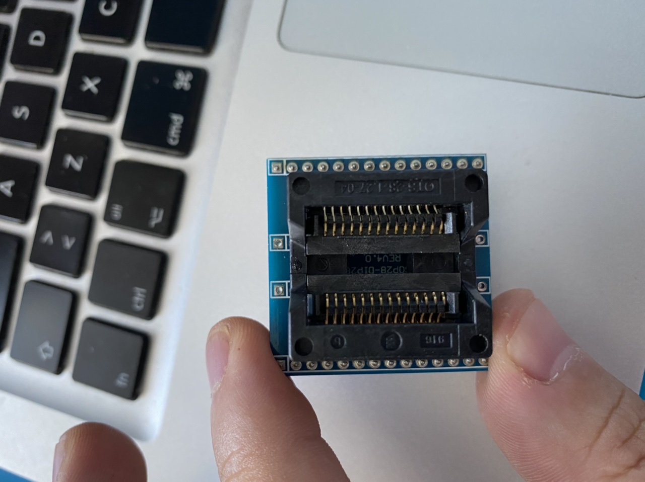

Apocaypse one is more useful because can handle to 32 pins , but what comes from China belong other this kind adapters as present with my Top3000 , looks like the same in the aliexpress link ^^ . Hope i will need it to use it sometimes
That one won't work for the RAM chips we're targetting, width is too small.
[EDIT]
Just checked and I also have this adapter, which is 300mil thus can't be used for the RAM chips discussed above.
It's probably the reason why I ended up building one of my own.
It's 450mil you need.
