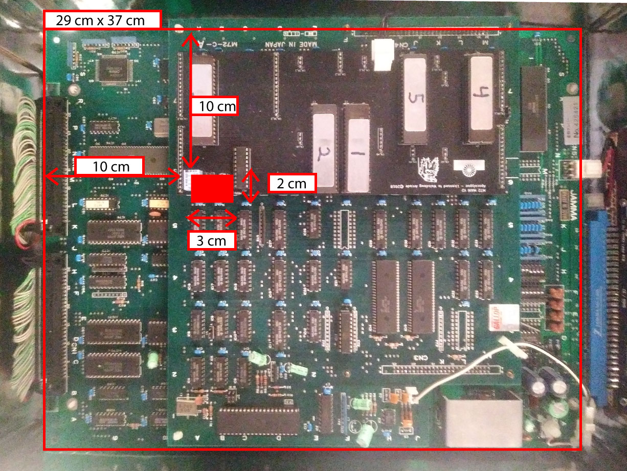

Guys, I got the measurements from tym01 for the multi V2.
For this version I should increase the space between the upper and lower plexi. Then I should drill a hole above, to access the dip switches.
I repeat, these are the measures for the multi V2
If the dip switch for the multi V1 is more or less in the same position, I can make a larger hole, but you have to give me the measurements.
For other versions, I would have to redo a further project with a minimum production of 10 pieces.
I can't make customized versions, unless you want to pay 170 euros instead of 100 euros.
So let me know. For now I prepare the project for V2, then I will make a new post with renderings

haha THANK YOU FOR HELP! I need to know if there are any differences, such as dimensions, compared to an M72.
Yes, exactly, there are magnets. They are quite solid, but I can leave the holes to put the screws. No problem.
https://ibb.co/bsGLjwp
Here is the mesasurements for my second revision multi.
Starting from bottom board without PCB feets total height without multi may be around 6cm high, with multi you could add 1,5 cm and it should be OK
Let me know if you need more infos.
Thanks!
