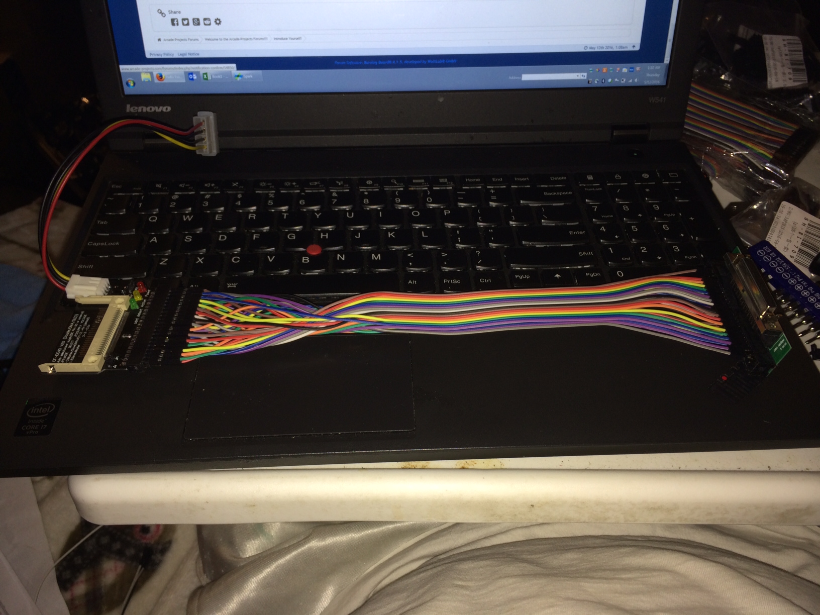

This has probably been documented on other forums. I have seen pictures, but no parts list or instructions. Lots of people in this hobby don't have proper soldering irons. This was created sans soldering iron and took about 15 minutes to put together. The total cost was $10.70 USD.

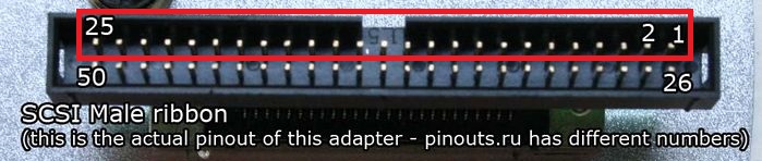

  3. On the SCSI adapter, work on the top row of the adapter first starting from pin 1 (the notch/keyed side), connect a jumper wire to the pin if it is used. If not, skip over it. Do not skip any wires. Connect them in sequence. Just skip over pins if they are not used. Make sure to connect the jumper wires in sequence, one after the other. Otherwise, you will have to rewire it. I made that mistake a few times.
  4. Notice, while there are 25 pins in this row, only 18 of those pins will be connected.
  6. You are now done with the top row (pins 1-25).

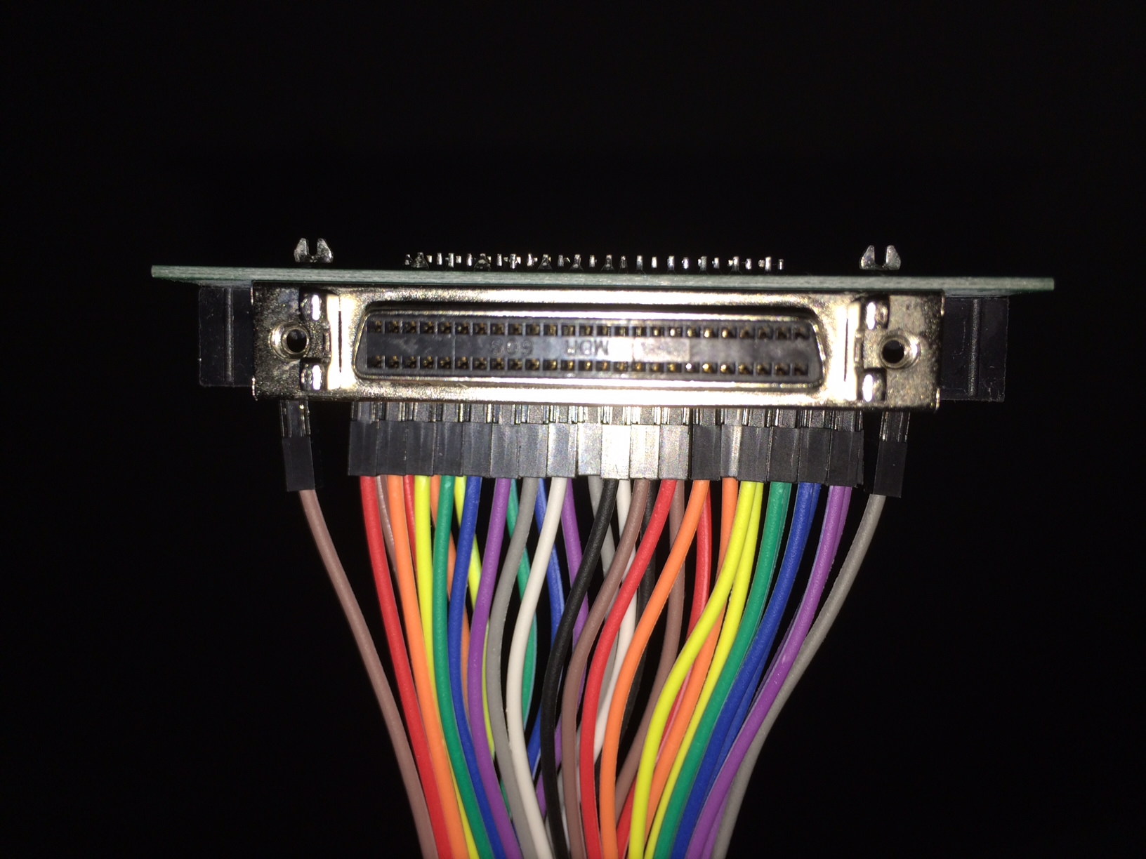

  9. You'll end up with something like this:
  10. Front SCSI
  12. Back SCSI
  14. Notice that the jumper wires are fanned out smoothly. There are no criss-crossed jumper wires. The jumper wires are connected to the SCSI pins in sequence.

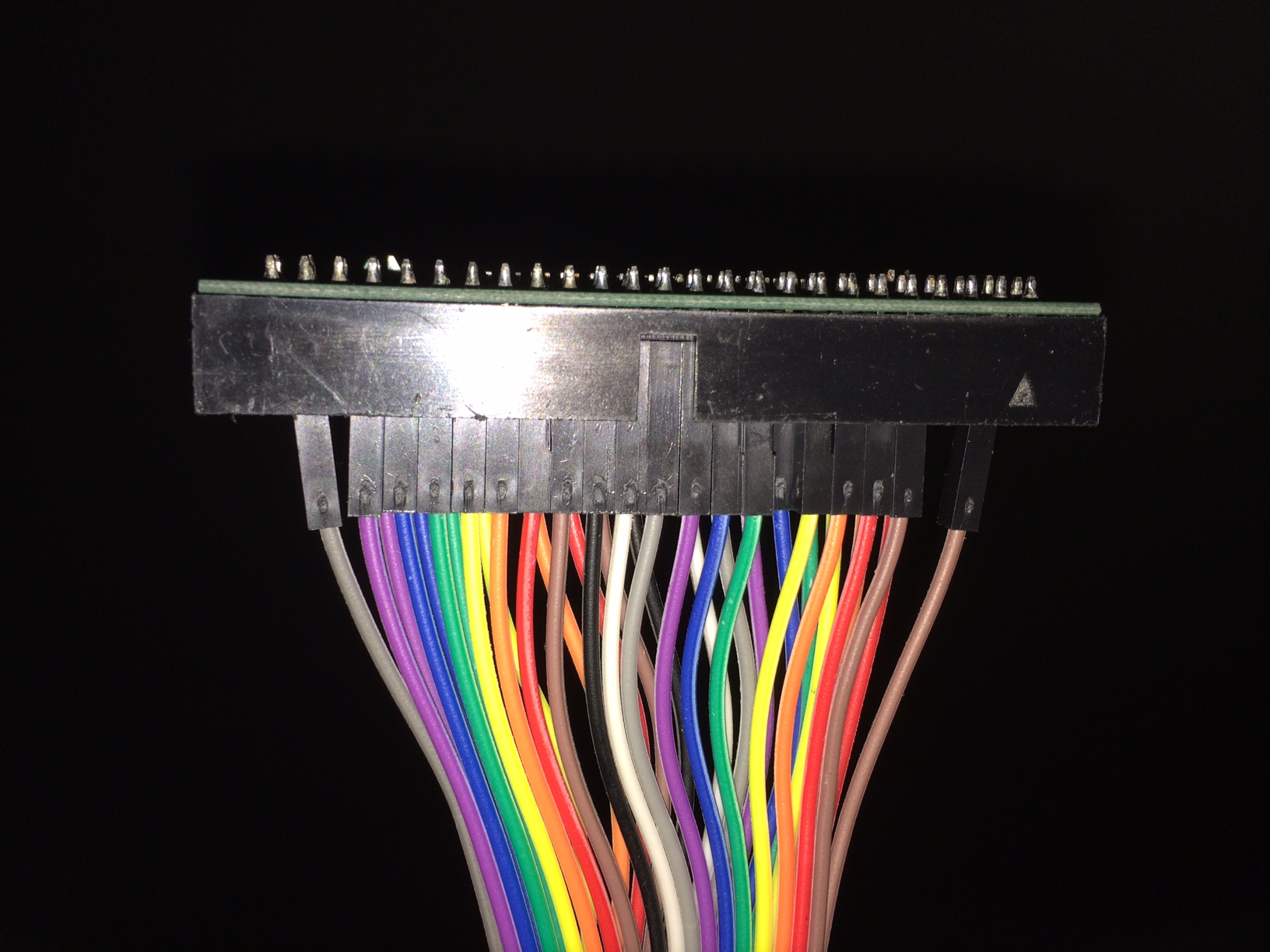

  15. Now for the connection to the IDE CF Adapter which will look like this when done:
  17. You'll notice on this side things do not look as smooth as on the SCSI side. This is due to the sequence of the pin connections and the fact that the odd/even numbered IDE pins are on alternate rows. No point making this side look pretty, it just isn't possible. Maybe if you are a stickler, add shrink tubing over it to make it look cleaner.

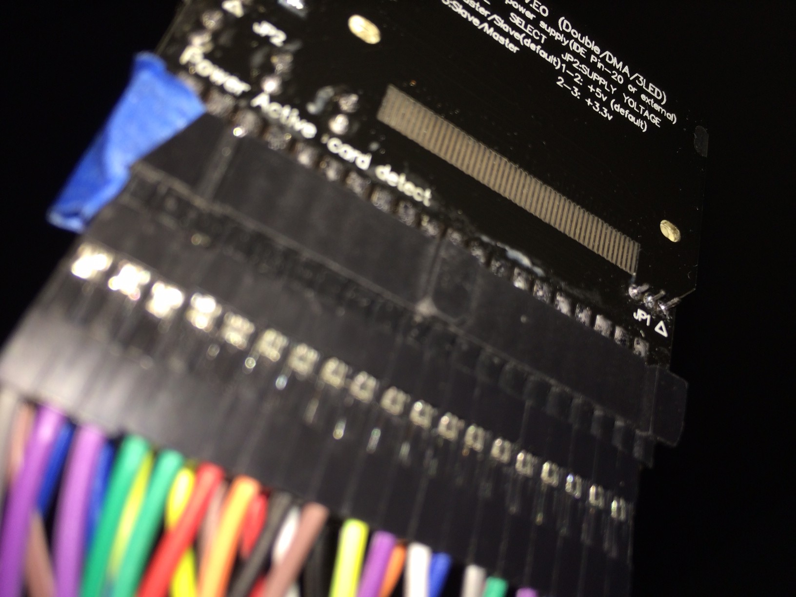

  18. TIP, add a marker on the side of the IDE pins where pins 1 & 2 are located (I used a piece of blue painter's tape). This way as you are flipping the card over to connect the jumper wires to the pins, you have a reference point to count the pins off from.

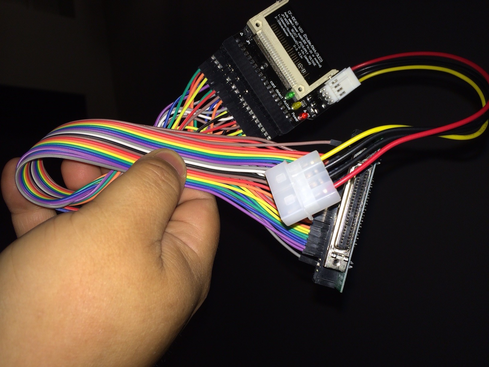

  21. You'll end up with this:
    Here is another shot of it:
  24. Now connect your IDE power adapter to the IDE CF adapter and give this thing a whirl. If all is well, then secure the jumper wire connections with hot glue or electrical tape or however else you want to do it.

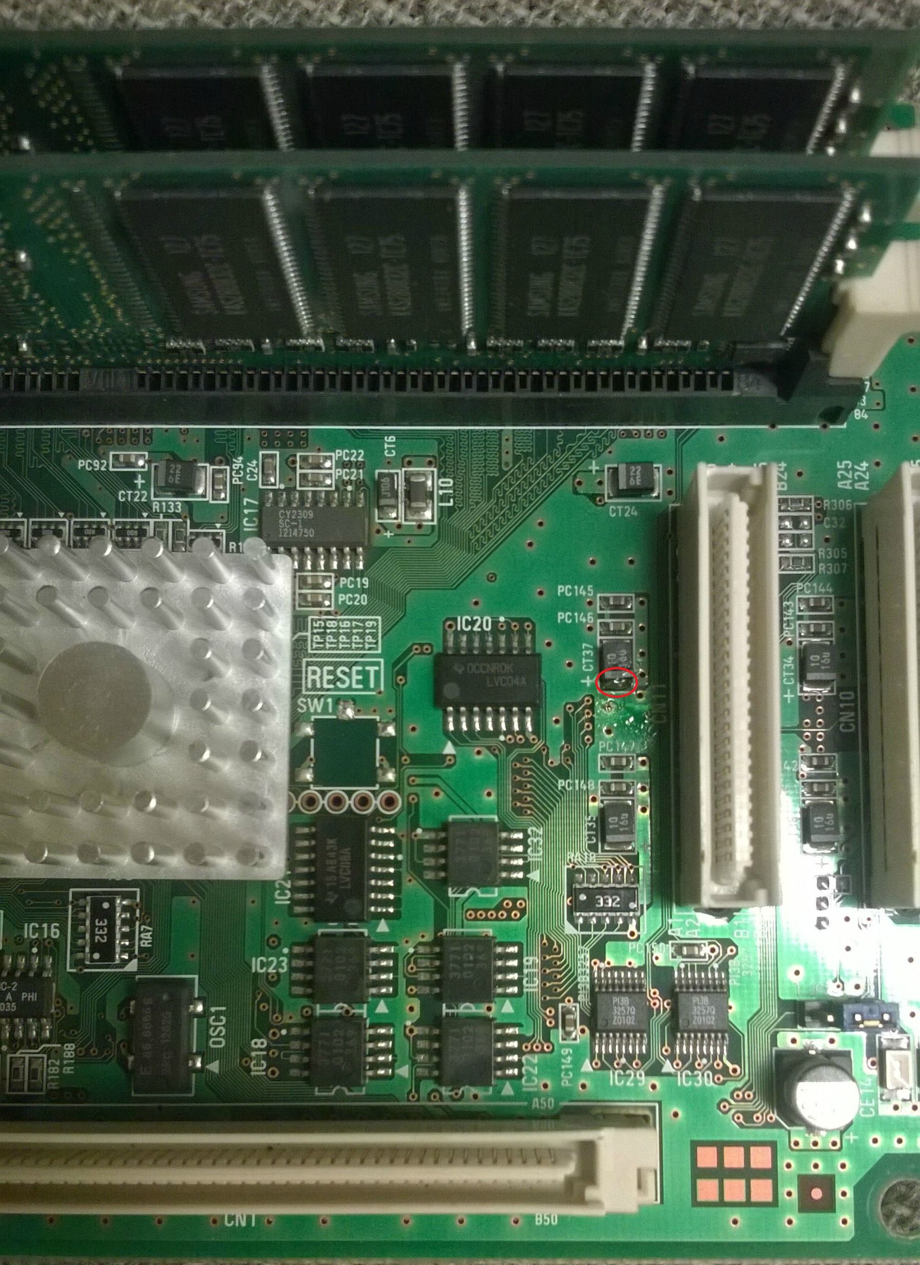

Firstly, on the Dimm, he desoldered the SCSI external connector. Here is what the pinout on the Dimm board looks like. From there, he wired the Dimm's SCSI pinout either directly to the IDE CF adapter's pins, or he desoldered the IDE CF adapter's connector, then wired it to the IDE pinout board using the mapping posted above (or from Otaku). I am sure he used super thin wire gauge for this, then tacked it down with some hot glue.
As for powering the IDE CF adapter, he gave me a photo showing where he harnessed 5vdc off the Dimm board to power the IDE CF adapter.
