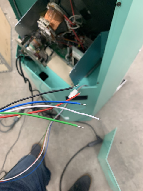

I have 5 wires coming from the "Arcade Cabinet" kit. RGBs and Video ground..
If I were to just wire the signals through hole instead of soldering the VGA hat, Would these be the appropriate holes for my "arcade cabinet" wires?
