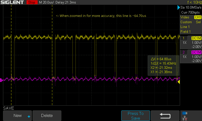

I've been annoyed long enough at the Taito F3's sync. Today, I spent a great majority of my time prodding at the Taito F3's video output with a oscilloscope. I wanted to share what I learned and see what y'all think about how we should recommend folks handle their sync issues.
Oscilloscope: Siglent SDS 1202X-E Oscilloscope
ROM Cartridge: Puzzle Bobble 3 (AMERICA)
Motherboard: MOTHER PCB (EUORPE - REGION MOD)
Screen Sampled: Monitor Colour Test Screen

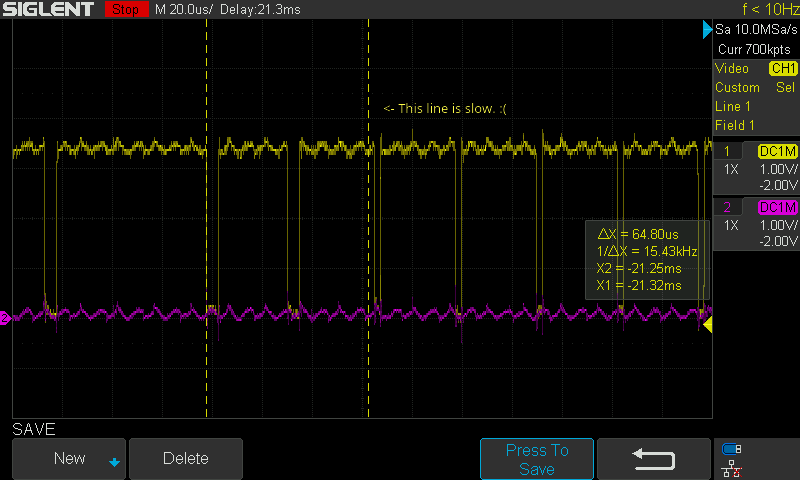

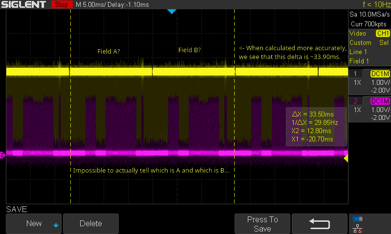

From my measurements, it does not work very well. There appears to be no difference between Field A and B, and the line timing is off (and inconsistent at times). Here are the numbers.
Refresh Rate: 29.49Hz?
Time Per-Frame: 33.90ms
Time Per-Line: 64.70us (±2.40us)
Field A&B

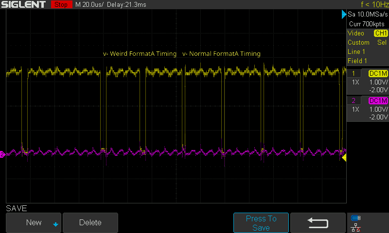

For V-Sync, we see that we have 3 FormatA fields (the first syncing line is slow by HSYNC/2), 1 FormatD field, 2 FormatB fields, 1 FormatC field, and 3 FormatA fields. We then have 252 scanlines of either content or blanking (the first blanking line is fast by HSYNC/2). It's worth mentioning that the FormatB fields have bad timing - their high pulse is still HSYNC/2 instead of HSYNC, this just makes the signal even messier. I'm not actually sure how monitors handle something like this - it seems pretty off, and not by a small amount...
I compared this to the Nintendo Wii (works on my component input) - the HSYNC timings matched between the two, but the Wii's line timings were more in-spec and as-expected (exactly 63.55us). The different V-Syncs per-fields were present, so we could tell A apart from B, and the timing on the FormatB high pulses was correct as well (HSYNC, instead of what F3 does, which is HSYNC/2).

A Whole Frame:
Some Field Debugging:
