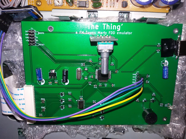

Some years I made some work on the Fujitsu FM Towns Marty, a home video game console released in 1993 by Fujitsu, exclusively for the Japanese market.Specifically I found the way to use a FDD emulator (HxC or Gotek) with this console, you can read my past article here :
Using the HxC Floppy Emulator with a Fujitsu FM Towns Marty

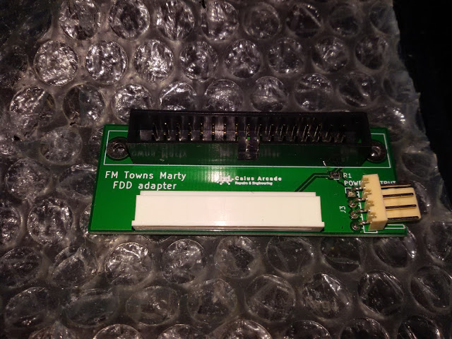

At same time I also designed a simple adapter to connect an HxC floppy emulator (or a real 3-MODE floppy drive) to the FM Towns Marty :
The adapter was really popular among enthusiasts (to the point that someone cloned it...) but it was not an immediate all-in-one solution.So, recently, I decided to design my own FDD emulator for the Marty console.I called it 'The Thing':

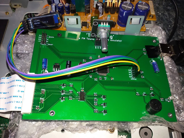

The emulator is based on the Gotek design and powered by the excellent FlashFloppy firmware so fully customizable and configurable (the settings can be specified in a configuration file called placed in the root folder or the USB drive).
Testing of the first prototype was successful, the emulator properly loads and format disk images :
View: https://youtu.be/O6JO2kBkhPI
View: https://youtu.be/g3OlmxAh3XI
Stay tuned for further update.

If we already have an HxC Floppy emulator setup, what would be the benefit of switching to this?
The only HxC floppy emulator is not enough for the Marty since you need also to adapt the floppy FFC cable of the Marty to the HxC connector.I made this adapter for first and sold many of them, it was so popular that some poor man ripped off my design (after he bought from me an adapter), now he sells this clone.
My 'The Thing" Marty FDD emulator is an all-in-one solution, just plug and play.I hope it's clear now :)
