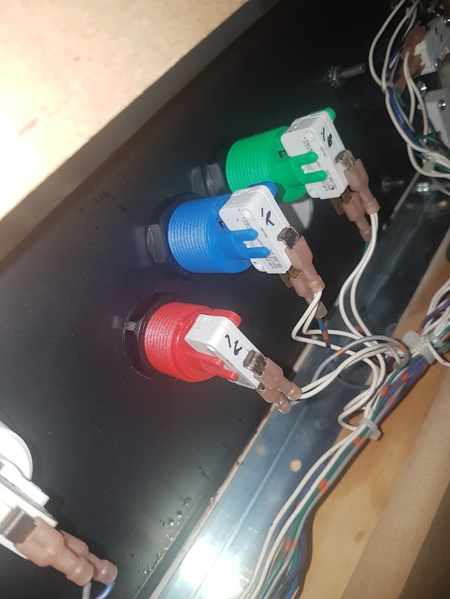

Hey, so I ordered the Gundam Vs Zeon game for the Naomi and it is pretty sweet. Except that my system is a 3 button setup for Virtua Striker. So instead of just adding one button I might as well make it a 6 button setup.
I have to find some buttons/wires and a Kick harness.
From what I've found online I need a JST-NH 14 pin kick harness.... and I'm not finding that online.
Is there another option for doing this? Or am I better off just soldering the wires directly to the pins?

I just use some female jumper cables, it's not pretty but it's removable.

BTW what guage of wire is used? 14 or 16? All i have is 22 from my network gear
Just an update.
I soldered on buttons 4 + 5 on the Jamma strip and added button 6 by soldering on a jumper connector
Not the prettiest but all the I/O tested out
