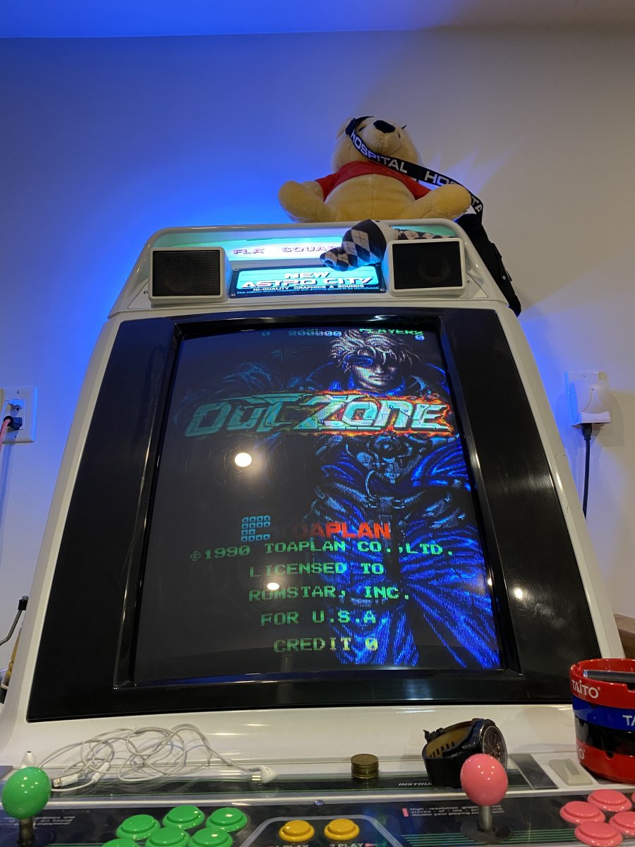

I got this outzone that doesn’t coin up. But if I jump the coin switch on the Jamma connector it coins up. It’s not the NAC , because all my other games coin up and pressing the service button on my power supply coins it up.
also in test mode, it shows the coin 1 switch is always on.
Where do I start looking? It’s got to be one of those resistors or arrays near the Jamma edge
thanks!
