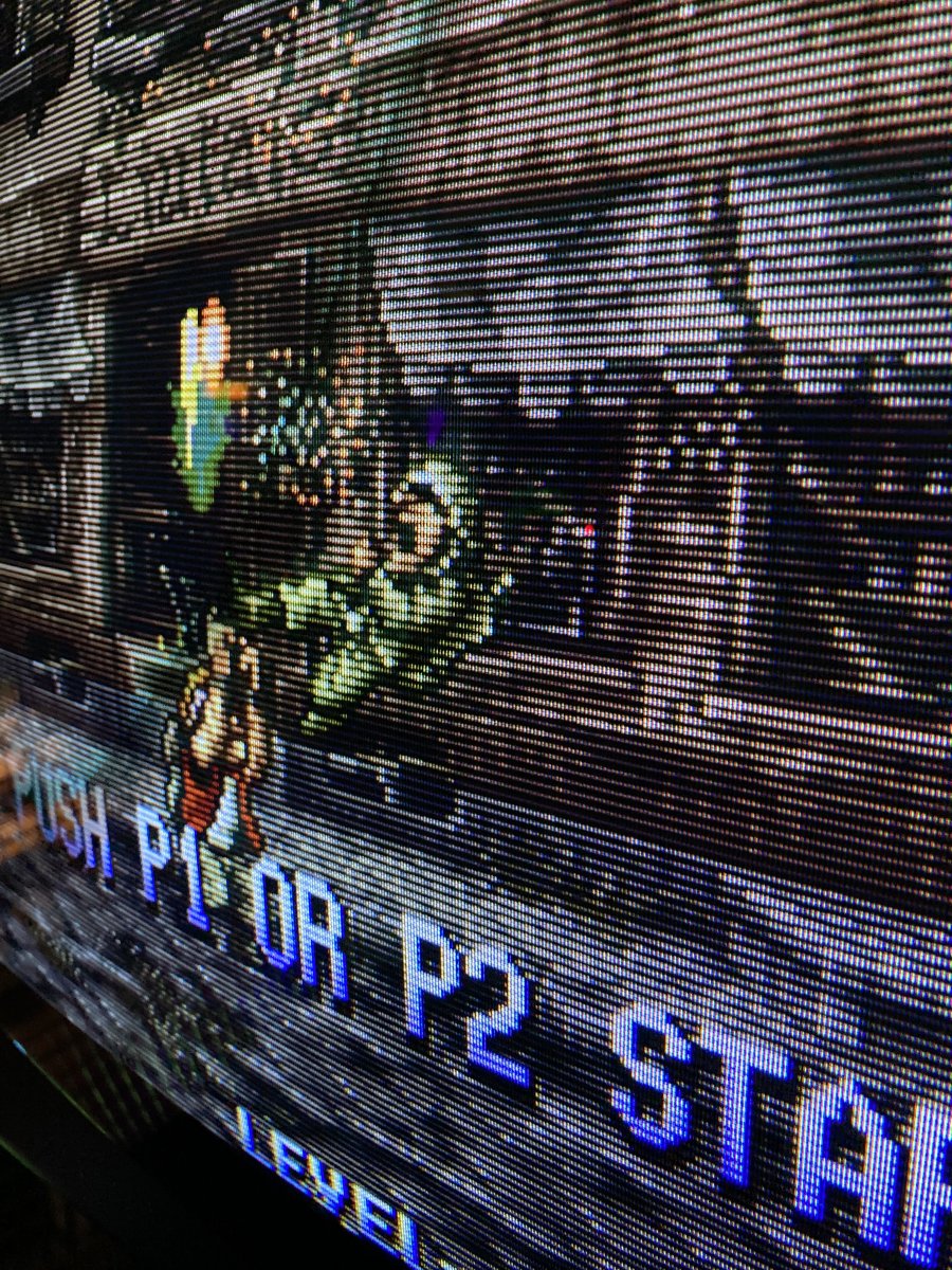

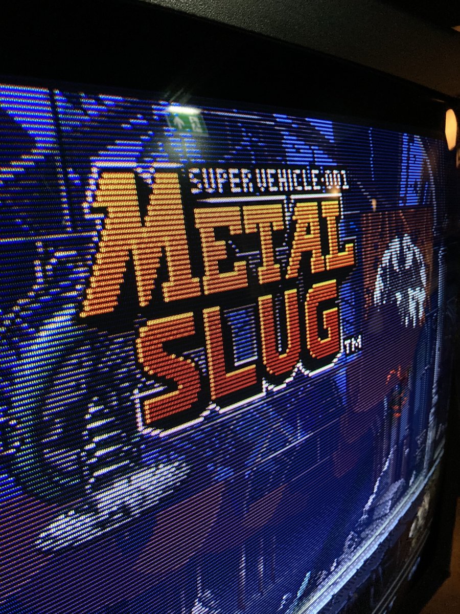

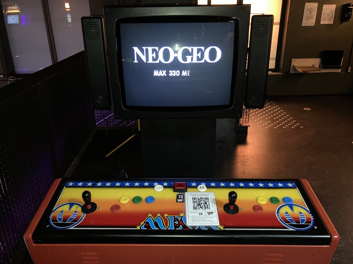

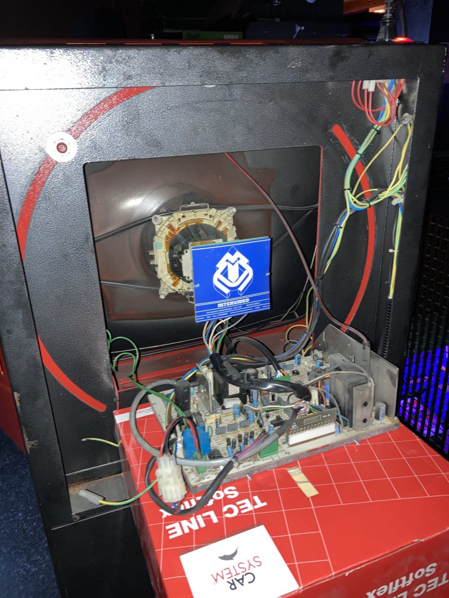

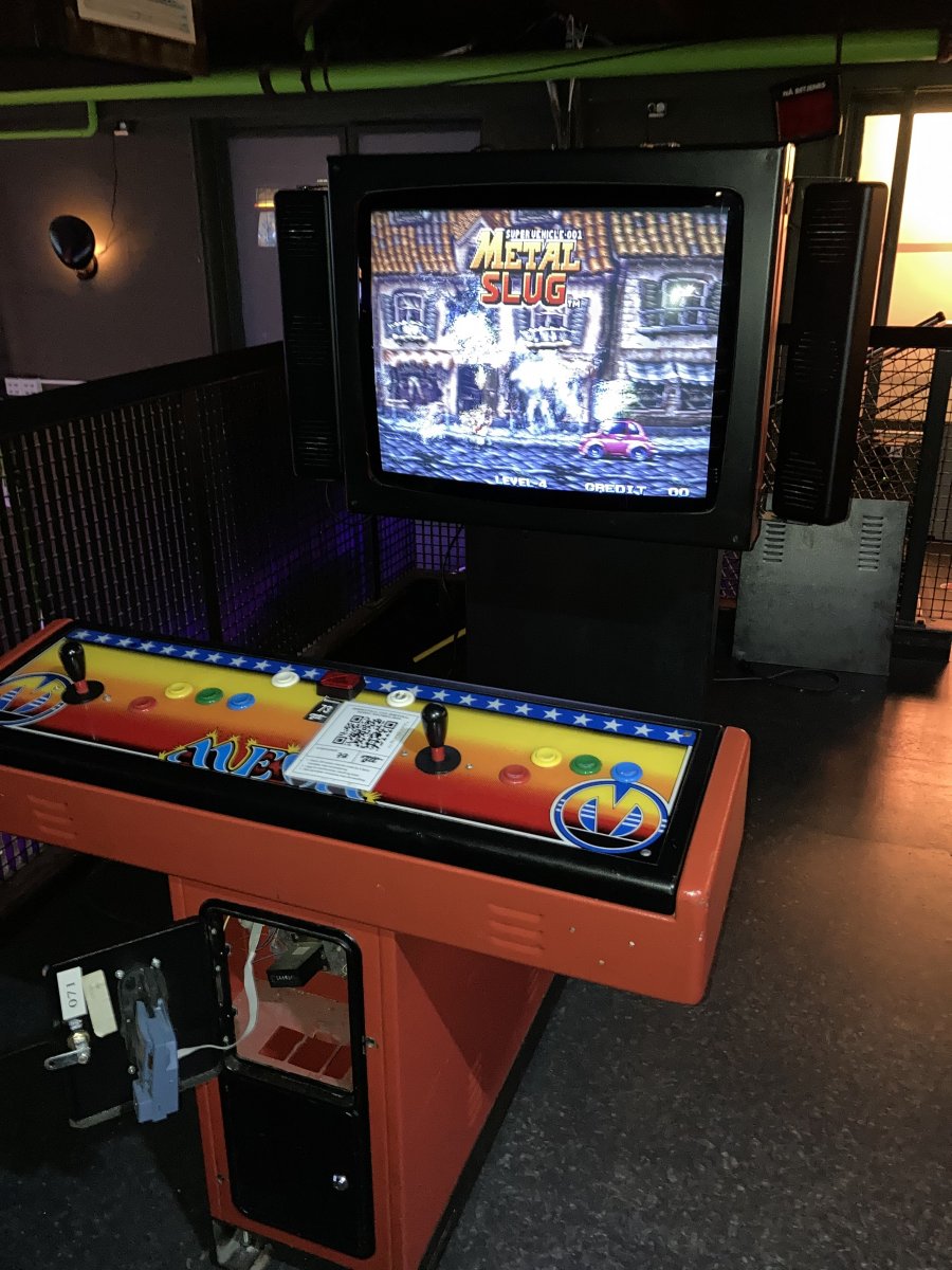

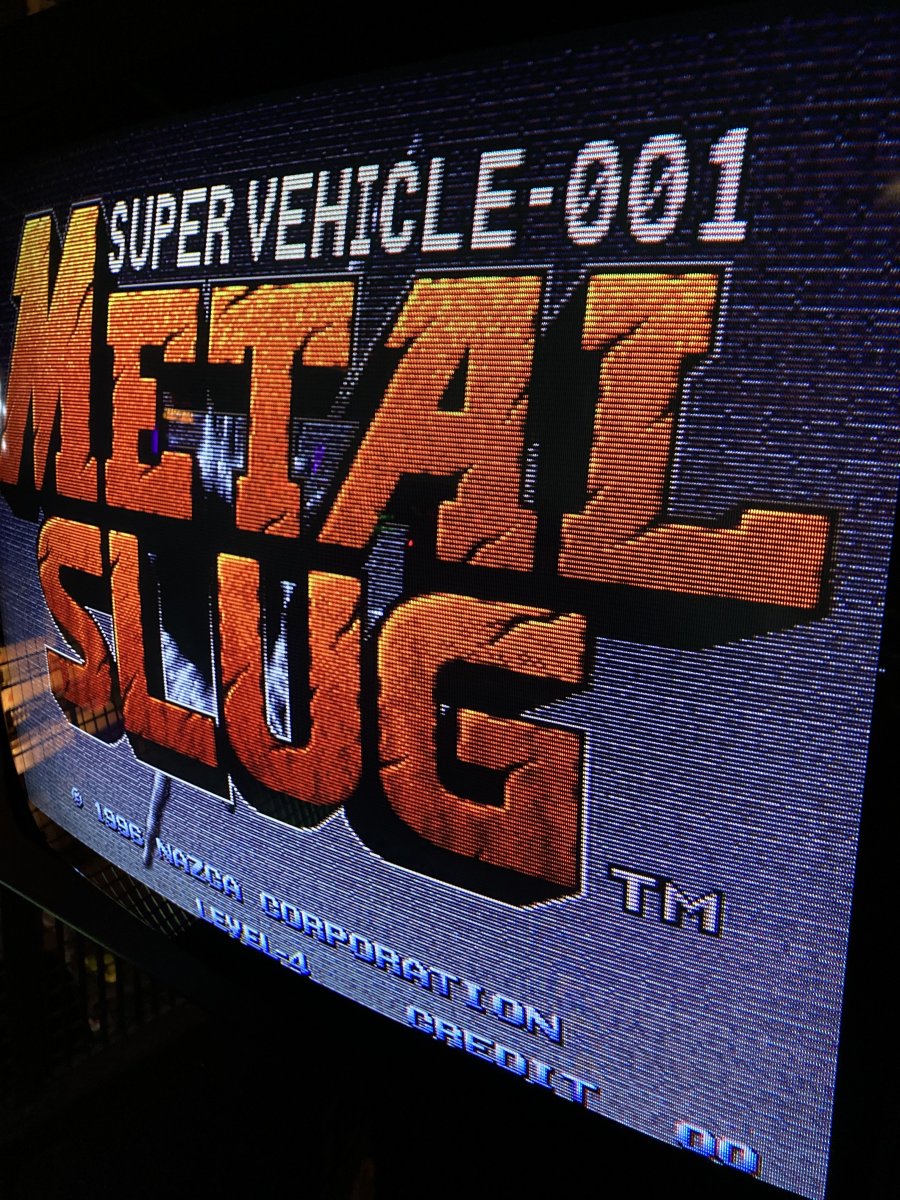

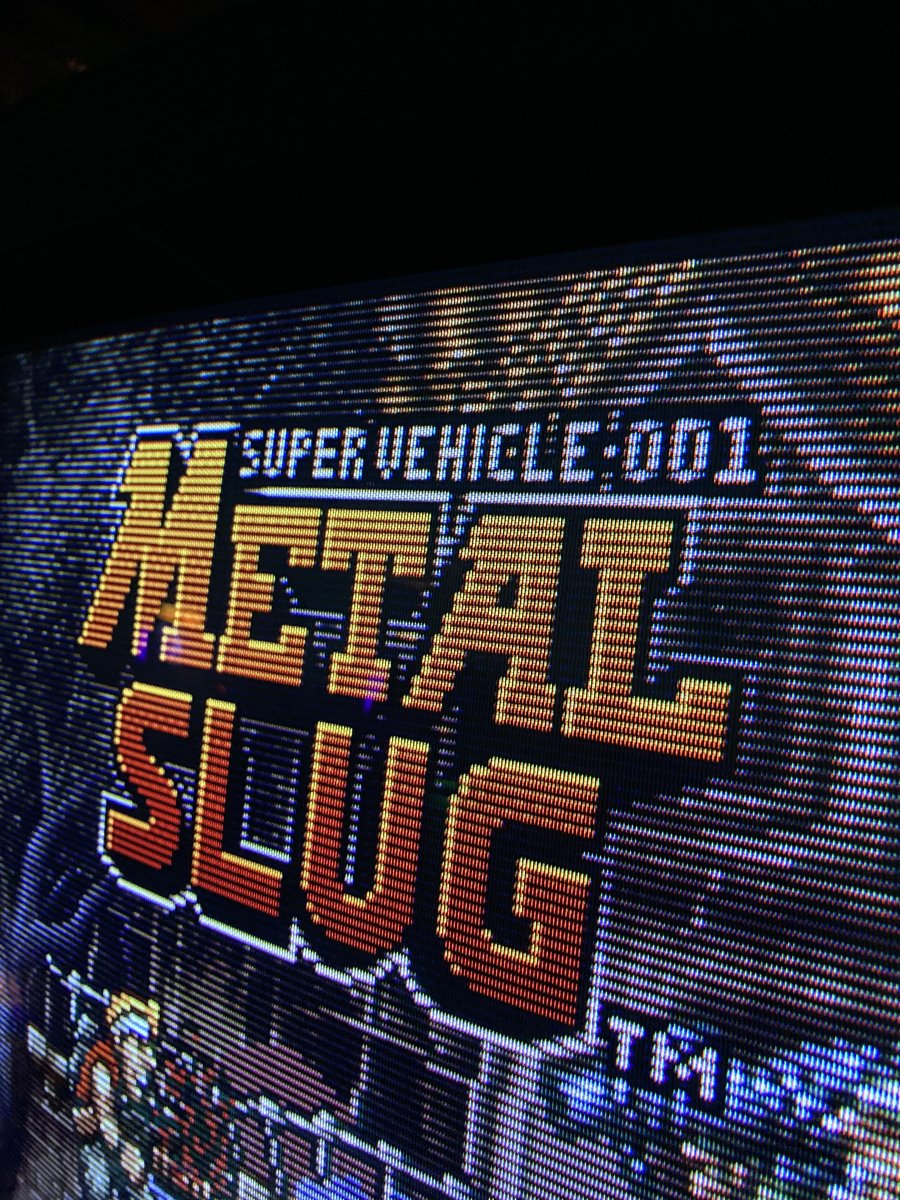

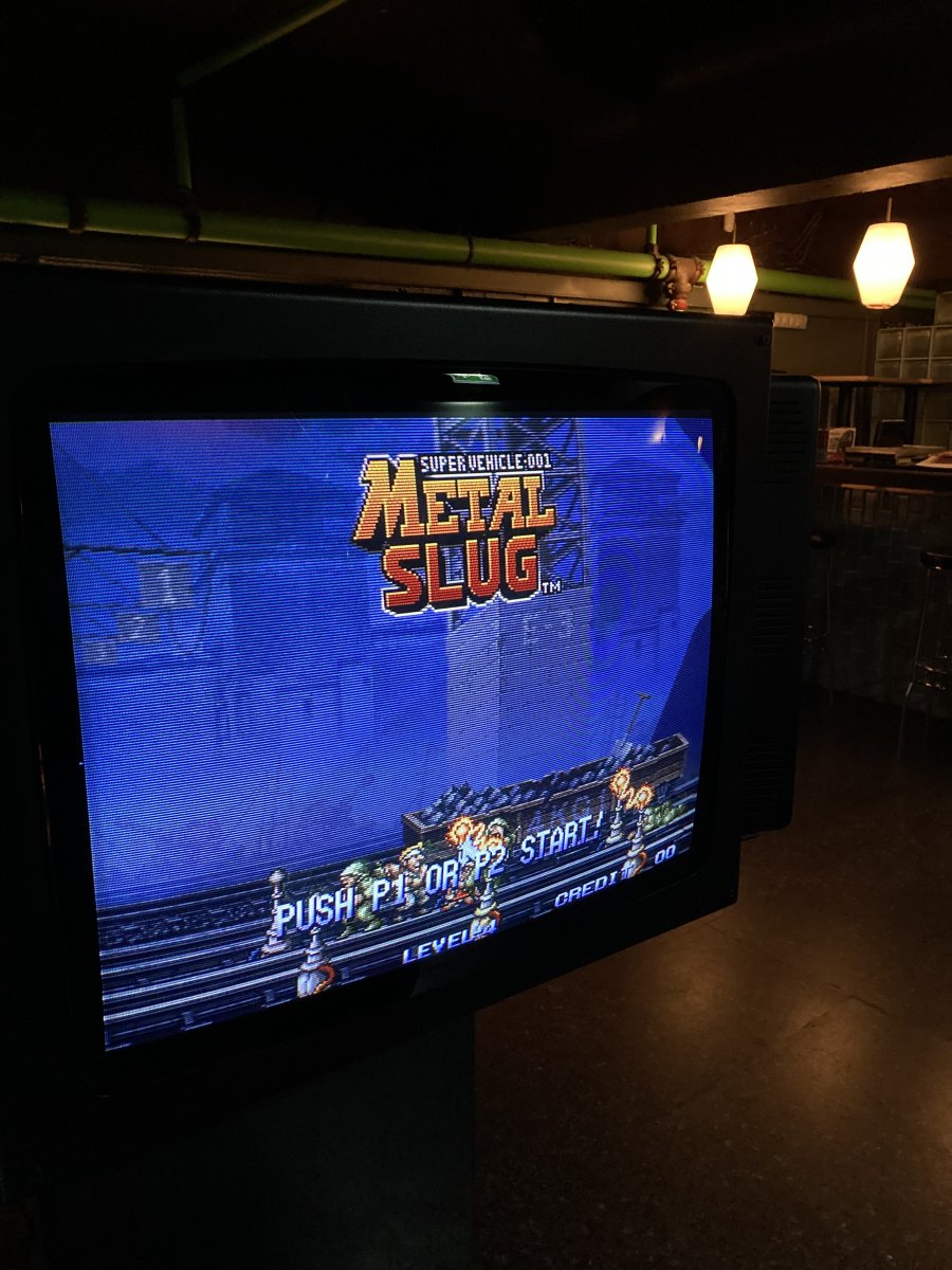

Started to work on this beast of a Neo Geo sitdown cab. Has a very nice 33” CRT with a intervideo chassis. Just needed some flyback adjustments and general geometry adjustments. Color was good and everything worked, So a easy start.
Picture looks nice! Baconstrip scan-lines!
First time playing with a Intervideo chassis. Pretty easy to use.

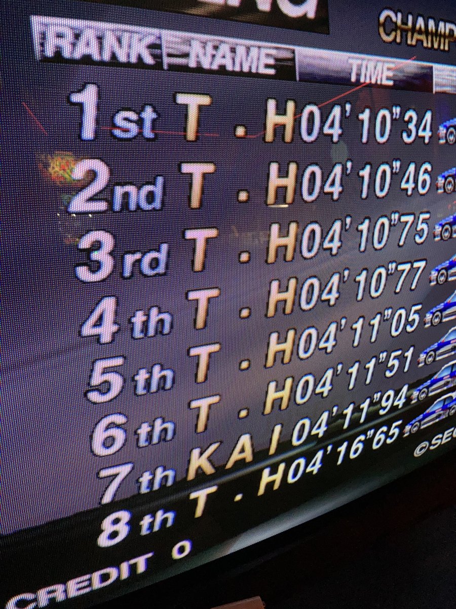

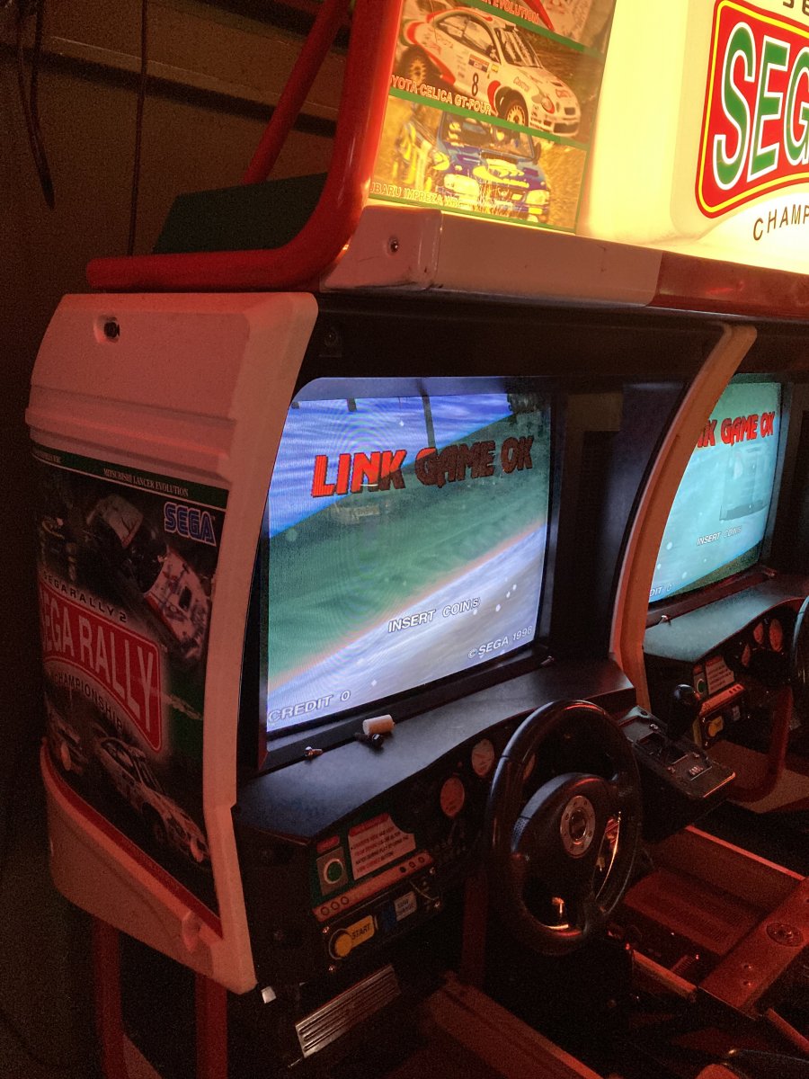

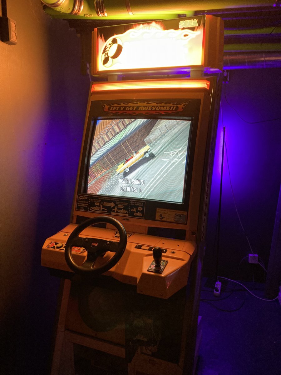

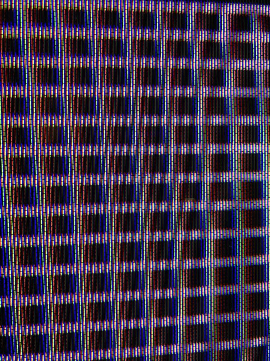

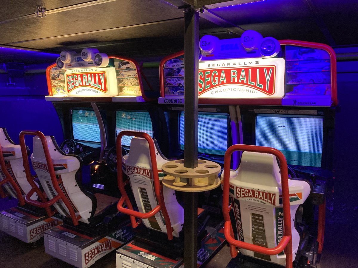

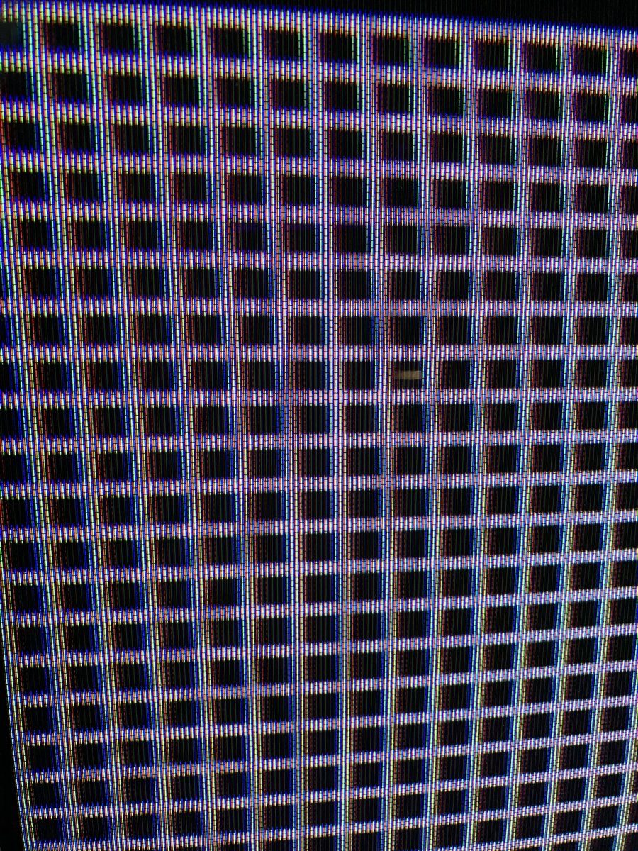

Sega rally 2 took a lot longer..... Main goal was to get all 4 screens looking as identical as possible... sucked, but result was quite good. Had to adjust convergence rings, add convergence strips, adjust flyback etc etc etc....
convergence rings were stuck, but a splash of isopropyl alcohol both cleaned and removed old crap that made them stick.

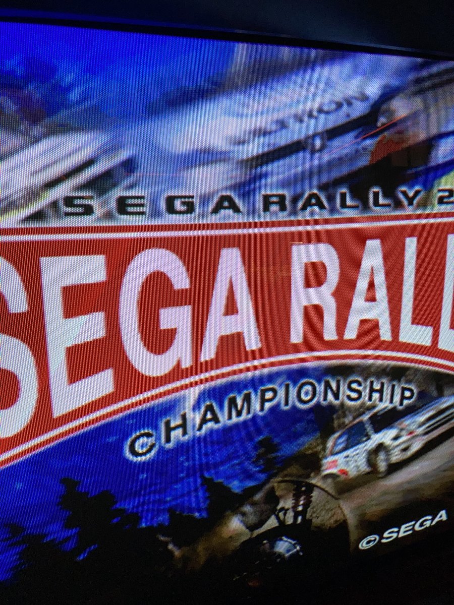

Grid before adjusting c-rings.... sucks...
After some c-ring love. Much better!

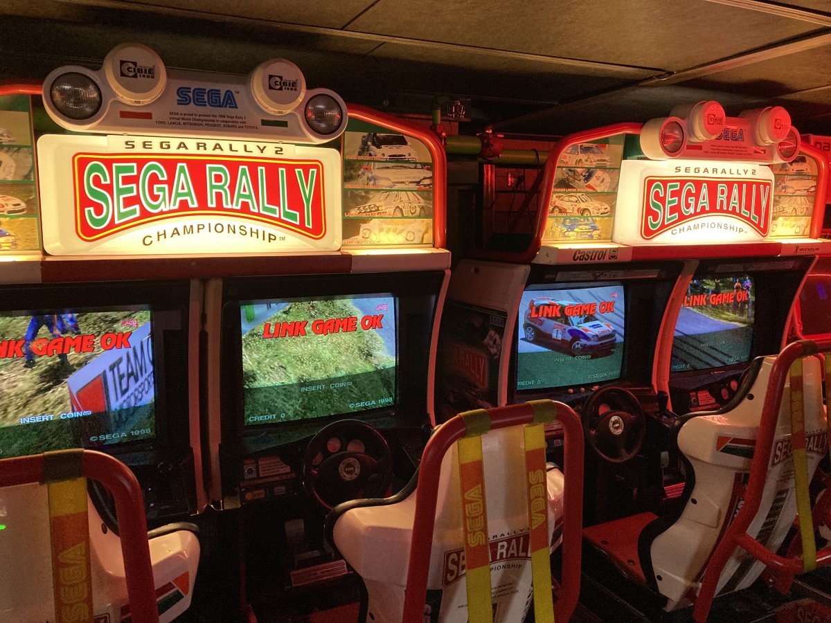

4 hours later, everything looked supernice! Forgot to take pictures of final results.....Edit! Added pictures 😁

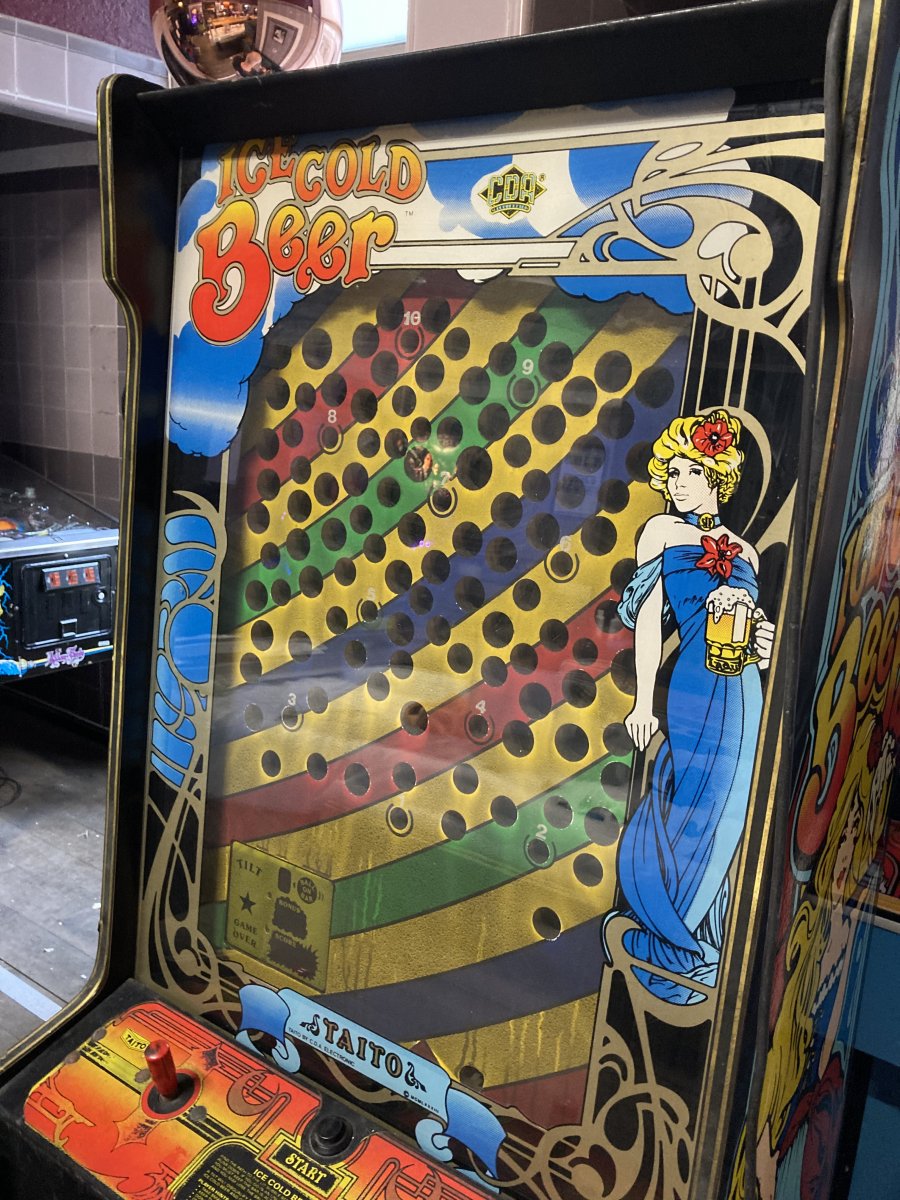

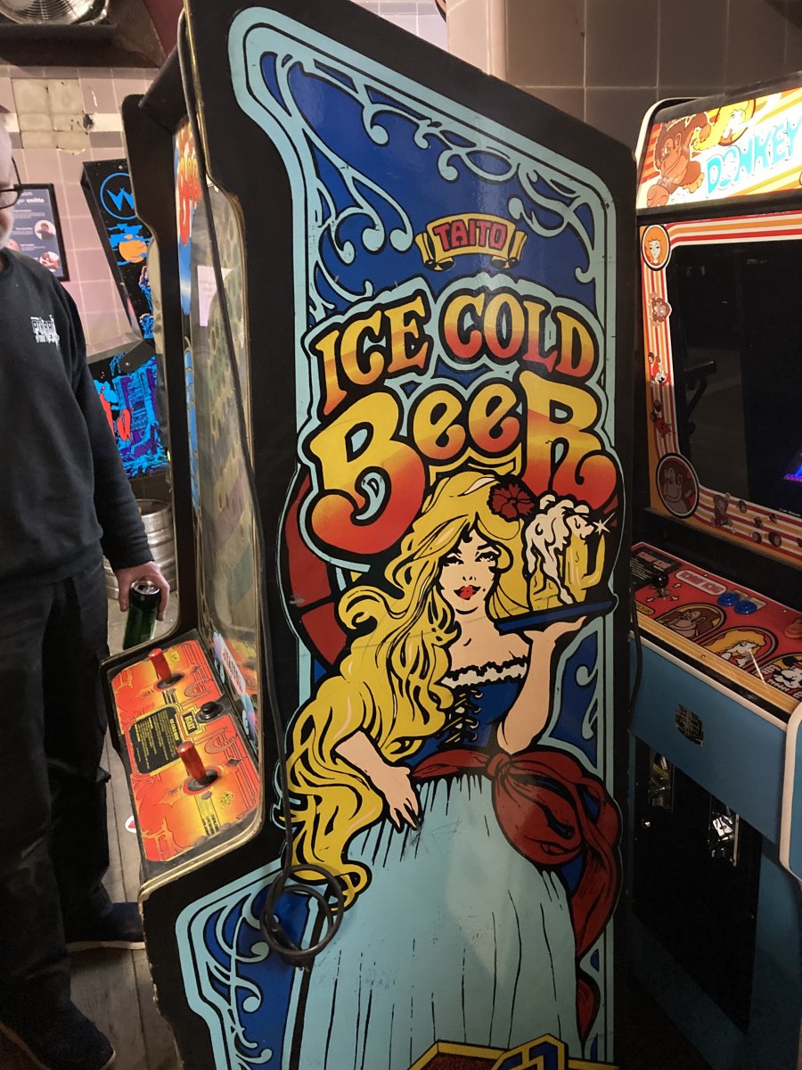

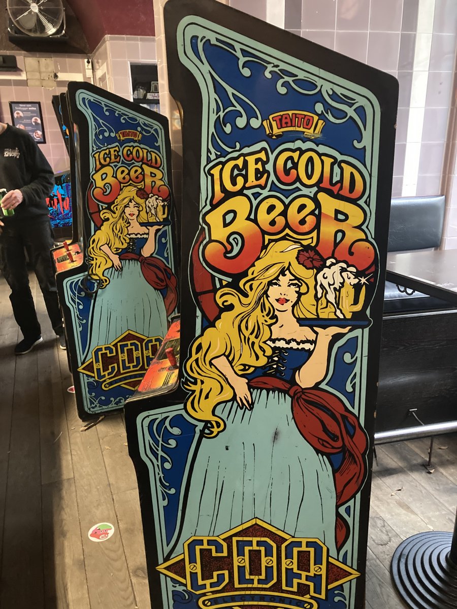

2 great looking cabs that was saved from a warehouse fire down in Italy.
Dirty as hell and no monitor to calibrate, but will be fun to make these work again! Ice Cold Beer fits quite nice in a bar....

Those Ice Cold Beer cabs are super interesting. I had never seen that playfield or side-art before. So much better than the plain yellow beer mug playfield. Glad you were able to save those gems, I am sure you will get them looking great.

I can’t take credit for saving them, but I will be fun to restore it back to former glory!

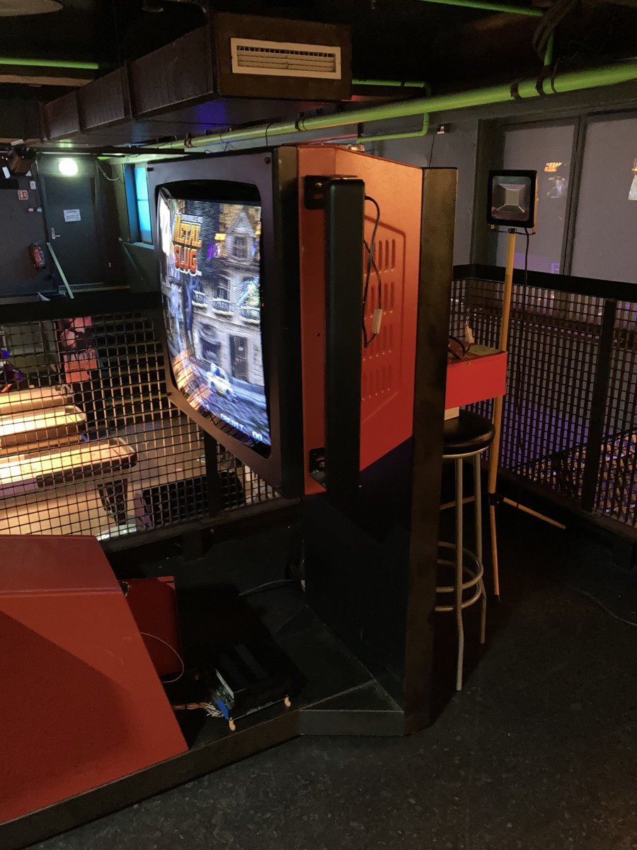

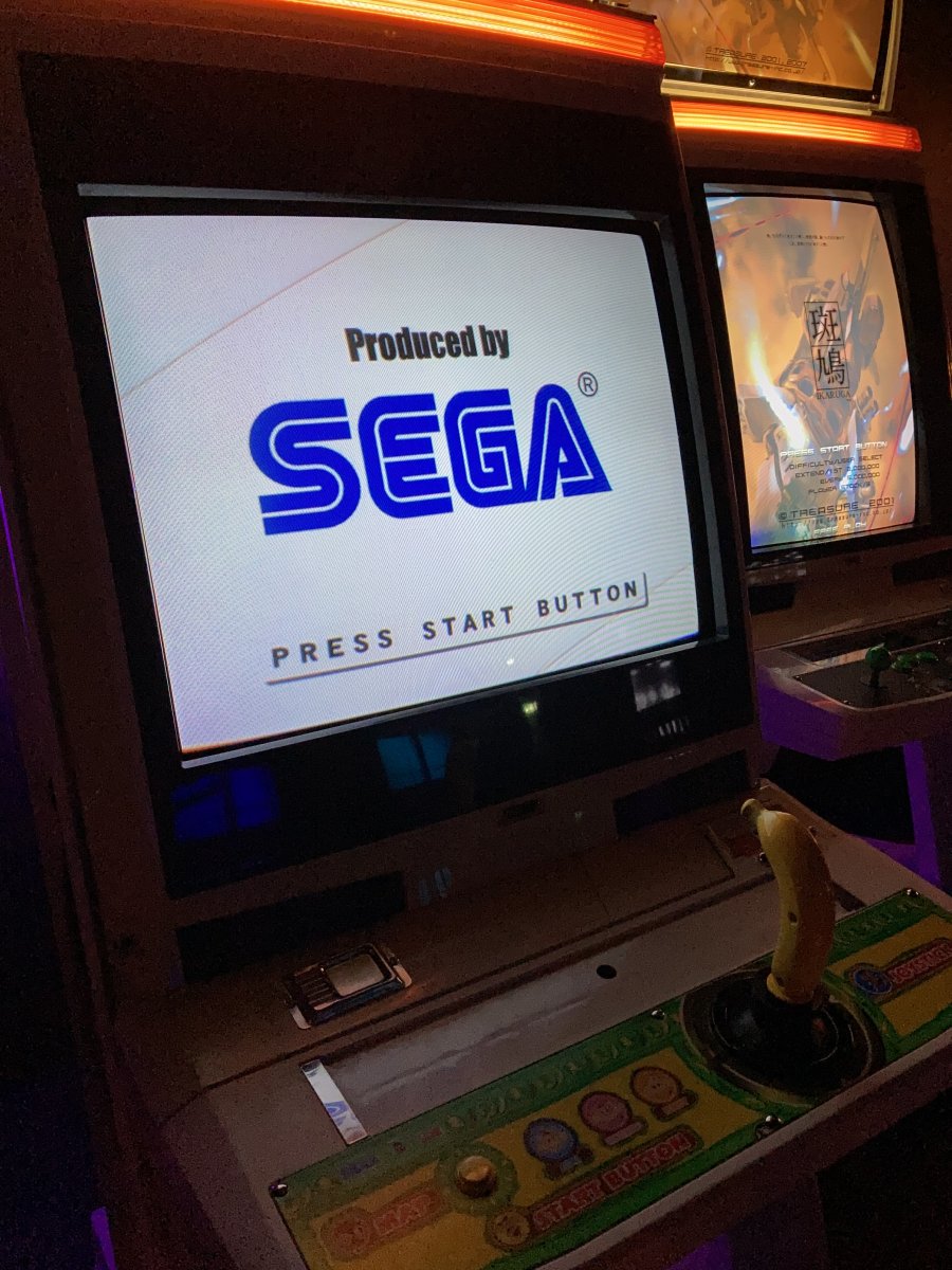

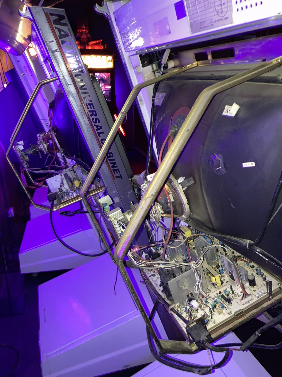

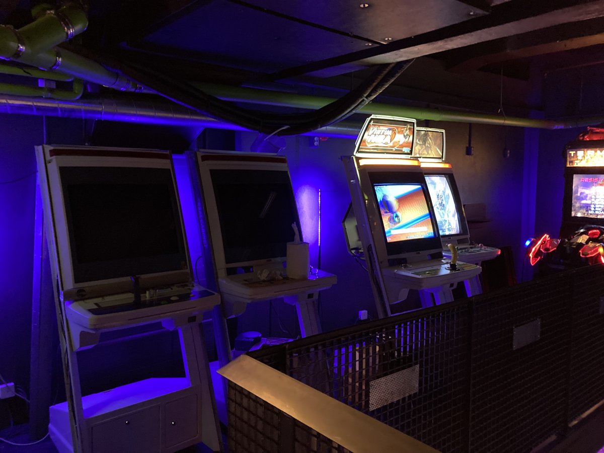

Next up... A epic row of Naomi Universals. Some games like Jambo Safari missing, but more will be added soon.
Monkey Ball

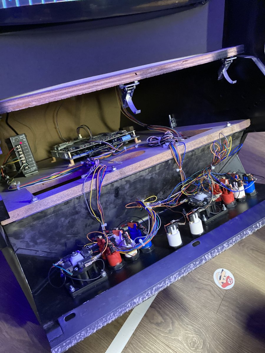

Had to completly rebuild the stick. Was nasty, but ended up working great..... for 5 minutes before one of the analog pots went to hell... Luckily we had a extra Sega pot lying around, so got it working with minimal effort and a little hacking.
Screen needs a recap, but everything else is working and looks ok. Will look fantastic after a full recap. To be continued.

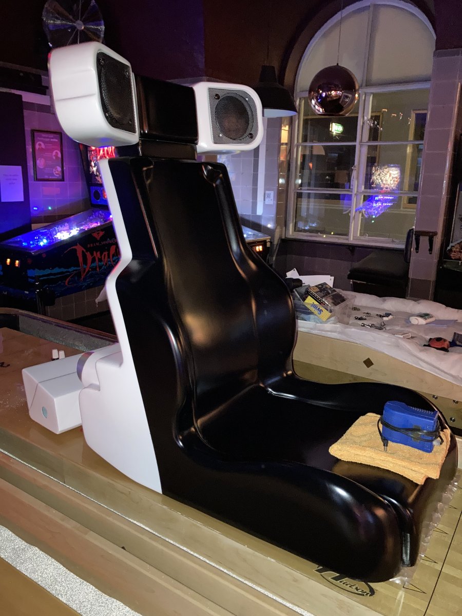

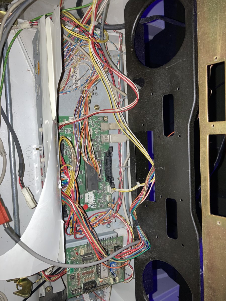

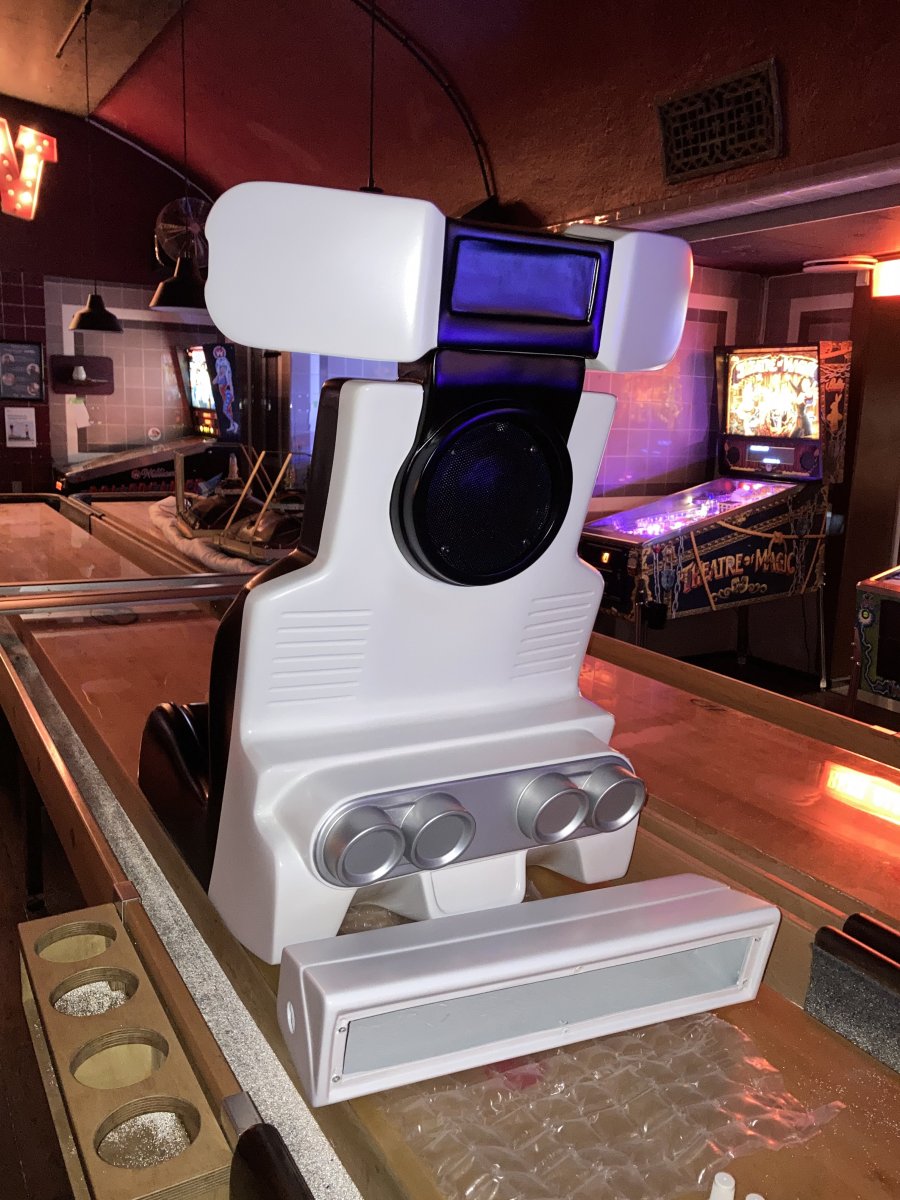

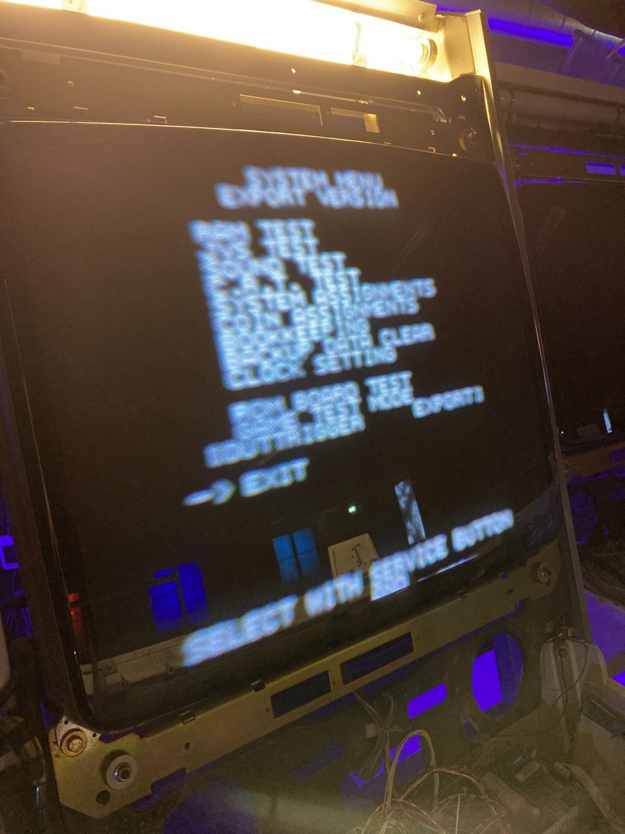

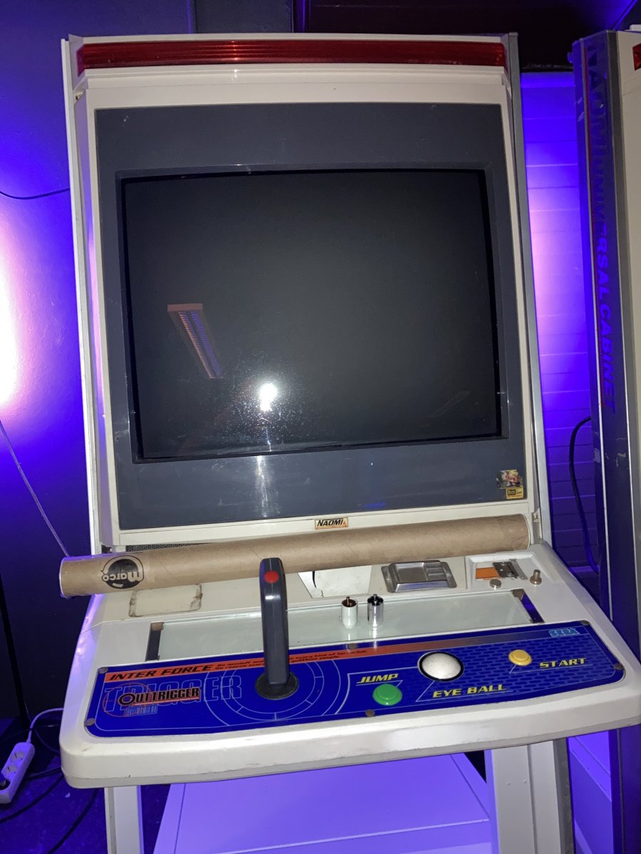

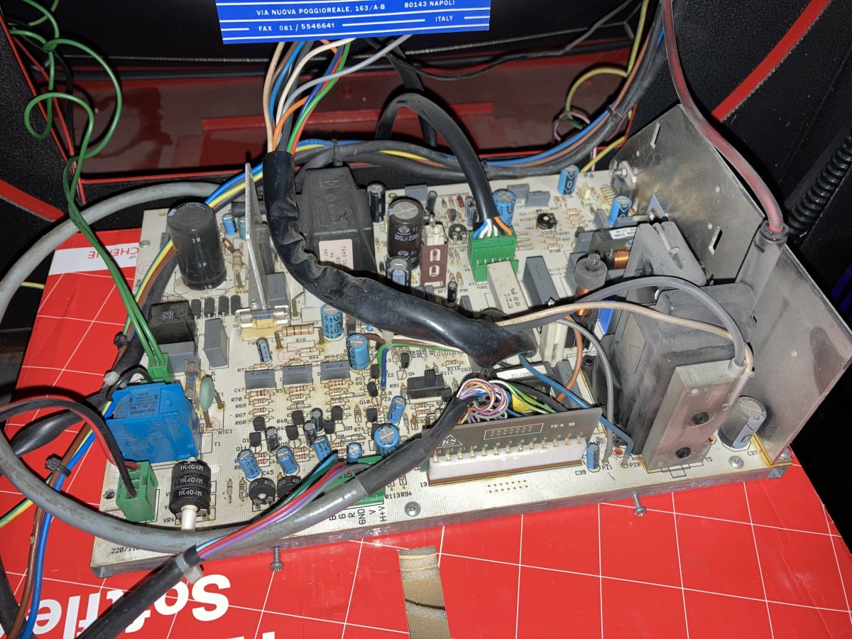

Outtrigger
This one needs a lot of love.... Had to add a working I/O and harness. Wiring was a complete cluster-fuck, but was just for testing purposes. Will make it nicer next time... Probably....
Everything booted ok even though the PSU fan made a pretty hardcore growling noise (Needs some Noctua love) and I was greeted with this classy image...
Not hot...

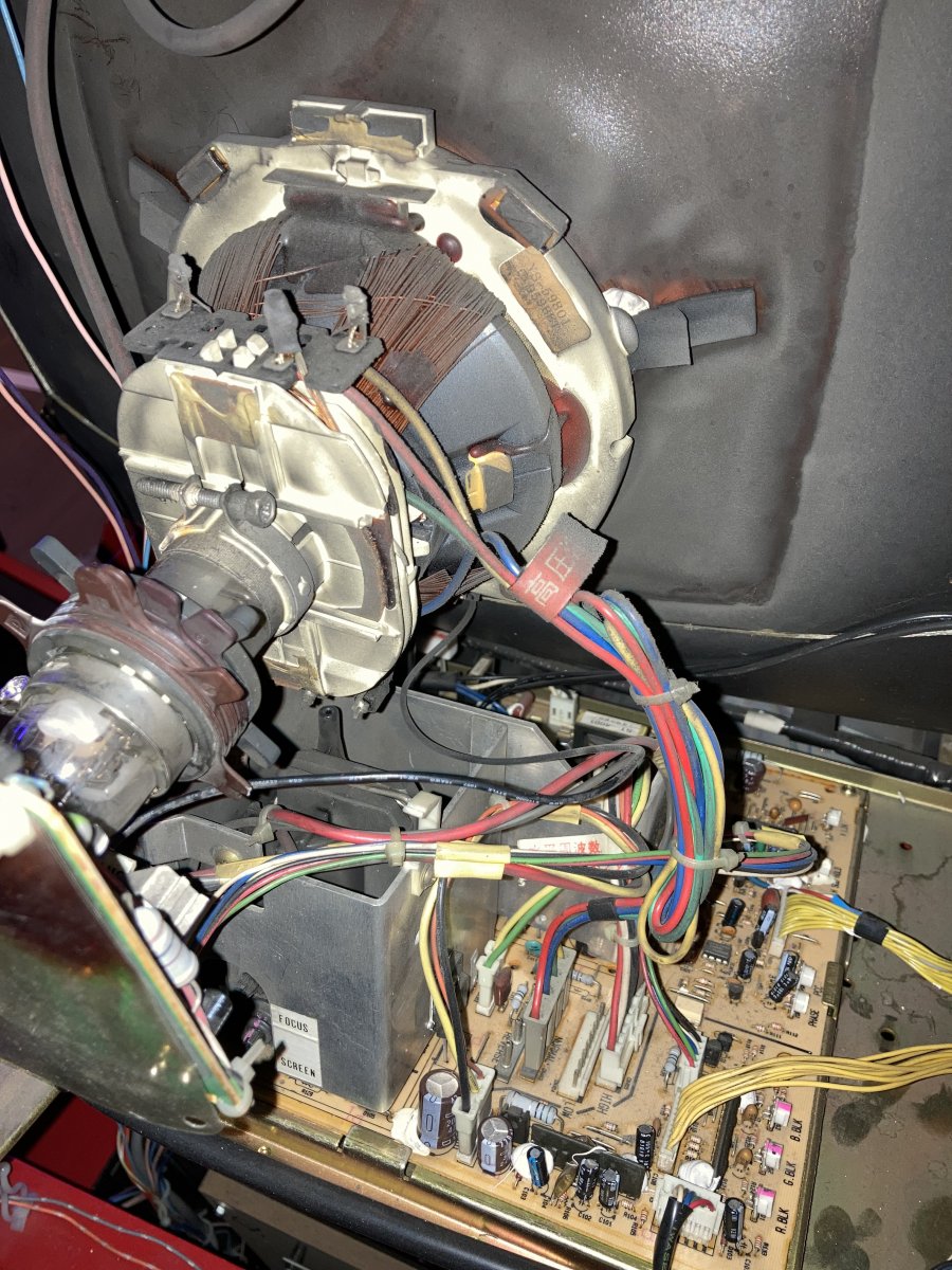

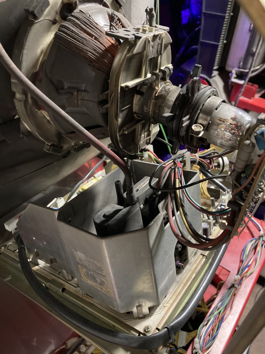

A look around the back confirmed my suspicion...
Shanghai Novel tube with Sanwa chassis.... crap de la creme...
Need a full recap and a new flyback since the one in there lost focus after under 1 hour.... Luckily the arcade tech there ordered some backup flybacks a while ago, so this will be fixed.
To be continued....

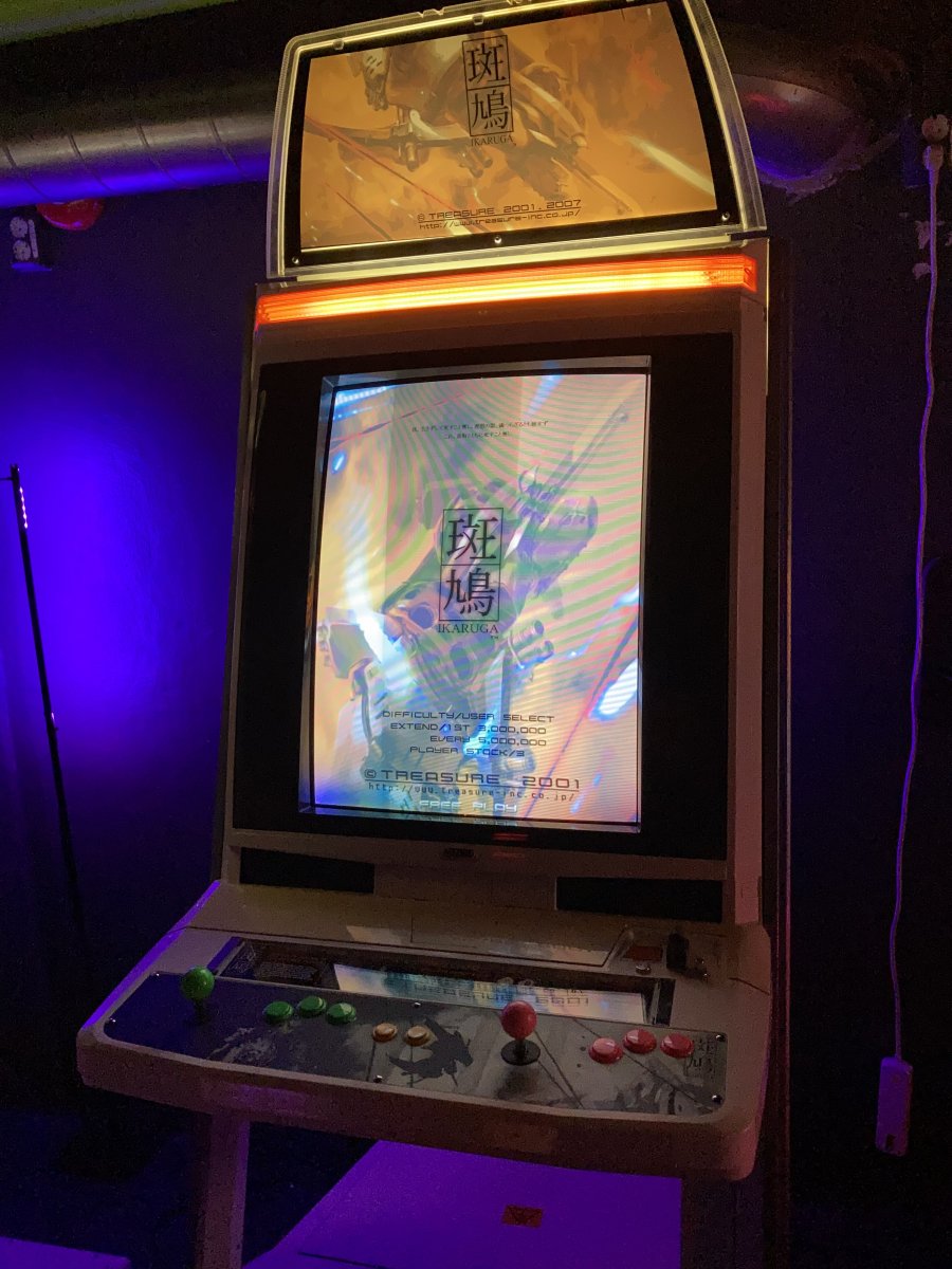

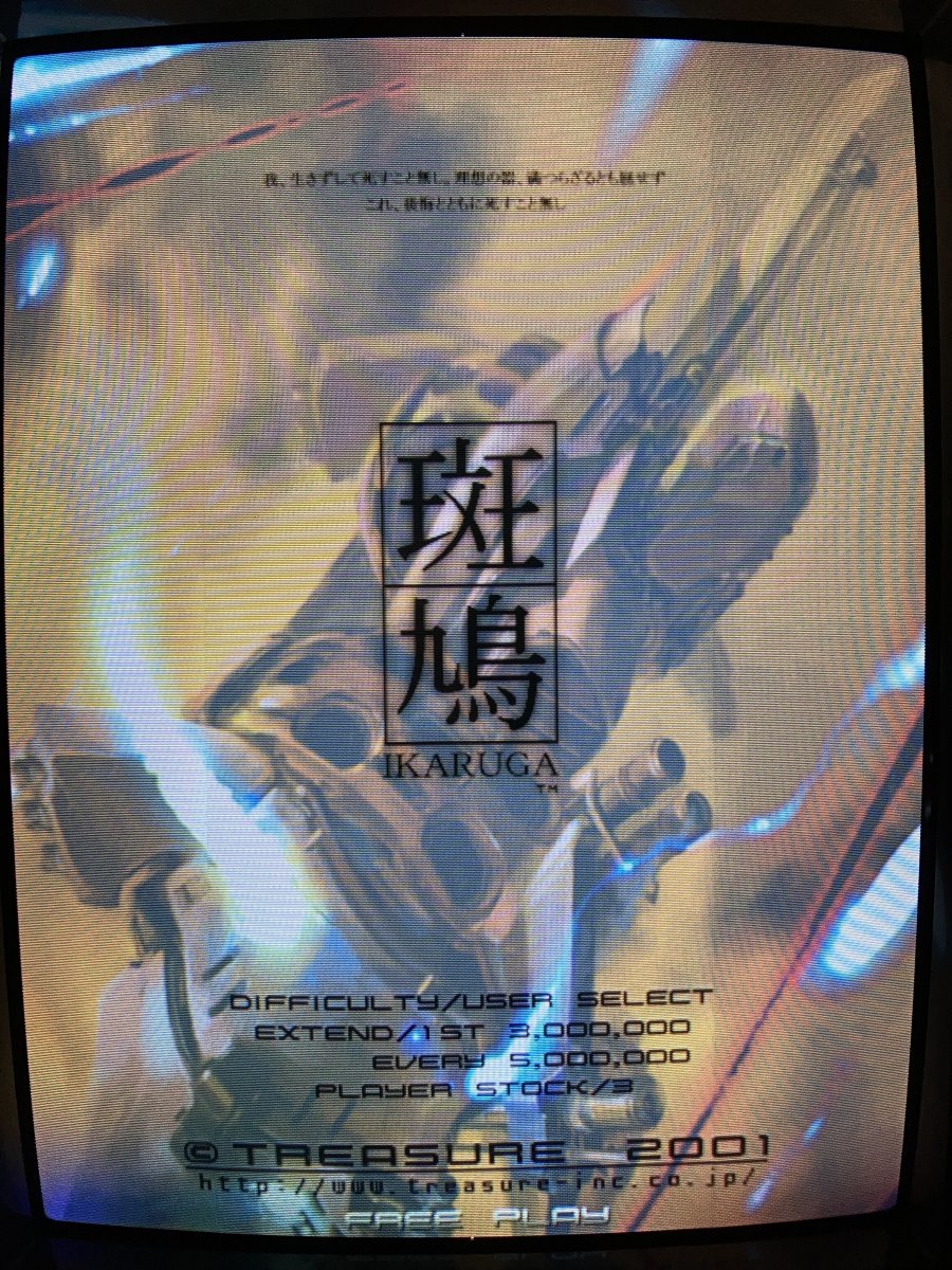

Custom Ikaruga
Calibrated this bad boy a couple of months ago. Still working like a champ and ready to rock! Needed some custom convergence strips for the corners and general TLC, but looks great!

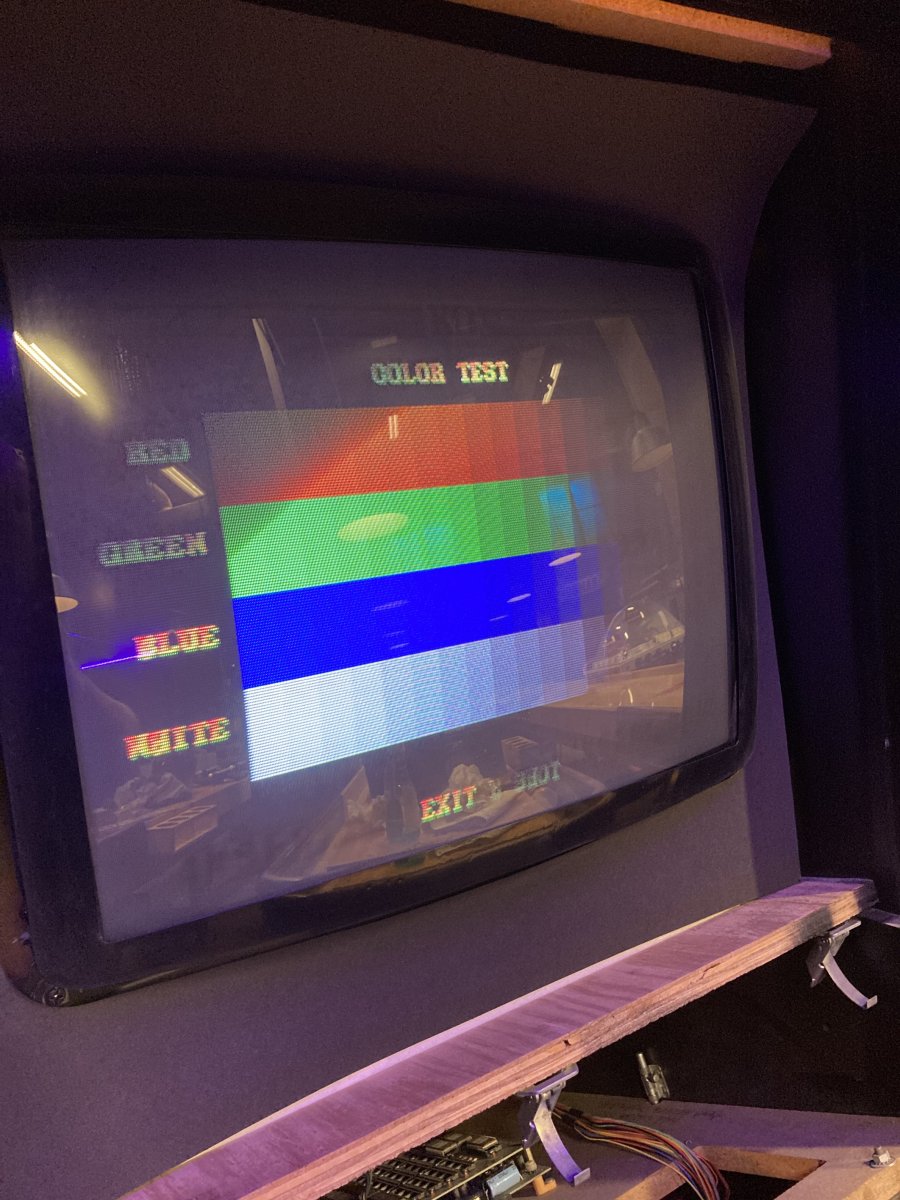

Oslo, Norway

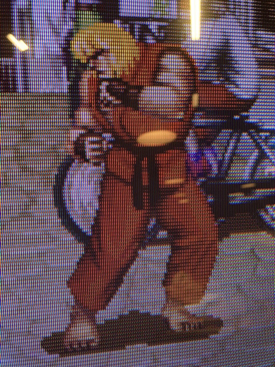

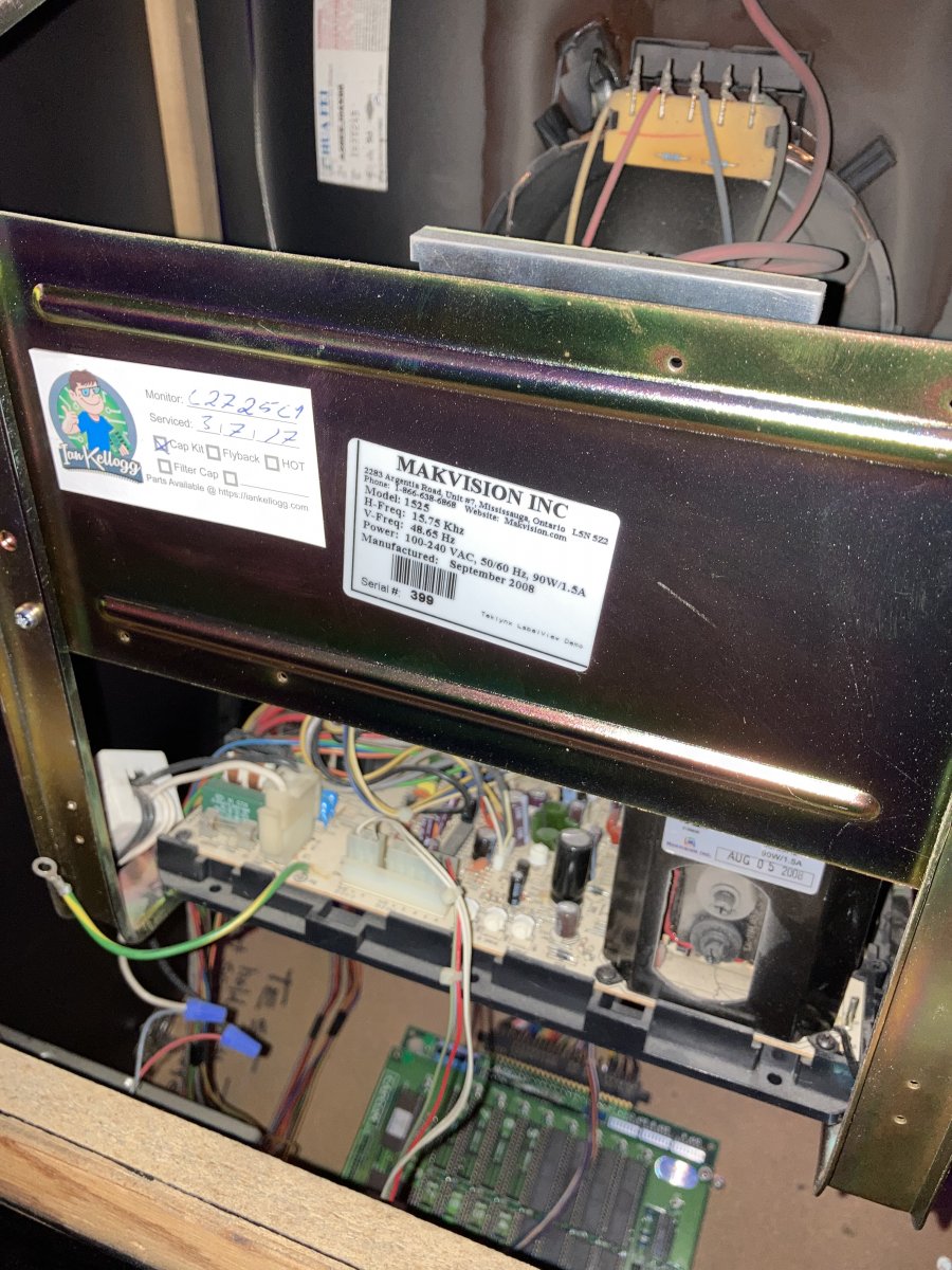

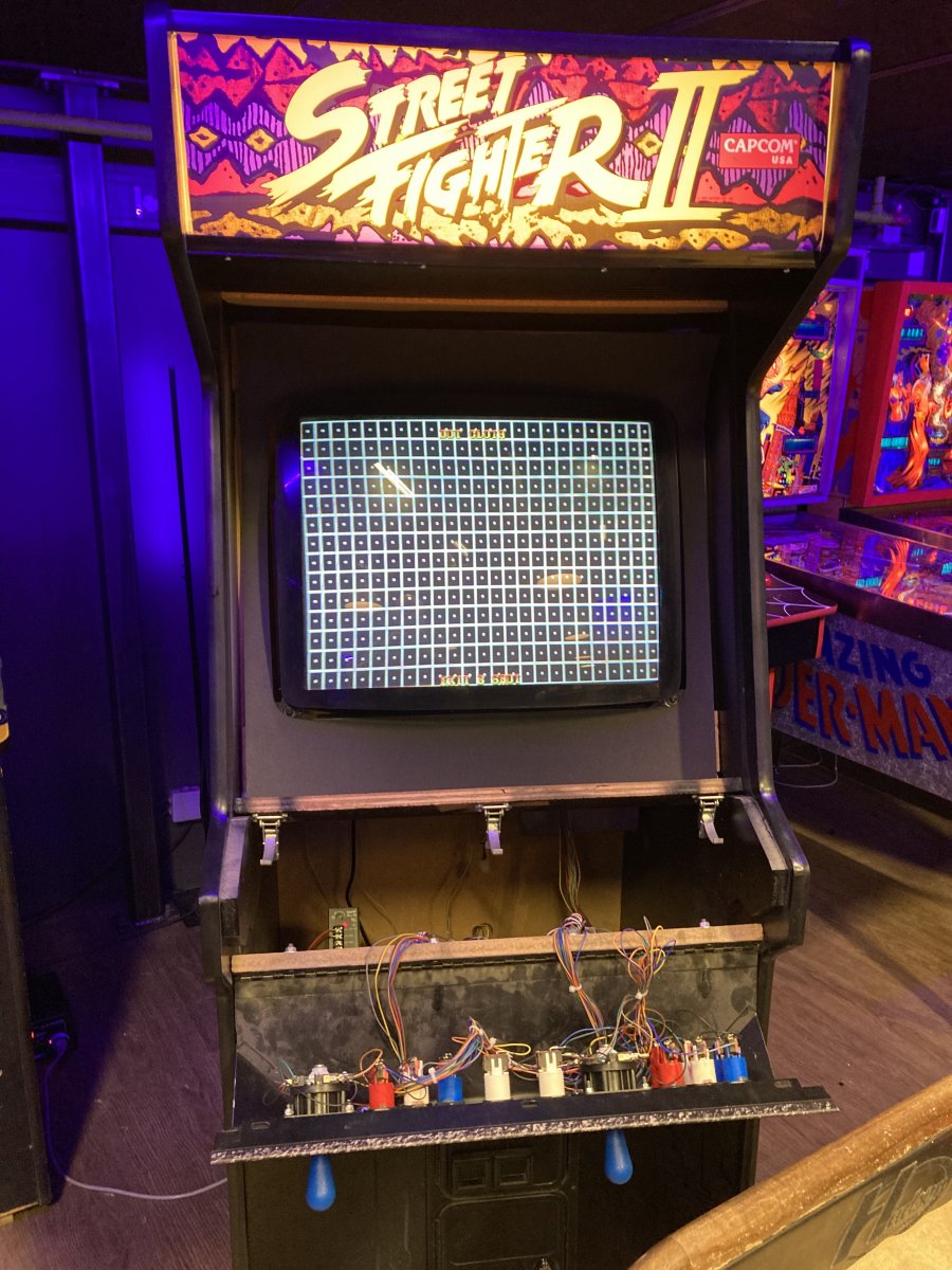

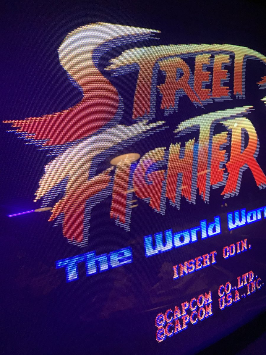

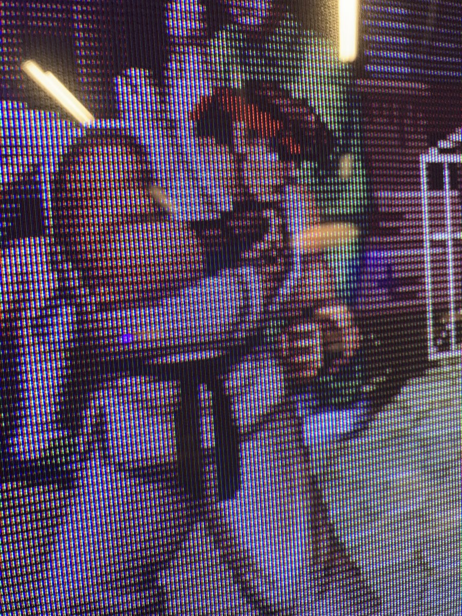

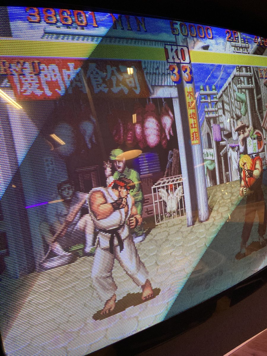

Todays cab was a Street Fighter II Dynamo Cab.
Not in bad shape, but could be better.
Was hoping for a Wells Gardner, but got a Makvision.... Kind of a downgrade?
Colors was way of. Flyback was way to high... well everything was off...
Started from scratch and the results was pretty sexy.
Mmmm... scanlines...
