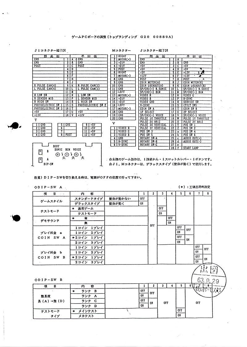

Hi everyone, I'm working on a Taito Top Landing Deluxe, the one in the picture (picture taken on the web)
Online you can only find the manual of the Upright/Cockpit model. I would need the manual of the Deluxe model. If anyone has some information, it would help me a lot.
On the web with a lot of struggle i managed to find only this info:
Please, help me, I want to make this old masterpiece work.

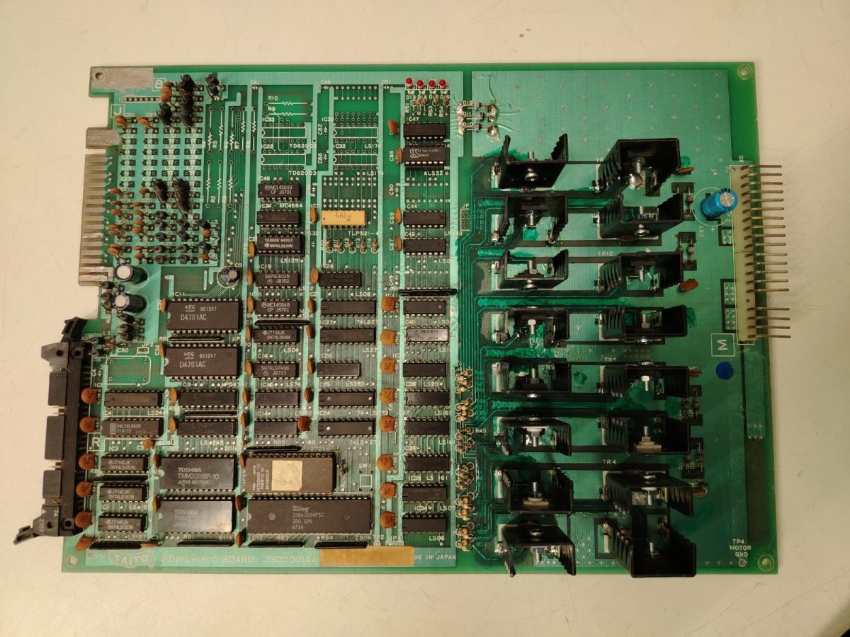

The motor PCB was tampered with, and most importantly, the wiring was cut.
I repaired the game PCB and the motor PCB, but I still need to fix the wiring.
