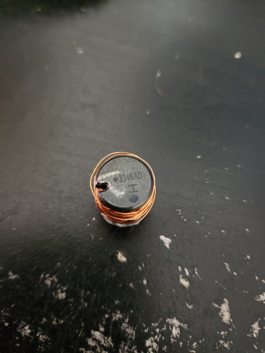

B BlastRugi Student Joined Nov 5, 2023 Messages 34 Reaction score 14 Location Tallahassee, Fl Aug 16, 2024 #1 Does anyone know an acceptable replacement part for this inductor? It got knocked out and mostly unwound during shipping Attachments 20240816_162403.jpg 101.2 KB · Views: 55

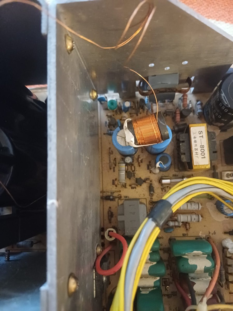

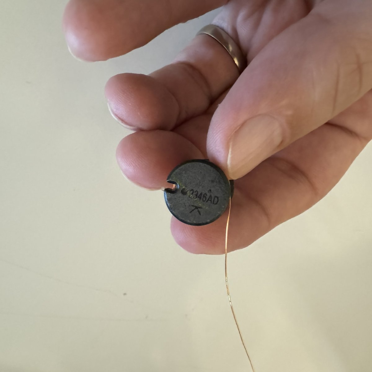

dewmansnk Professional Joined Dec 1, 2017 Messages 284 Reaction score 610 Location SoCal Aug 18, 2024 #2 3346AD Ref Des - L808 Ls - 3.906mH @ 1Khz Cs = 6.487 uF Rs = 2.11 Ohm Tested with DE-5000 LCR Meter I had one of those pop off and rewound it, I ended up with somewhere around ~3.7mH which seemed close enough for it to work.
