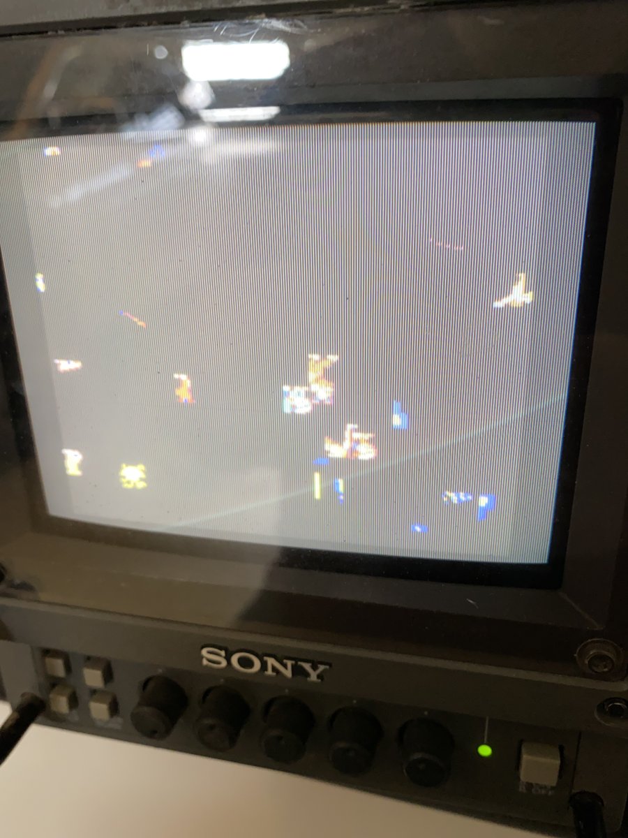

Weird issue - was getting ready to take my Track and Field board into work and get it all hooked up. Checked it out at home - worked great - I changed the battery just in case the one in there was old, and went to work and hooked it up.
The board booted to something similar to the picture below - I adjusted 5v a little up and down, and then took the board home to troubleshoot. When I got it home - hooked it up to my supergun, same issue (good!). I then started looking at everything that could have shaken loose during the 30m car ride. The ribbon cable was seated and locked in, everything seemed ok. I popped the battery out and then back in - and voila - it booted up! Weird right?
So I take it back to work today - exact same problem when I get to work - can't get it to book. I take it back home again, and now, on my bench - I can't get it to boot up, even after removing and putting the battery back in.
Has anyone run into this kind of issue before?

Same behaviour - even with the diagnostic EPROM in there - is there something I have to do get into diagnostic mode? I saw some information about holding down player2 start when booting up - but that didn't do it.
matt

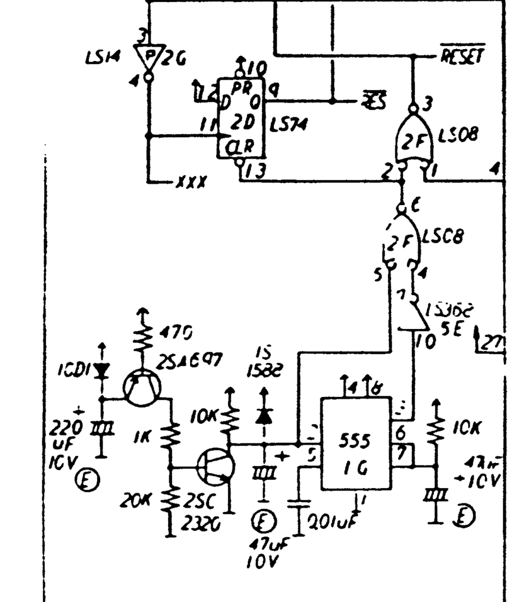

it looks on the schematics like it has 2,
47uf caps connected to a 555 timer chip
there is a 3rd 47uf cap that controls some power stuff too.
very strange schematic!

It's been a while, but in MAME i just tried it and you don't need to do anything, it just boots into the test mode. So your board might not even be making it far enough to load it. So it's a good place to start checking the reset circuit @stj is talking about. Reset looks like it's pin 19 on the Konami 1 chip on the bottom board. The 555 timer and related caps should be nearby. I can take a look at my board a bit later if you can't locate it.

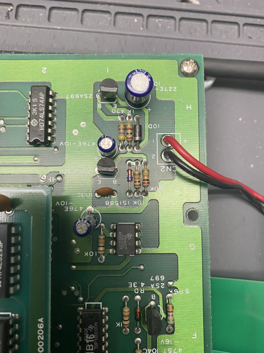

Found that area - at least with a visual inspection - everything seems ok! Super frustrating that just replacing the battery seems to have caused the board to go wonky!

the schematic ekorz posted is less messed-up than mine,
that 220uf cap isnt even on mine - the scan has the edge missing! :(
It might not be the battery, that could just be coincidence. Replace those caps if you can, it certainly can't hurt at all! Old caps can do weird things.
Will do - just ordered the capacitors from Mouser - I will replace those 3 next weekend and see if it makes any difference!

I have this very same track and field and the watchdog is barking and I dont have a pulse from pin3 on the 555.. Shouldnt there be a pulse there?
So mine is now a multi (nice kit too btw) but that means all the boards are stacked and bolted in a manner that I'm not excited about undoing. I didn't see this 555 on the top board (with the connector edge) so I'm guessing it's on the bottom one. Can you tell where the 555's pin3 has continuity, on the bottom of the pcb? That way I can keep the stack intact but still probe it?
Otherwise looking at a generic 555 pinout, 3 is the OUTPUT so yeah I would really expect it to have a signal.
Ok, further research I rebuilt the exact circuit in a lab and it is a delay for start up. like 1 sec is all. So, I guess it is used for a soft power up upon power fail or DC drop.
I am now reverse engineering the Custom 3F card to see how the watch dog work signal works coming from that card.
