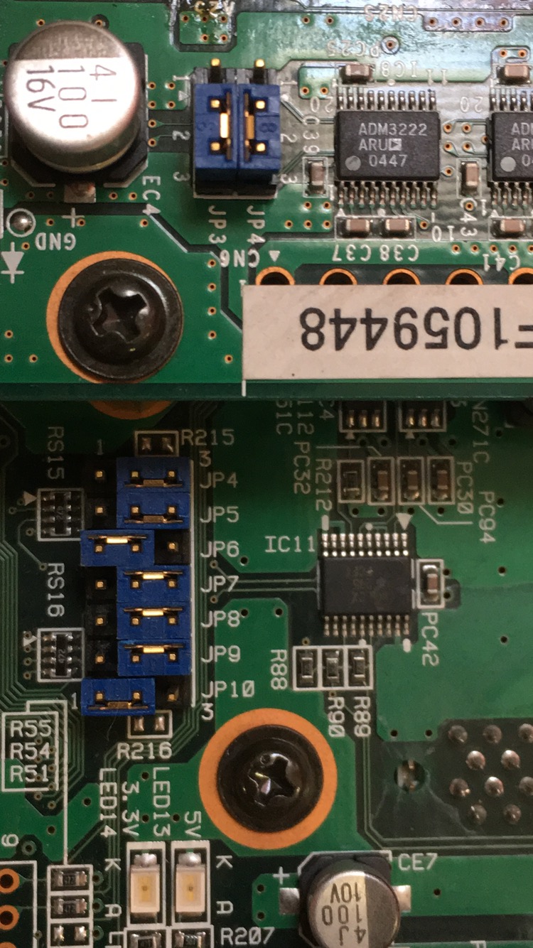

Could you post a picture of your jumper settings on the chihiro dimm board. Just to verify they are set correctly. (Or just post how they are set)

Jumper settings

The jumpers are set correctly for netbooting.

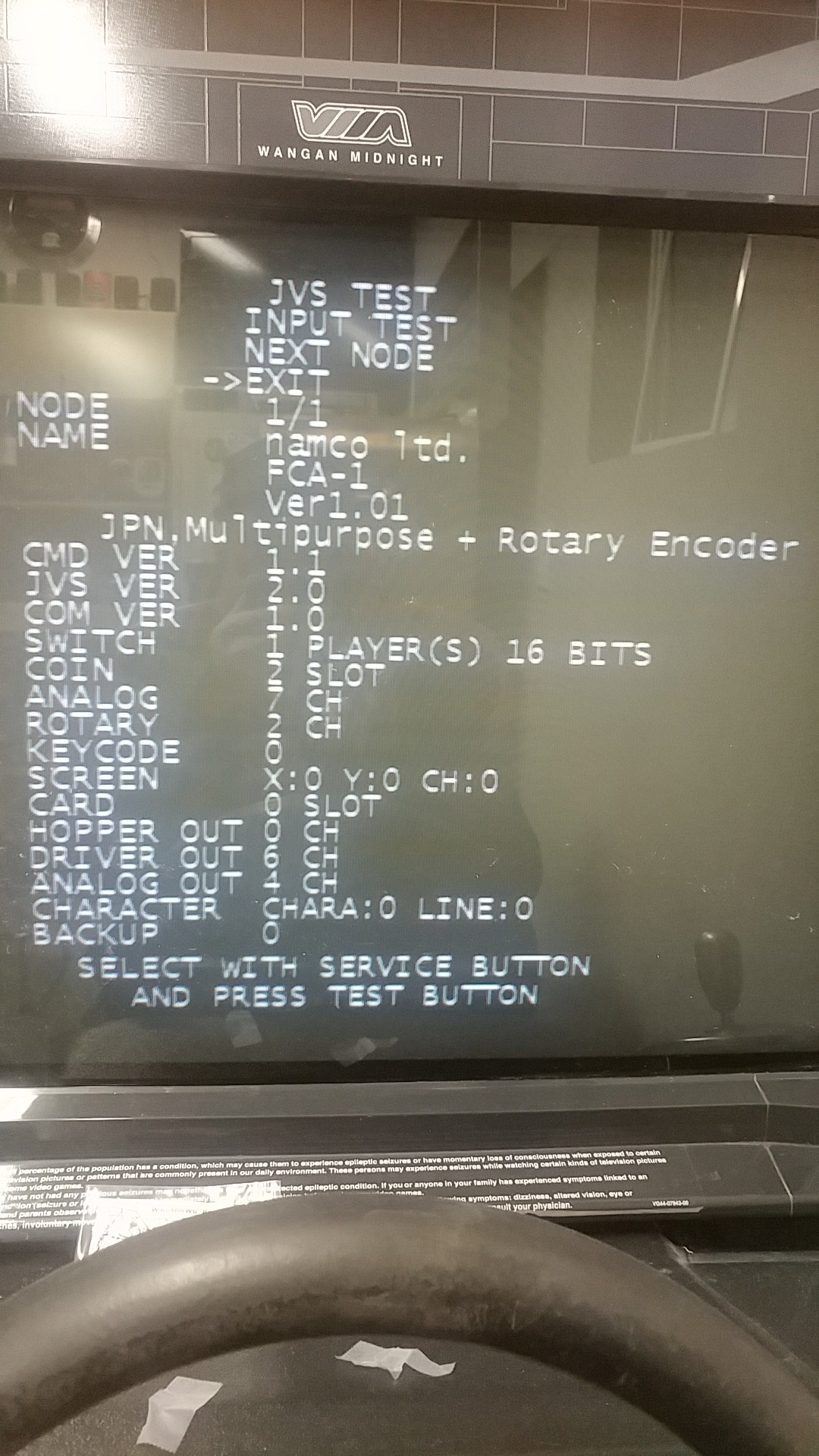

Can you check the gas, brake and steering wheel in the test menu. I think it's the JVS test that should show you the values read from the analog inputs.

If you go into testmode, I seem to remember there is a JVS test. Could you perhaps post a picture of that screen?
It will show some version information if I remember well. I wasn't aware WMMT(2) used a different JVS board.

@Loonz605 normally Outrun 2 uses 837-13551 JVS I/O, where 8 analog inputs. perhaps this game doesn't like if IO have less (7 analogs in FCA-1), no matter what it actually uses only 3.
