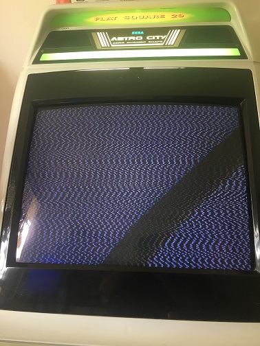

This is what I get when I plug it into the Astro:

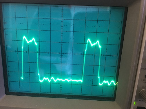

And I probed the sync line with the scope to see what I get there:
Those wavy lines mean the system is not being correctly initialized, all Toaplan games on same hardware behave in this way.As you said (and I guess you read it on JAMMArcade repair logs, we spread our knowledge all around...) probably the sound system is not running and this prevent the whole system to boot.Now it's up to you to figure out why :)
