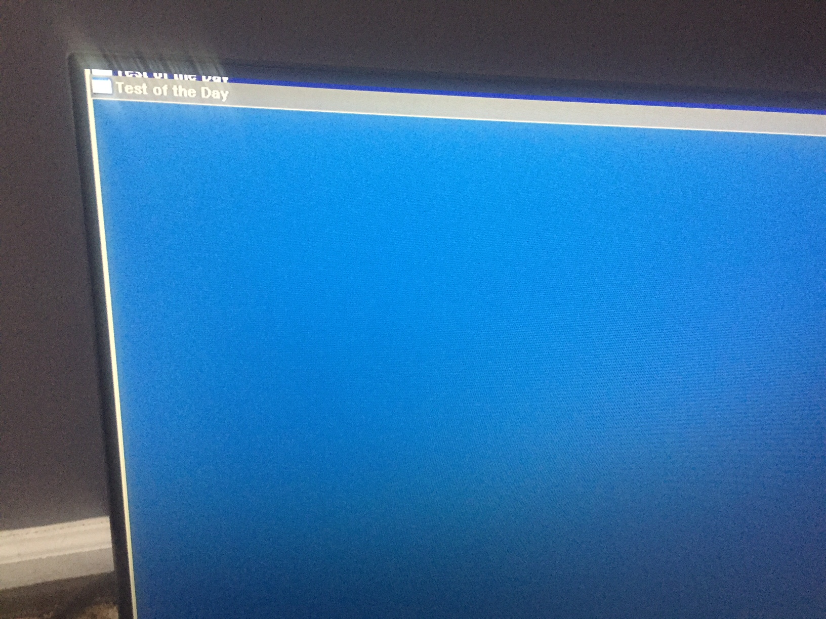

Hello.. has anyone seen. Long shot since not many of us has this game/system. when I boot the system with original USB key, HD, fastI/O etc, I get a screen that says "test of the day" and nothing after that.. the system eventually reboots after a while.. on the fast I/O middle lower part of the board I get a red blinking light. What am I missing? Thanks in advance for any feedback.

The game does an DVIdriver check against the monitors attached to the system.. if they are not the Taito LCDS (L, FC,) the game will go to the "test of the day".. I attached the L and the FC monitor and everything worked.. I tested every LCD that I have and nothing worked.. there is a device that copies the monitors ID and other types of monitors can be used..that info is on the link below.

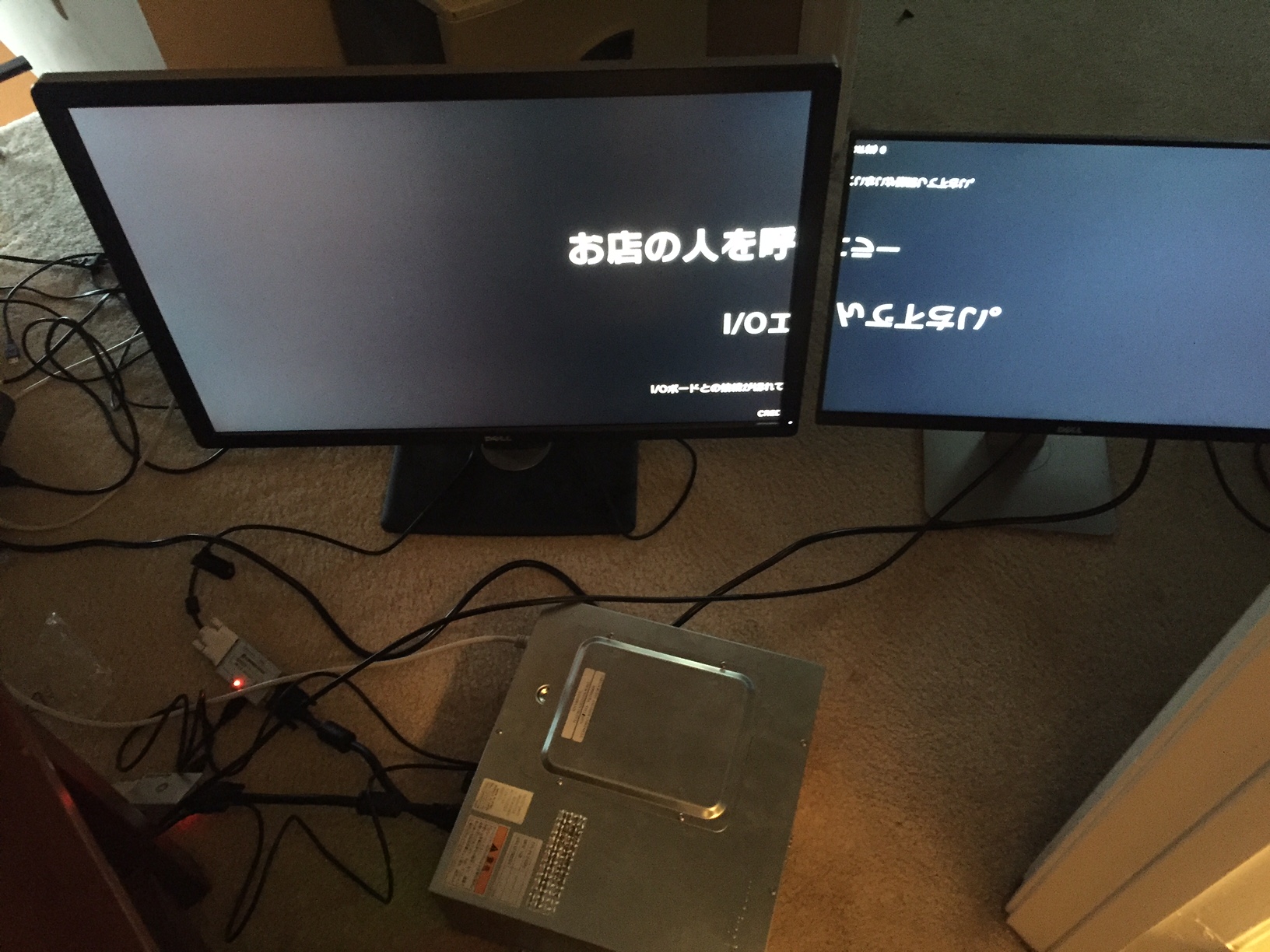

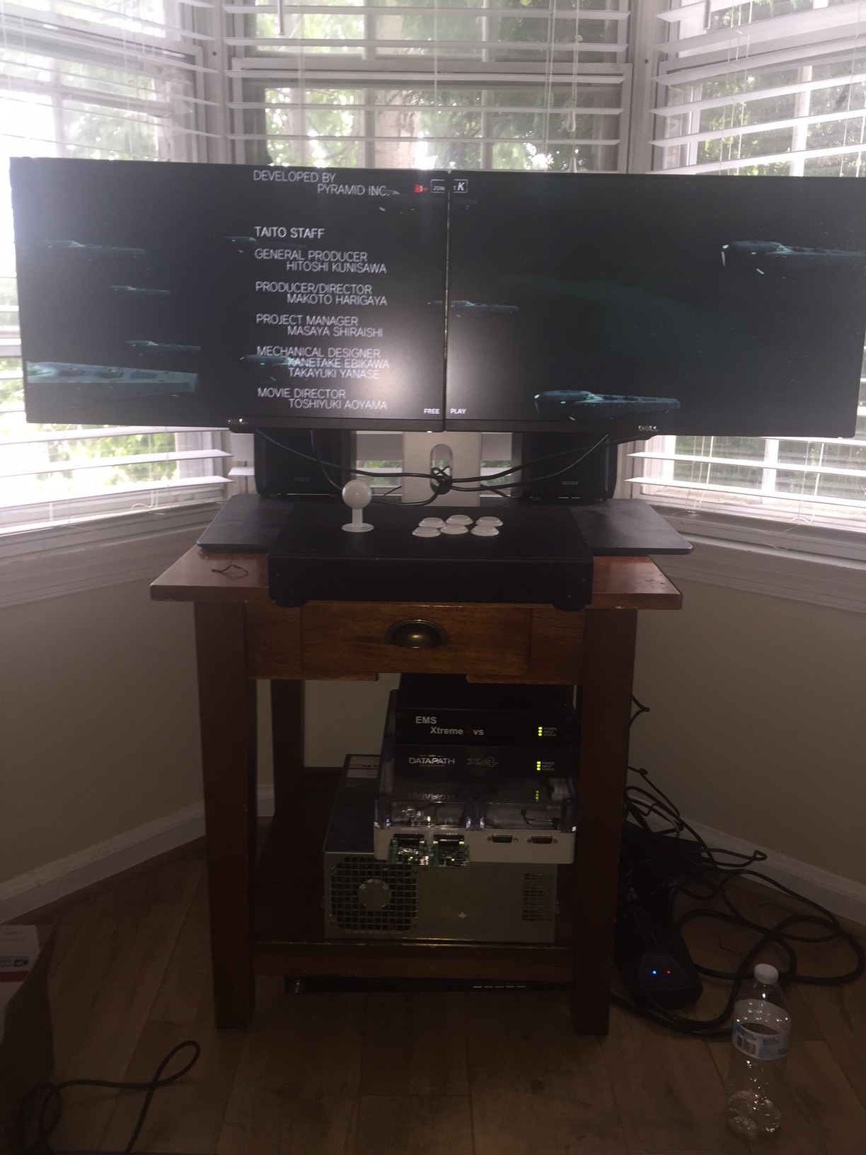

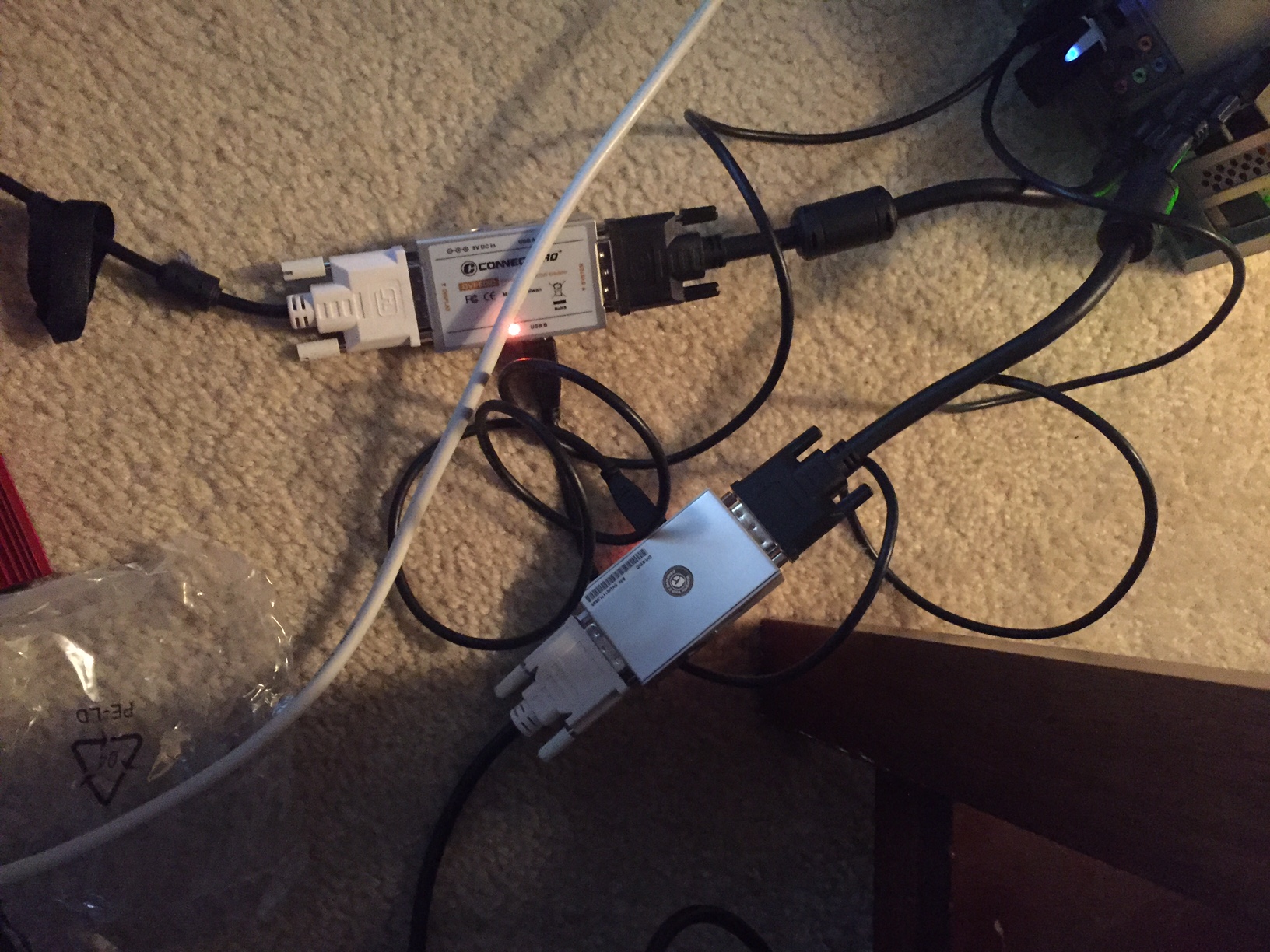

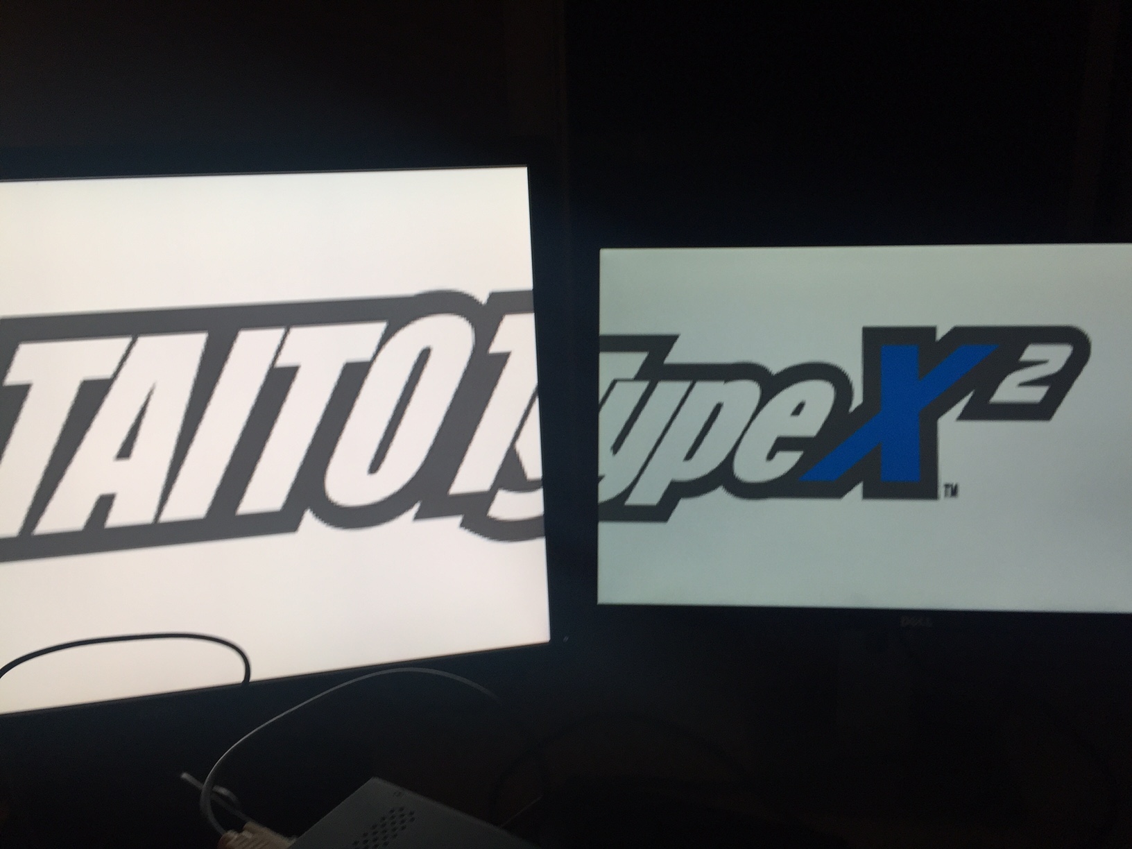

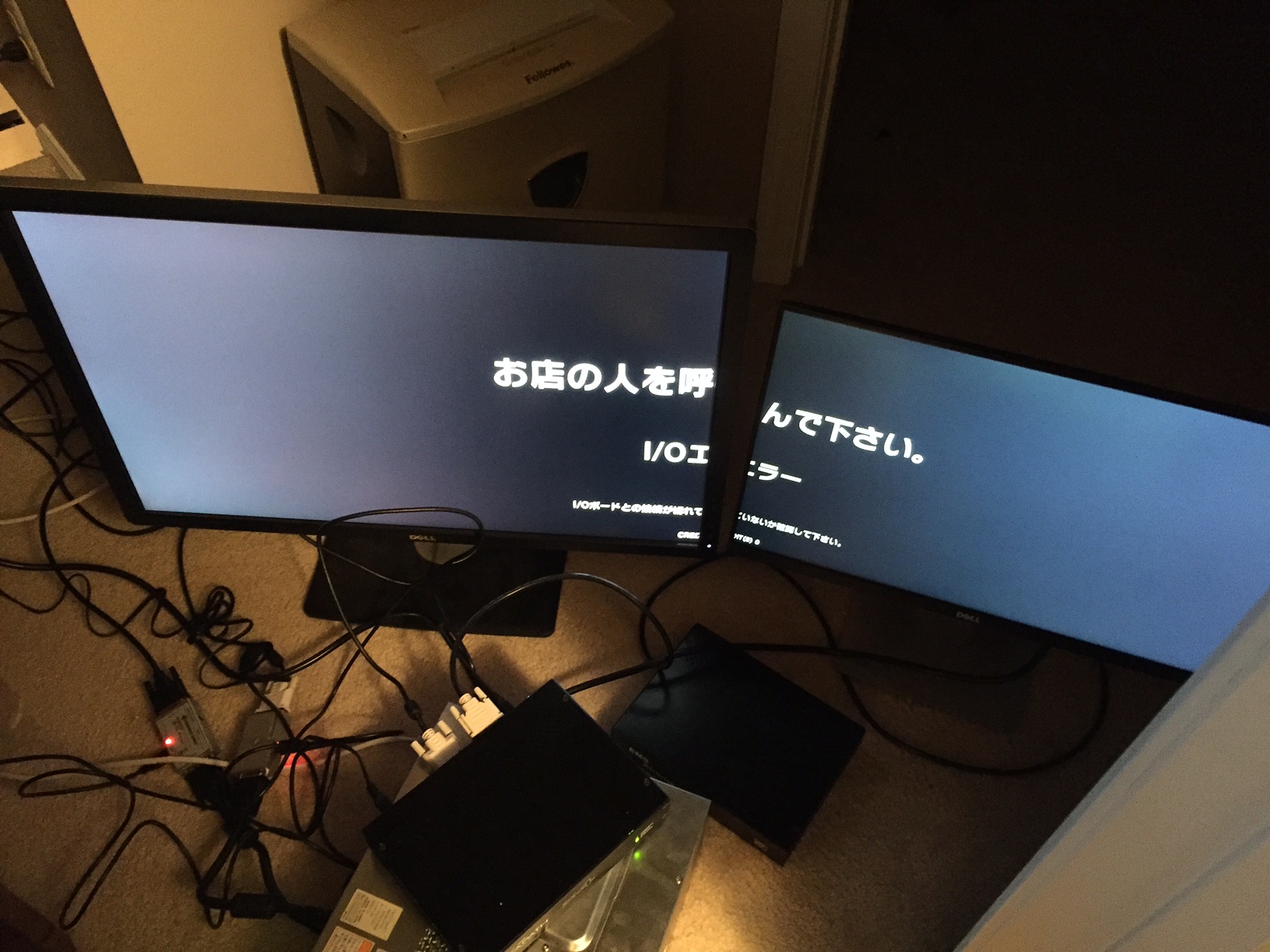

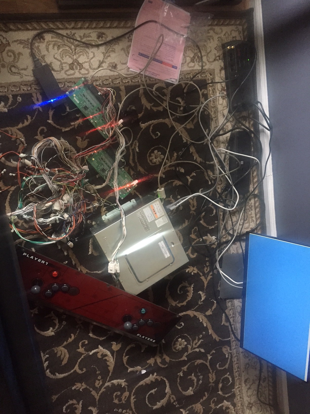

Wanted to post my last update in this project.. the DVI-ID emulator works and tricks the Darius system into thinking that it is attached to Taito's monitors.. I guess that people with the cab will not need to dish out money to Taito to replace a failed monitor.. the datapath x4 appears to work on flipping the second monitor chained to the DVI-ID emulators.. I say appears to work because I will not be able to run the game until I get my two fast I/Os back..the system boots pass the test of the day but when it boots into the game, the game detects that there are no I/Os attached.

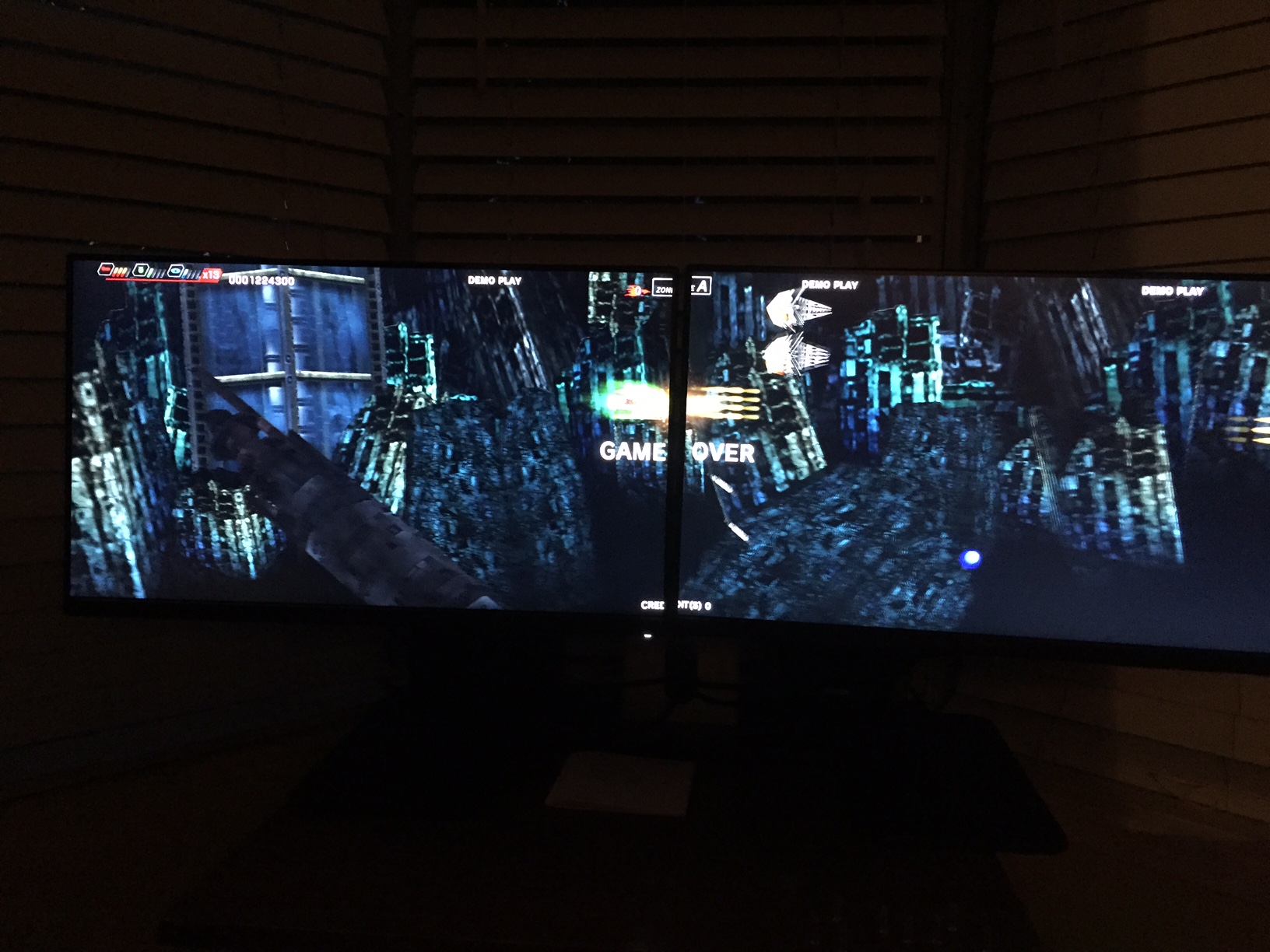

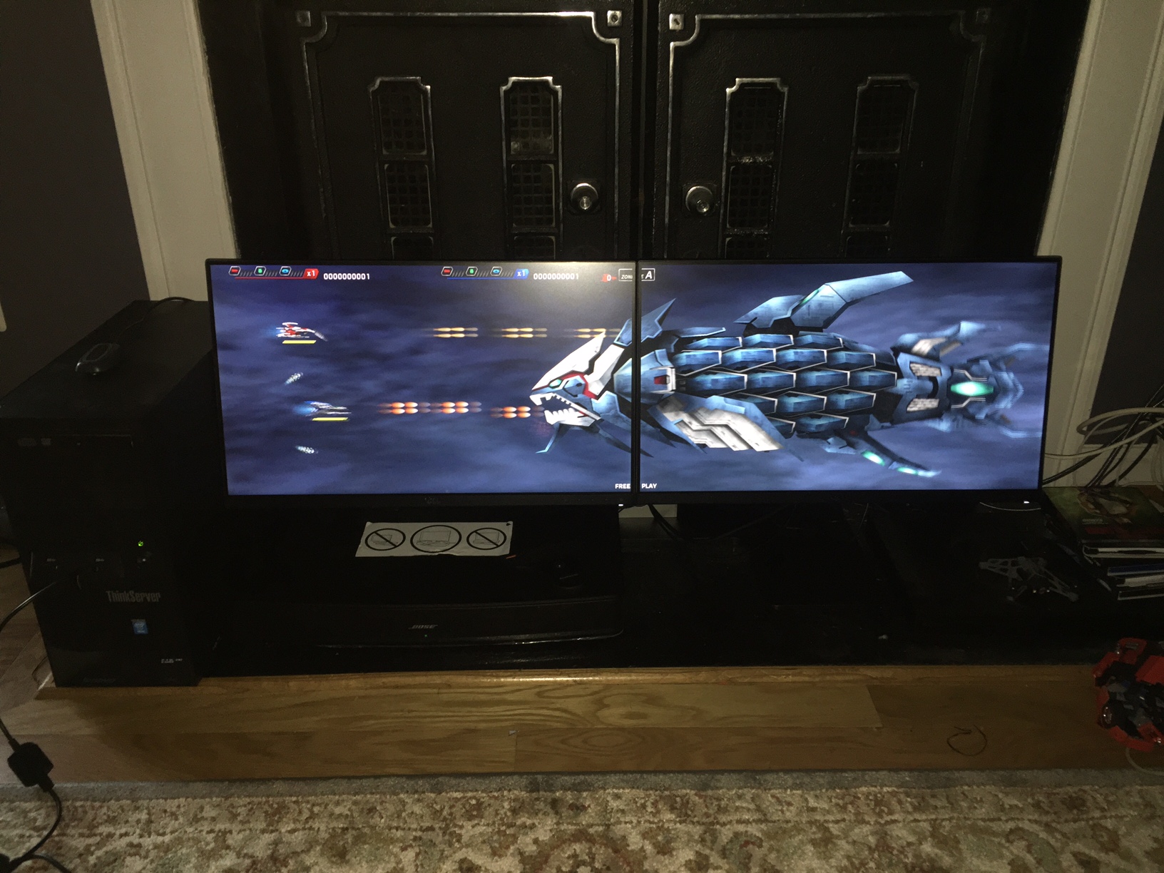

While I wait for @Lemony Vengeance and the fast I/O box I set up the Steam version..here is what I ended up doing..
One of these
https://www.ebay.com/itm/Dell-MDS14...AOSwVVlcdtHX:sc:FedExHomeDelivery!20850!US!-1
One of these (combo of two monitors)
https://slickdeals.net/f/12865957-2...l-monitors-340-free-s-h?src=SiteSearchV2Algo1
The monitors work well due to the thin edges and I highly recommend this route.. i went to microcenter and took a look at the new 32:9 curve monitors and I just did not like them.. I need flat.. the Dell version was not on display and the curvature is not as pronounced but I did not see it in person and even with a bit of curve it would have bothered me..
PC with an old nvidia 970, Xbox 360 wireless hub controller.
Old Bose solo for sound

I would like to give a huge thank you! to the people below for making my DB project a success.. it took time and a lot of help but we have are at the final goal:) thank you! Everyone :thumbsup:
@Derick2k - sold me the game kit and made a power supply to power on the Fast I/O
@lemans123 - test of the way resolution
@Lemony Vengeance - fast I/O console case
@corey - looking into test of the day issue and flipping the second screen research.
