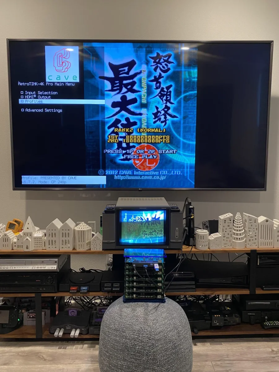

Your best option for running a vertical JAMMA board on a horizontal Vewlix display is to use a RetroTink 4K - it can scale the output correctly and apply the rotation.
Rather than a Chinese converter board, I suggest using a Jammafier by @invzim . It's designed specifically for adapting JAMMA boards to work on JVS cabinets.
https://irkenlabs.com/jammafier/introduction/
With a RetroTink 4K handling video and a Jammafier handling everything else, you'd be all set for running both hori and tate JAMMA boards in a Vewlix.
