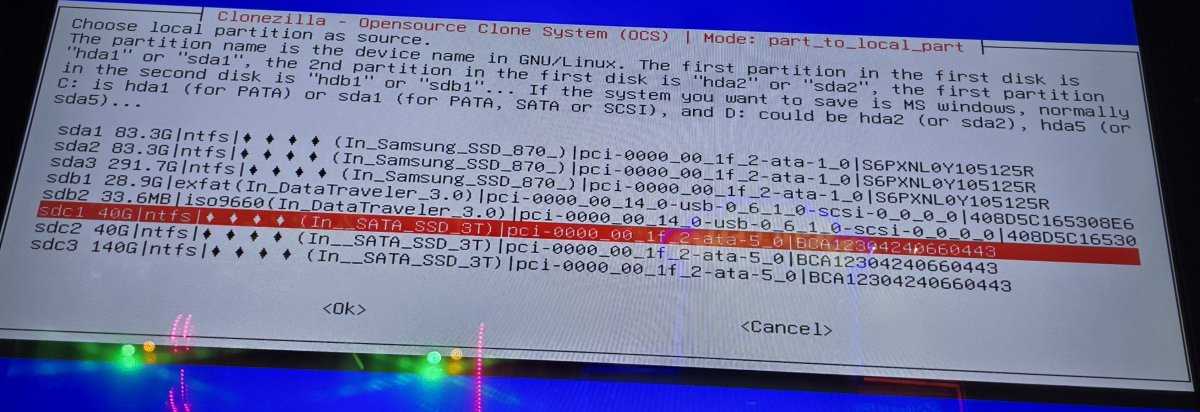

Hello again! I was able to copy the harddrive. I ran into some further issues with the copied ssd. The first issue is when I put the system from "Developer Mode" back to "Operation Mode", I get an Error Code: 07. I am assuming it is because the copied hard drive doesn't have the ATA encryption section or it does not recognize the HDD serial name?
Below is a picture.
sda is the new ssd while sdc is the original ssd.
I know in this picture the partitions on the copied ssd, (sda), are doubled and thats because I asked clonezilla to clone proportionally. I tried exact clone before this attempt and it also resulted in the same Error Code: 07.
I then changed the system back to "Developer Mode" and this does let me boot the game, however after the windows loading screen, I am presented with a blue screen reading "System Error 2703". I think thats the correct System Error number, I'd have to reinstall the copied ssd to confirm. It gave me this error whether I did proportionally clone or exact clone.
My goal here was to make a backup without the the ATA encryption so that when the drive fails, I am able to use the back up.
