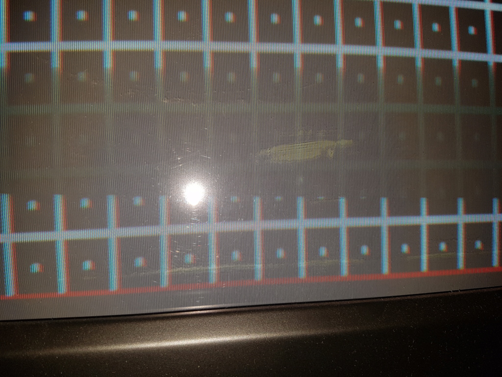

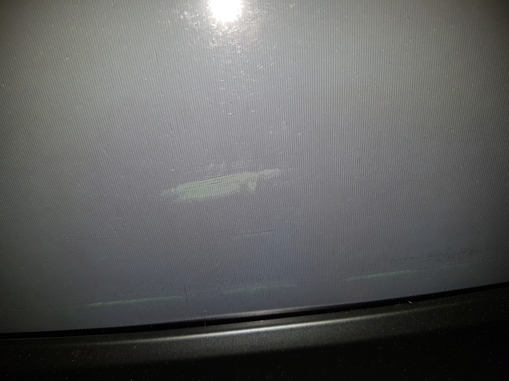

One of my friends bought one NAC witth MS9 29 Toshiba combo. He had one verys special trace ont the down like a scratch. Could you confirm if is it a varnish 's scratch or a burn? If it's a varnish scratch can I fix it, with a very smooth orbittal polisher?
note that without any burn.
thx
They're scratches in the anti-glare coating. You have to buff the whole coating off.
Thx very much, in case off very light scratch what do you think about mr clean magic spong + manual glass polish?
