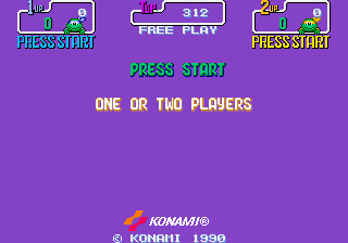

There is a free play hack available for TMNT: Link
It's for the 4P romset. It doesn't really work if you have a 2P cab (no character select).
Besides, there is free play in 2P Turtles (both World and JP). It just sits on a static screen. So yeah, I guess my original reply was confusing. It's there, but it's a bad implementation.
(B1 is still jump and B2 attack though.)
The static screen on that particular free play hack is really poor choice.
It's not a hack. That's how it is in the original 2P romsets.
Ah yes of course I confused it. the other free play hack I read about makes sure to have attract mode etc running
