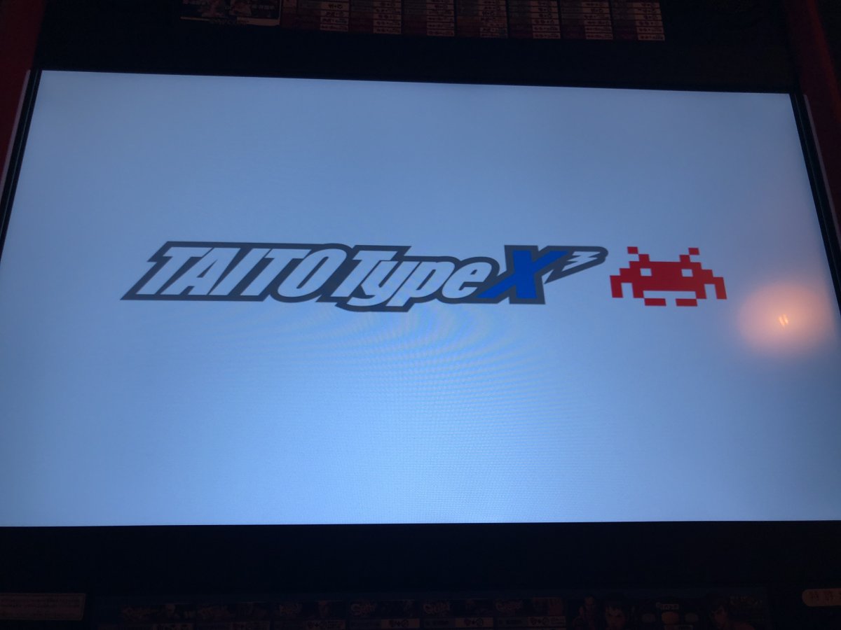

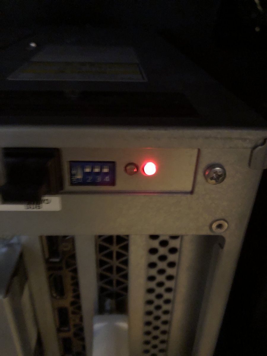

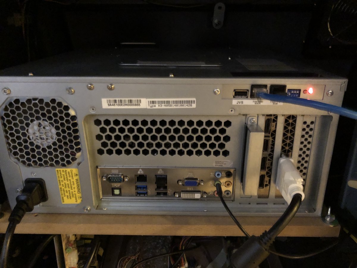

Have a TTX3 with FastIO that boots, beeps once and then gets stuck on the Taito Screen. Everything used to work fine before.
I tried switching back to stock GPU GTX660, replaced Battery, removed
and put in RAM again, booted into BIOS and waited a bit. All without any success.
The SSD is detected in BIOS.
Any suggestions?
