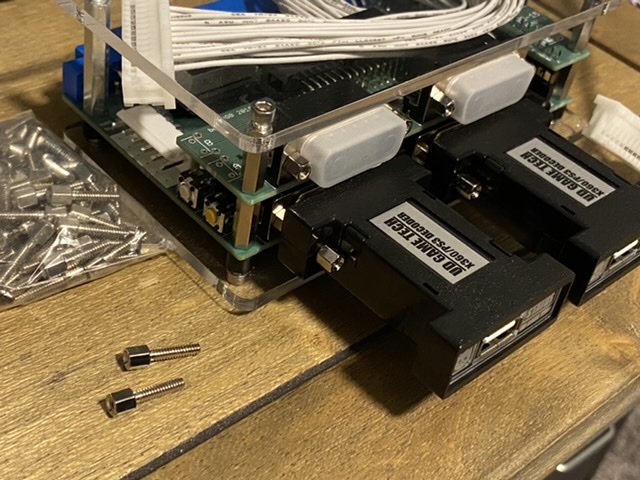

one last question, are there recommend screws I can use to secure my decoders to my HAS? I feel they’re too easy to detach from the DB-15 ports.
I jacked mine from another connecter and use them the same way you're intending. Word of advice, don't screw it on too tight. I had one on too tight and it stopped working until I loosened it up.

Ended up ordering a pack (100) of #4-40 jackscrews that do the job perfectly.
Nice and secured. I’ve got short USB extensions I use as ‘break-away’ cables, so the Decoders stay on the HAS, and people can plug in their controls via the extension cables and not have to touch anything else. This is vital for a tournament situation where people are plugging in and out their USB cords.
If anyone wants a set of 2 of these jackscrews, let me know. I’ve got a bunch in this pack. Just pay for the postage. *forget that, I can fit these in an envelope and use postage stamps. No need to pay for anything, if you need some just let me know how many and where to ship*

TBH in a tournament situation I'm going to be using DB15 extension cords because I don't want anybody near a partially exposed supergun. I have been trying to figure out a decent way of securing the UD-USBs to an extension cable though. Something like this may help, as in screw the bolt end of the jackscrew into the extension cable's screws, and secure the screw end of the jack screw with a nut.
yeah, that’s why I use cheap USB extension cords that connect to the screwed-in Decoders. I don’t even want people to touch the Decoders! With my setup, you don’t need DB15 extensions. Just leave the Decoders on the HAS, and have people plug into the USB extenders. The extension cables also work as break-away connections, in case you have a salty rage quitter yanking on the cord after gettin’ bodied LOL.

Now that you mention it, I have used a USB extension before when running a head 2 head setup over the UD-CPS2. It works though it probably wouldn't be a good idea to use too long of a USB extension. The biggest issue was people not being able to see the light when they needed to re-bind their buttons or make sure their controller was detecting in the first place, so I'm torn about what extension to use in that situation.
I also have a fringe case requiring DB15 extensions, due to having a consolized Atomiswave where the DB15s jacks are incorrectly wired for UD-USBs, so I had to make adapter cables since I really don't want to open up a consolized Atomiswave unless I have to.
