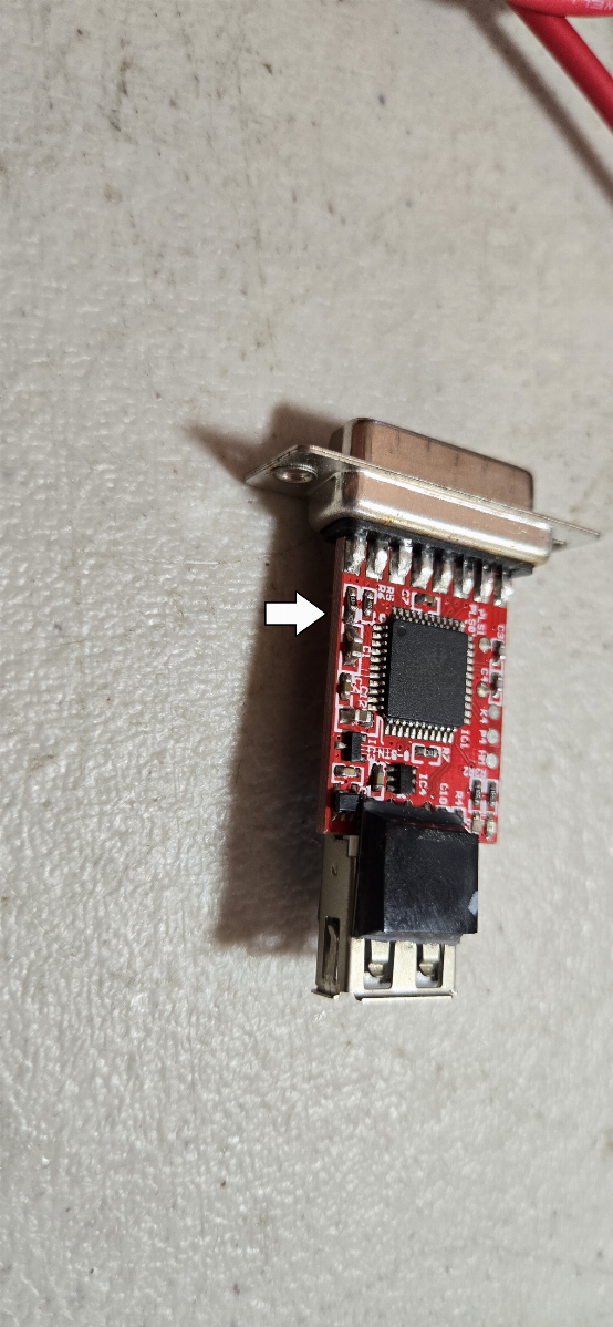

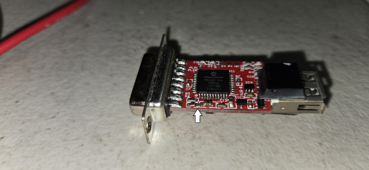

On a separate note, found an oddity under the hood. See below. A resistor sandwiched between R4 at the ground end, and the non-sandwiched end of that oddball resistor not connected to anything. It doesn't seem to be related to teh issue above, as these components have no connection to 2K or pic pin 4, but a peculiarity for sure. I removed that oddball sandwiched resistor.

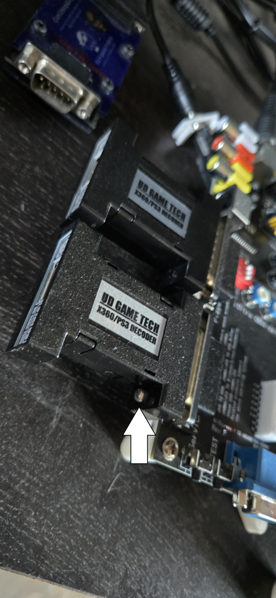

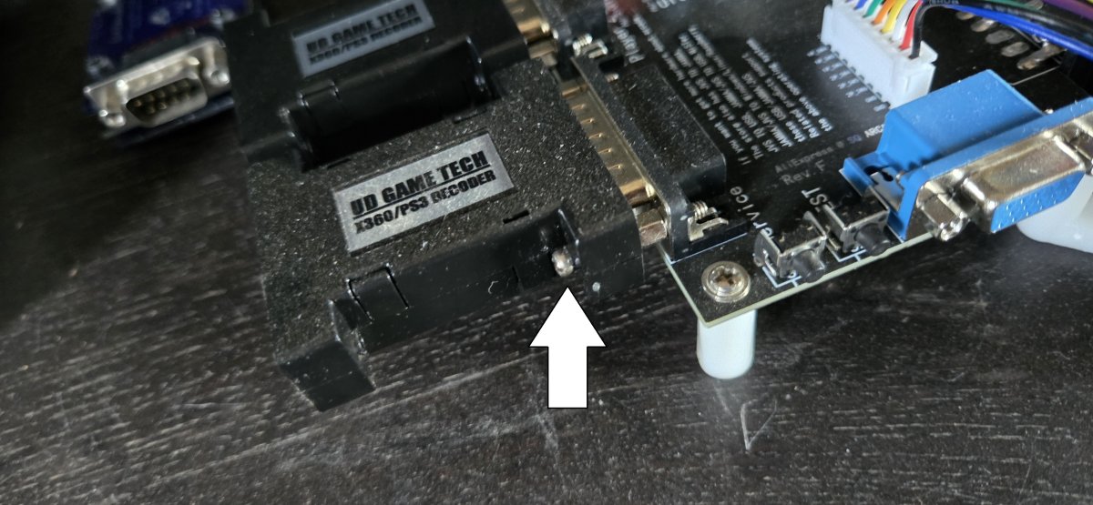

To you or anyone that knows - where can I find the screws that will secure the UD-USB to the DB-15 terminal? I should've removed mine before sending in the faulty unit...my bad. I believe I pulled the ones shown here out of a VGA or DB-15 housing kit, but it's been quite a long time and I don't remember for sure, but I'm pretty sure I was guessing that they would be a right fit and I got lucky that they were. If anyone knows where to get screws that will for sure work, I'd appreciate the pointer.

Installed on one UD-USB and tried screwing it into a HAS 5.0, but I found too difficult and annoying to do regularly. I would only use these if I planned to leave UD-USB installed indefinitely, not for a setup to swap frequently. Because the UD-USB flares out on the USB side, It's hard to turn the screws from the side (no room for a screwdriver) and you have to screw/unscrew them while the DB15 plug is partially inserted.

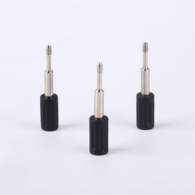

Would these be more comfortable for your fingers? Lots of similar options on AliExpress....
TBH, I wasn't really having an issue with UD-USB being too loose on HAS, and I'm at risk of amassing a collection of thumbscrews, so I'm gonna sit this out.
But if someone really wants thumbscrews, I think you want something shorter than the CablesOnline ones, and no wider (lest they create friction with the UD-USB housing).
Yeah, the ones I had previously did not extend out at all just a "screw into the hole". Screwing them in wasn't much less hassle, because your screwdriver has to be at an angle. If someone ever finds a better solution, hoping they post it. I'm good with mine. I don't swap them in and out often.
