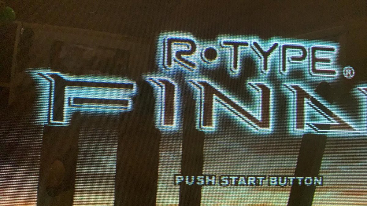

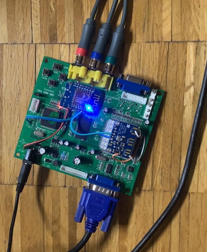

bulit the gbs control last weekend for exactly the same purpose as you - it works great!
Important: i needed the xbox360 component cable, with vga i didn't get it to work - gbs out is vga to the vga hat of my jammaizer by @Arthrimus - works glorious and all together is really cheap and, most important obtainable

I have all the parts and have one built so far. See pic for how I placed things. I kept the cables short. I just need to build the scart connectors, but Tim Worthington was nice enough to post me some more today so I'll have those in a few days! Top bloke.
I should be able to ship the first in a few days. If they are popular I'll buy more but the parts take a while to arrive :(

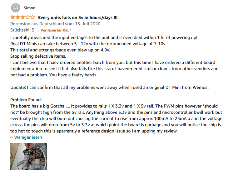

i haven't tried more in the last few days - i can't get its wifi connect to anything since a few days - not the phone, not the ipad, not the laptop - wanted to try some other settings because i realized it looks a litte funky in mushihimesama when the background scrolls to the sides - but much less flicker because there's no interlaced signal, much better for my eyes.
evilsim
Jul 24, 2019
268
199
Sydney
@MoppelTheWhale I have had such issues. But I don't believe it has anything to do with the yellow button PCBs, it's an Arduino thing (I could be wrong). Re-write the code to your Arduino. If it happens again try a different power supply. If it still happens try a different arduino. I have had quite a few different model arduinos which have done some funky stuff. I've had solid good results with the D1 minis.
