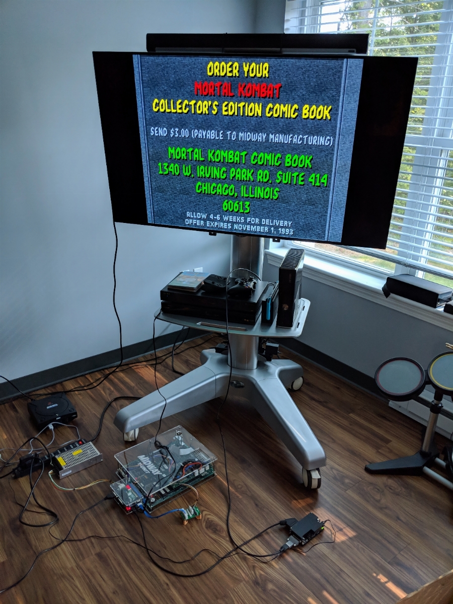

ALL of the above is required!
  • Supergun (I'm using a HAS 3.1 with Suzo Happ 130 watt PSU)
  • Midway kick harness adapter (I'm using the JNX Raiden to adapt for CPS2/3)
  • OSSC (I'm using my 1.5 here, I also own a 1.6 but that sits inside my console cart)
  • DVDO (the VP30 with latest firmware, its also reconnecting audio because OSSC 1.5 has no DA support)
  • LG B6
OSSC Settings:
  • Line 3x mode
  • generic 4:3
  • adjust V and H porch settings to center image to your liking (it will NOT fit the entire screen from top to bottom, I crop most from the bottom because of the timer in MK)
  • Scanlines Auto
DVDO Settings:
  • Unlock 60.0hz
  • Unlock 50.0hz
  • Audio source RCA (only because I'm connecting audio here)
These settings work with the entire Midway *-Unit family (ie Y-Unit, T-Unit, Wolf Unit).

I spent a couple hours on this getting the full image without cropping anything out for MK and looking good. Only thing I haven’t figured out is a way to get a perfectly smooth vsync due to the weird video refresh rate (please let me know if you know how), but it’s still running a hell of a lot smoother than MAME or anything else which was one of the major reasons that got me into arcade gaming at home, outside of my favorite old games just looking, sounding, and playing great as compared to all the half-ass ports over the years and emulation.
Here are my OSSC settings running on a LG OLED55E6P that get the resolution to a very well scaled 3x by 4x (and more or less 4:3 ratio) at 1220x1016. Please note: the extra 20 horizontal lines seemed to be necessary to avoid cropping any of the image out. I confirmed using the cross-hatch pattern in the test menu of MK as well as moving around the backporch to confirm:
Video in proc >
Pre-ADC Gain: 13
[for extra brightness with scanlines]
Output opt. >
240p/288p proc: Line4x
Line4X mode: Generic 4:3
HDMI ITC: Off
[doesn’t seem to affect image on this HDTV]
Sampling opt. >
Adv. timing: 1280x240
H. active: 1220
H. backporch: 224
V. active: 254
V. backporch: 19
Allow TVP HPLL2x: On
Allow upsample2x: On
Scanline opt. >
Scanlines: On
Sl. strength: 12%
Sl. method: Multiplication
Sl. alignment: Bottom
Sl. type: Horiz. + Vert.
[All these make it look like a super-high quality arcade CRT to me. Just looks “right” :]
All else: defaults
