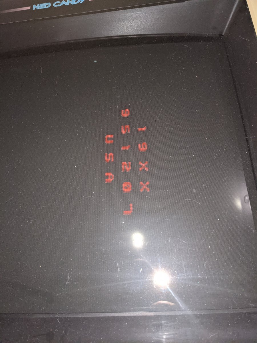

Looking at the boards and chips, they're all marked 19xxU and they look final instead of test roms. Also it has an infinikey on it so that's probably a dead give away it's the common version.
You’re probably right, but still doesn’t hurt to double check if you have a programmer. You’d only need to check the program roms, nothing else.
I wonder if it was rewritten either by Capcom or someone who wanted to use Avalaunch ROMs prior to Infinikey
The Capcom hand written label lists the version as 1/8/96 (I’m assuming this is in US format so 8 January 96)
The boot screen says 951207

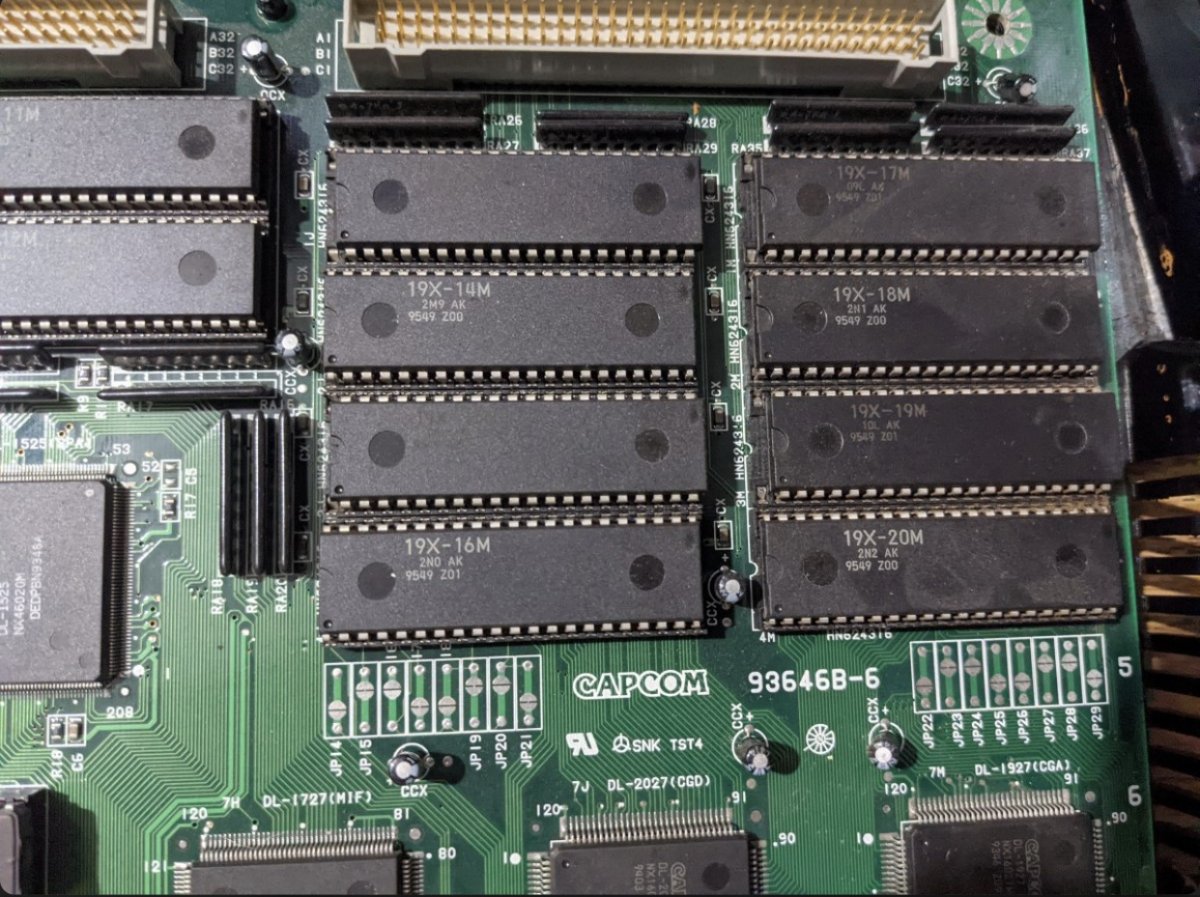

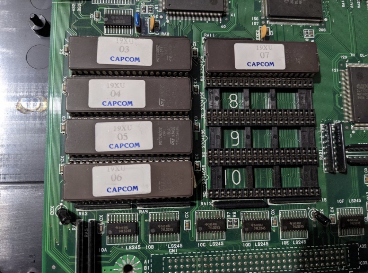

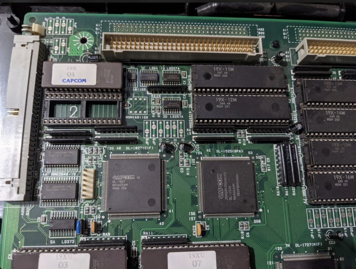

Here’s three pictures of the roms he sent me. I’ve been thinking about buying this board. I’m not an expert and I also could use some help trying to figure out what’s up with this board. Don’t test location board usually have a board with a lot of rom chips on it?.

They’re all factory labels that don’t look like they’ve been removed. Factory mask ROMs. Looks good to me
19XU is the correct label for your boot screen (19XX USA region)
Edit: mask ROMs 13 and 15 are not silkscreened. Interesting. Would be cool to see those dumped and if they match MAME
13/15/17/19 also look like they’re not inserted correctly (1 pin down) but it could just be the way they look in a photo
