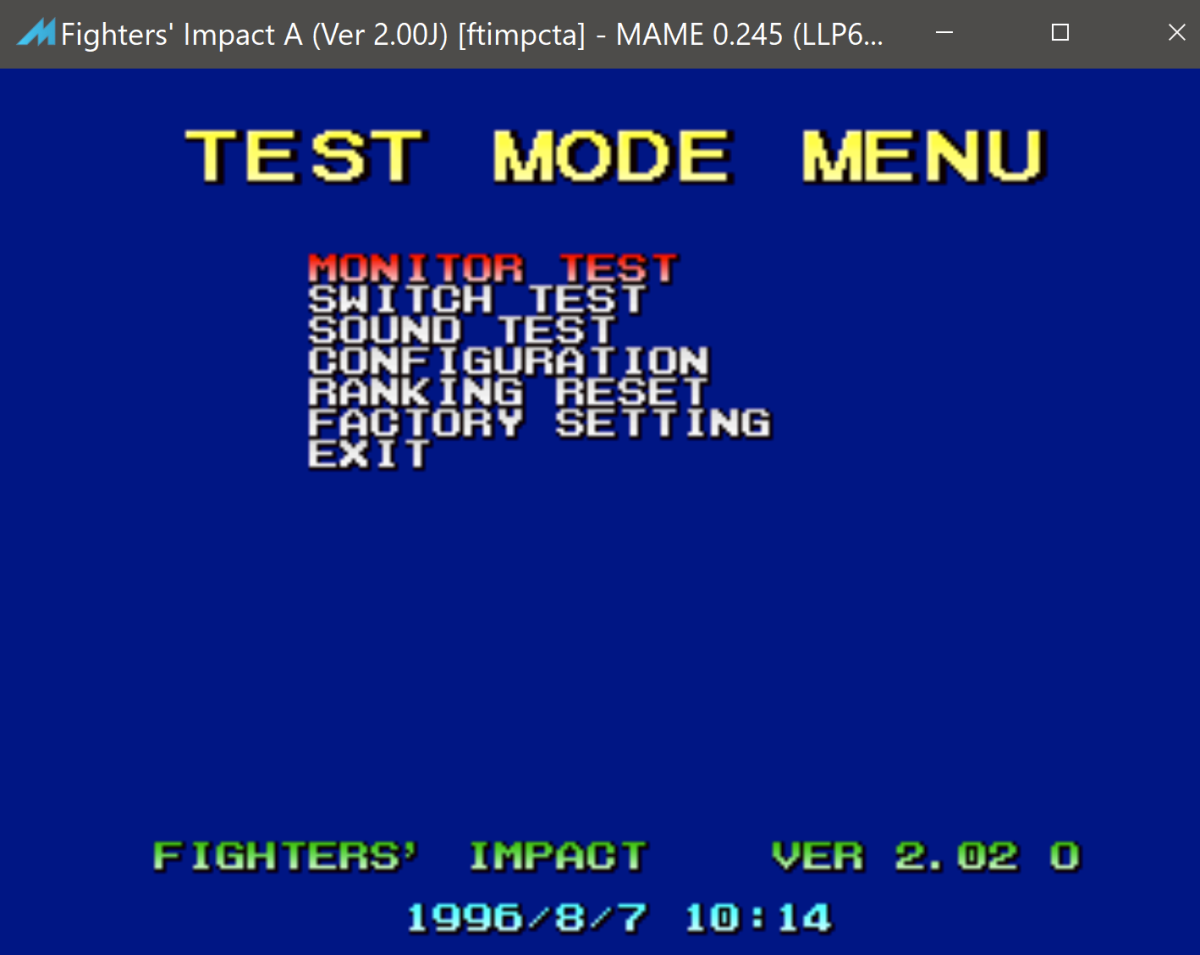

Psyforce should be a straight swap, works in mame. What rom data did you use? What chip type did you use? Which chip locations did you swap?
I would expect fighters impact A de-conversion to also be a straight rom swap too, that also works in mame, though the reverse seems to perhaps take some extra effort to enable the highest data line. That shouldn't be a concern if going from A to vanilla though. You will probably have to use 8mbit roms and double the vanilla 4mbit program data though, just to be safe.
Code:
copy /b e25-07.3 + e25-07.3 e25-14.3
copy /b e25-09.4 + e25-09.4 e25-13.4
