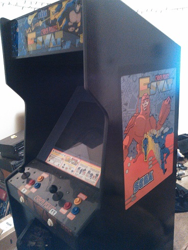

Hey guys, I scored this machine yesterday. I know it's not exactly a super sought after game but it means alot to me!
Anyway, my question-It's obviously a conversion because the harness is JAMMA which goes to an adapter then to the Sega 16 pcb. The ESWAT game looks and works just fine. But I tried to hook up X-Men and the picture was upside down and backwards. I researched that this is the yoke plug and if the vertical and horizontal yoke connections are individually flipped around this will correct the screen. My idea was to put each vertical and horizontal on switches so I can switch between the two "poles" whenever a new game is hooked up that requires it. Is this pretty common? Is it a bad idea? help please
The monitor is a Phillips 19VKUP22

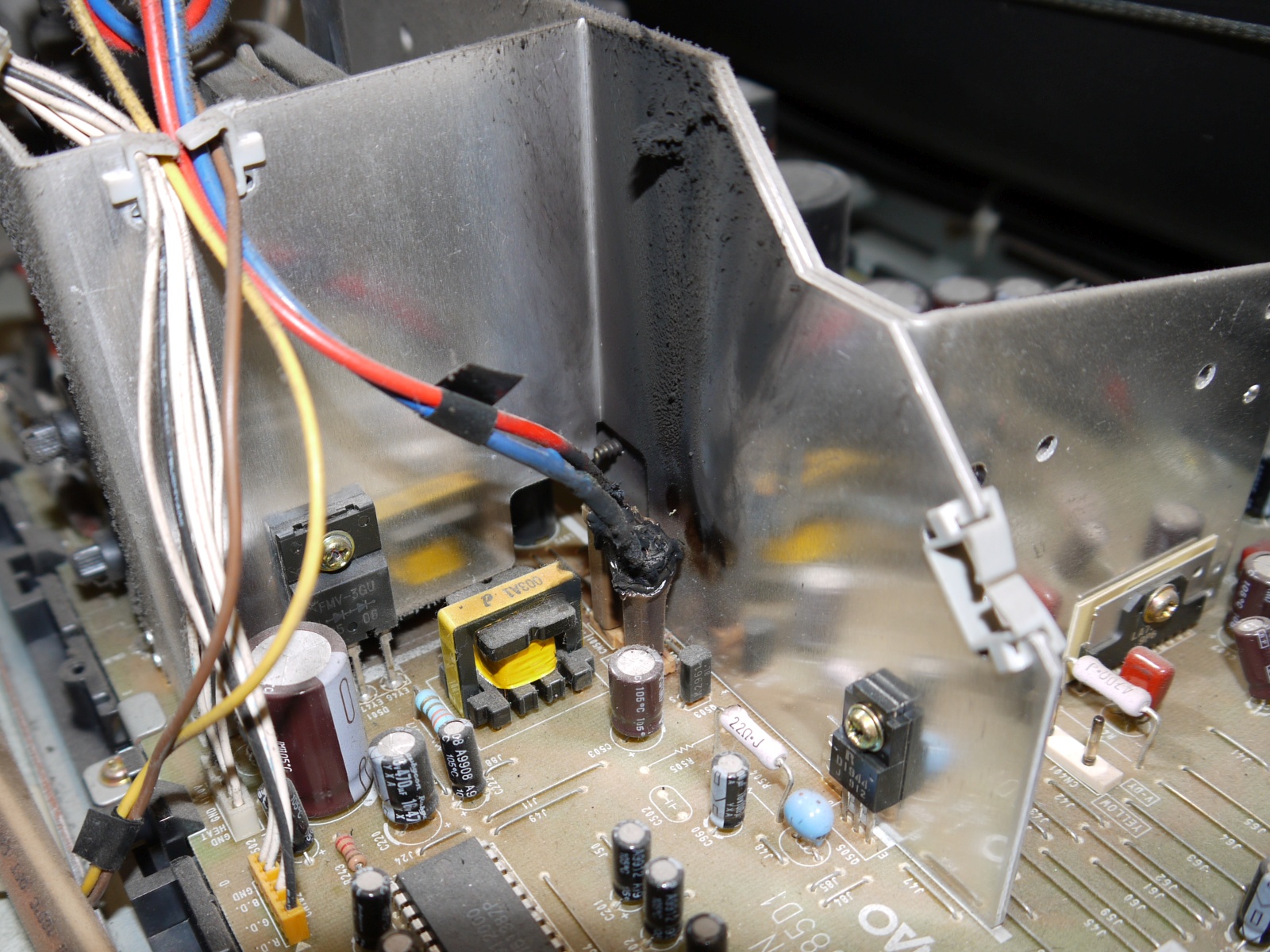

I've had a horizontal yoke connector short and catch fire. It's not something I would play around with.
EDIT: found the pic
EDIT: found the pic
