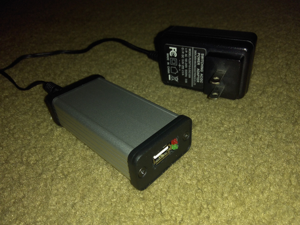

The JVS device is a USB to JVS adapter by Bryan Topp (IO-Buddy USB-to-JVS adapter).

That device USB / JVS looks great. I noticed though that the number of inputs both analog and digital may no be enough for what those games request.

This device was designed for the Naomi.
I was planning to use this with a TTX2 build I am working on, but got another TTX unit up first.
Would also make a great test tool as this is all there is to it:
(There is a USB A port on the rear and the unit contains an integrated USB host controller - add a usb hub and you have multiple player support...)
Its firmware upgradable, so if there is a compatibility issue it could potentially be ironed out...
I know all about the device :)
