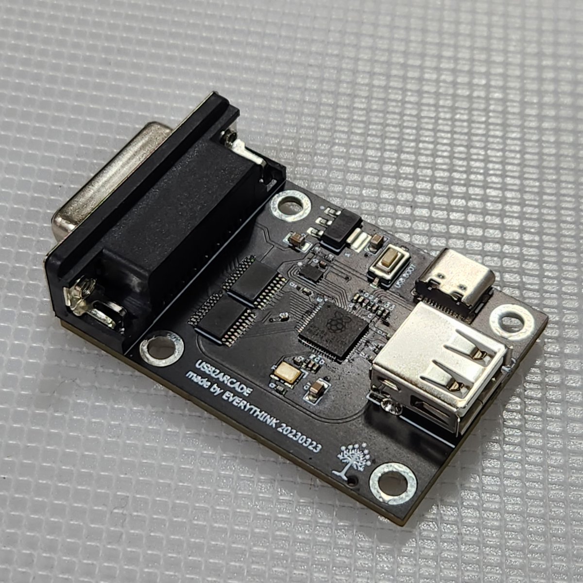

I have several arcade cabinets including Vewlix, Blastcity, Joyro, Bingo & etc. Sometimes I wanted to play in the cabinet with dualshock or xbox con, and USB2DB15 was good solution in that case.
However, making my own converter will allow me to adapt it to future projects, so I started developing it using the USB HOST of RPi Pico and now it is almost finished.
I named it USB2ARCADE.
Because Raspberry Pi Pico is very large, I designed PCB and built in lever converter. Of course I'll design case fit this board.
Current version works with XB360/XBOne/XBSeries controllers and Dualshock3/4 and some other joystick encoders. Unfortunately, Dualsense is not recognized :(
I think USB2DB15 still has beter compatibility!! :)
May I know if USB2ARCADE would take the USB signal from KVM that connects to zero-deley arcade stick and a USB HID so I can use either anytime I want?
