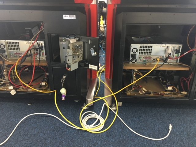

I haven't had a chance to try networking them together, but running from a single TTX2 worked nicely. Each cab had its own Fast IO and RFID card reader. DVI connected from each port of the graphics card, Fast IOs connected from each port on the PCI card, with the RFID card readers daisy chained TTX2 --> RFID1 --> RFID2 via a MiniUSB to MiniUSB cable. The setup detected everything nicely, and each cab worked independently from it's own coin slot and card reader.
______Fast IO 1____Vewlix1
TTX2--------RFID1-------RFID2
|_____Fast IO 2_____Vewlix2
Interesting note - USFIV would not work without both RFID readers connected, other games like Akai Katana, SFZ3 and 3rd Strike worked fine with only one RFID reader connected.
Got round to trying a 'Linked Match' / 'Event-Group' setup, which worked nicely just using a standard router that assigns the two X2's with an IP address.
Both X2's need their own Fast IO and RFID
Set 'Vewlix 1' to:
Set 'Vewlix 2' to:
Both then wait for each other to connect.
They then work independently of each other...
...until people join in

I tried that, but it didn't work. The IP address just sat at 0.0.0.0 on both cabs.
That's my little white Xover cable discarded on the floor after I couldn't get it to work! ?(
Sounds like I missed the static IP setting, as they relied on DHCP to assign an IP.
I really wish the crossover requirement meme would die a fiery death. Completely unnecessary.
Static IPs is likely the issue.
