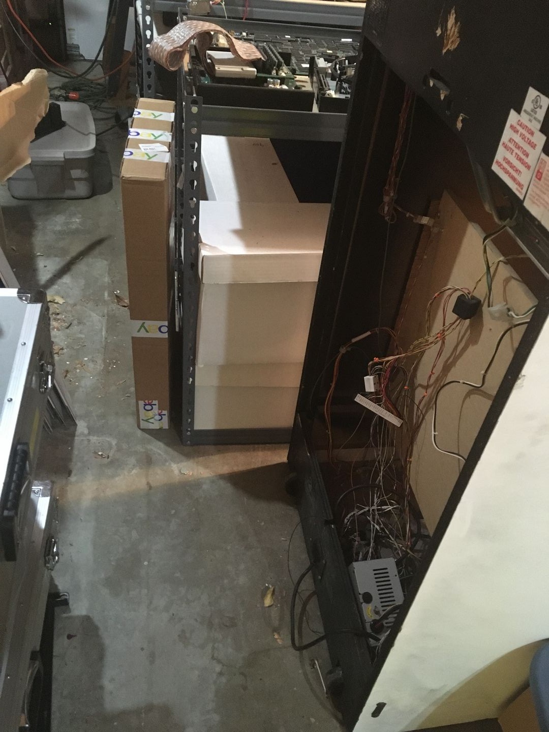

Finally make a Primal Rage 2 cabinet. Primal Rage 2 was going to use a Killer Instinct / Skins / War etc type cabinet with a Killer Instinct panel. A friend donated a Skins cabinet, so I have somewhere to start. This will probably be a little slow mainly due to the difficulty of securing high quality art.
Items that I have/done so far:
  1. Correct Killer Instinct control panel

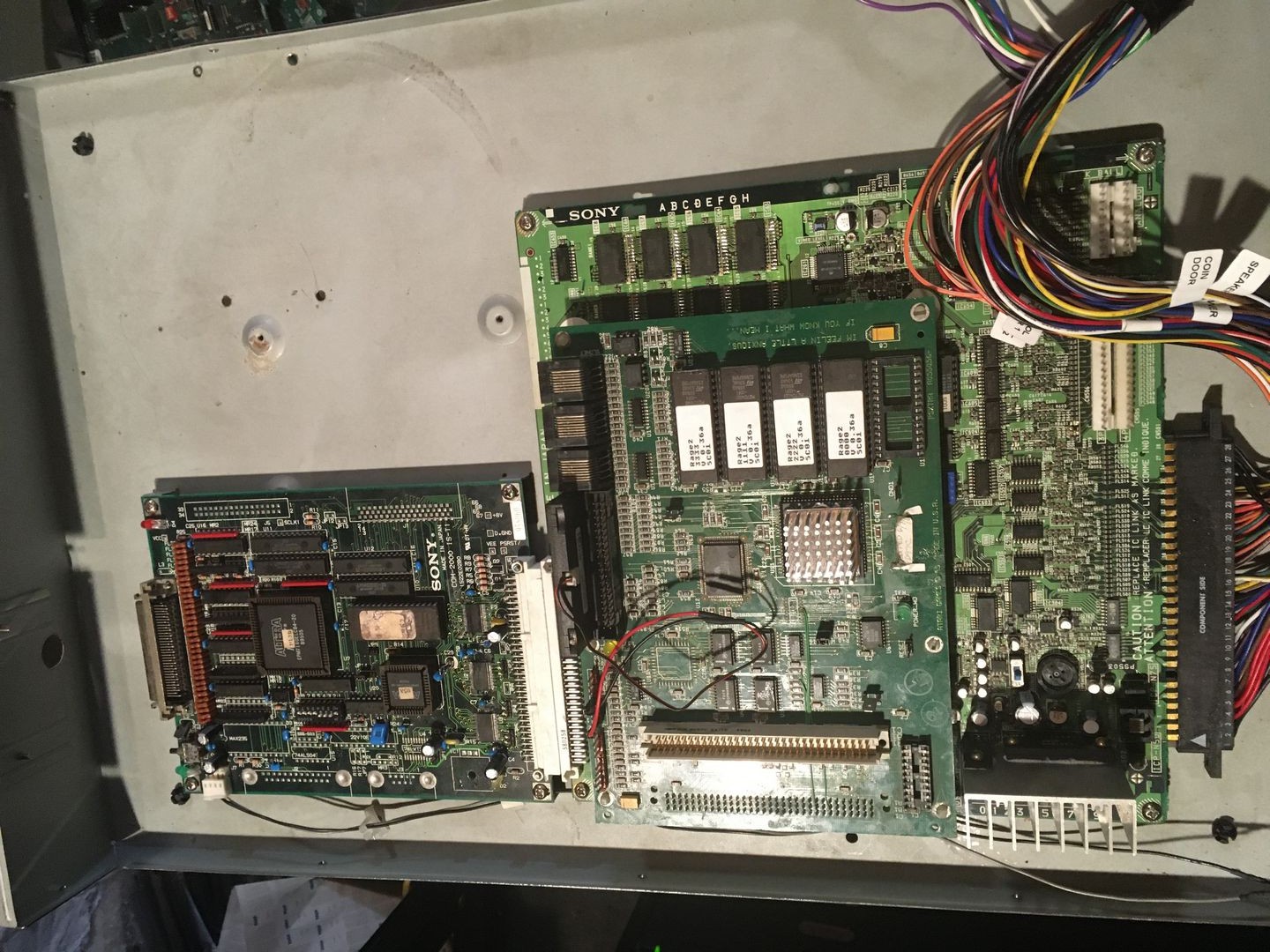

  2. Repaired the main Primal Rage 2 board, recapped both boards, switched the HDD to a solid state Disk on Module
  3. Correct color buttons/joysticks
  4. Recapped power supply

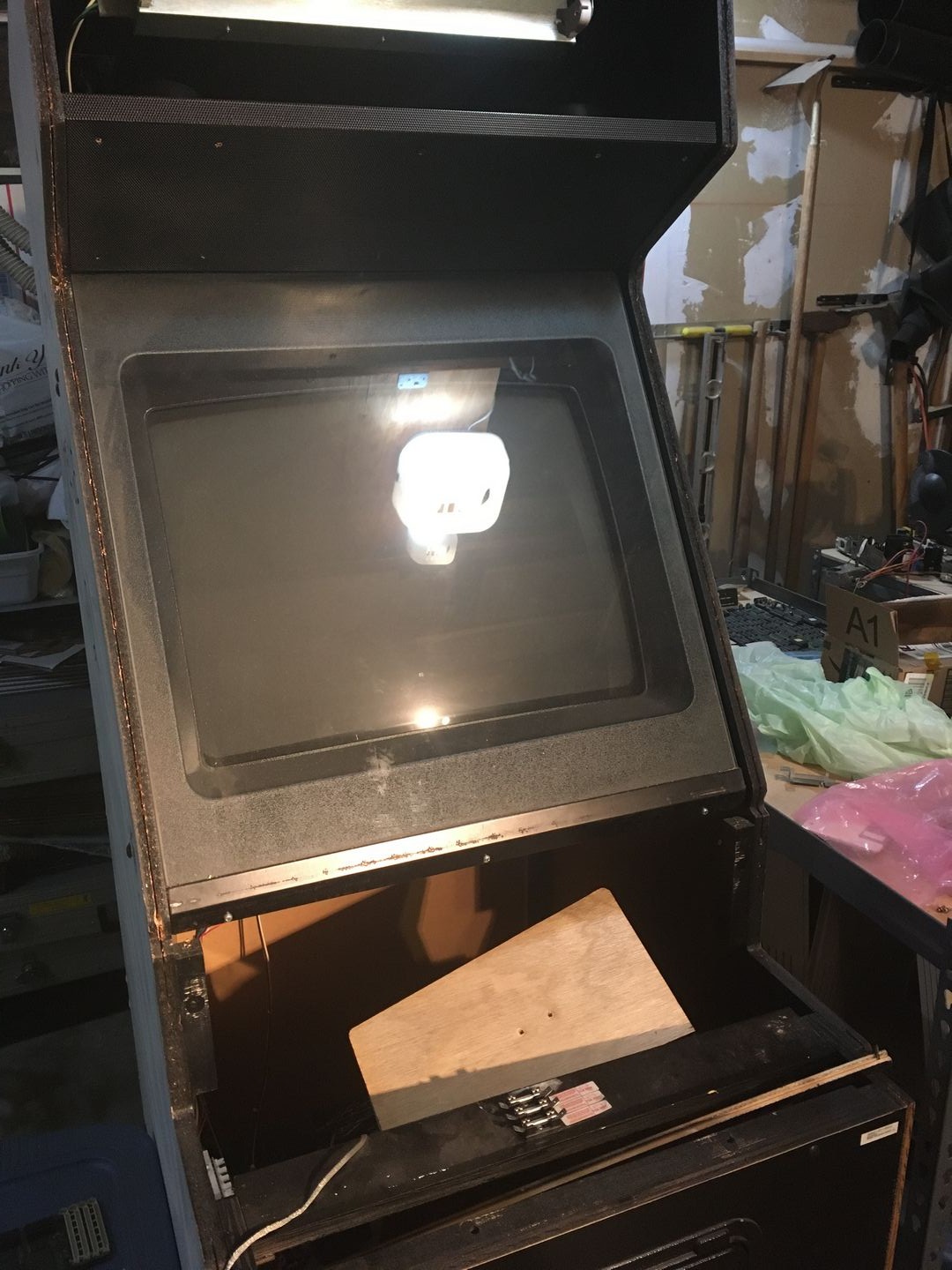

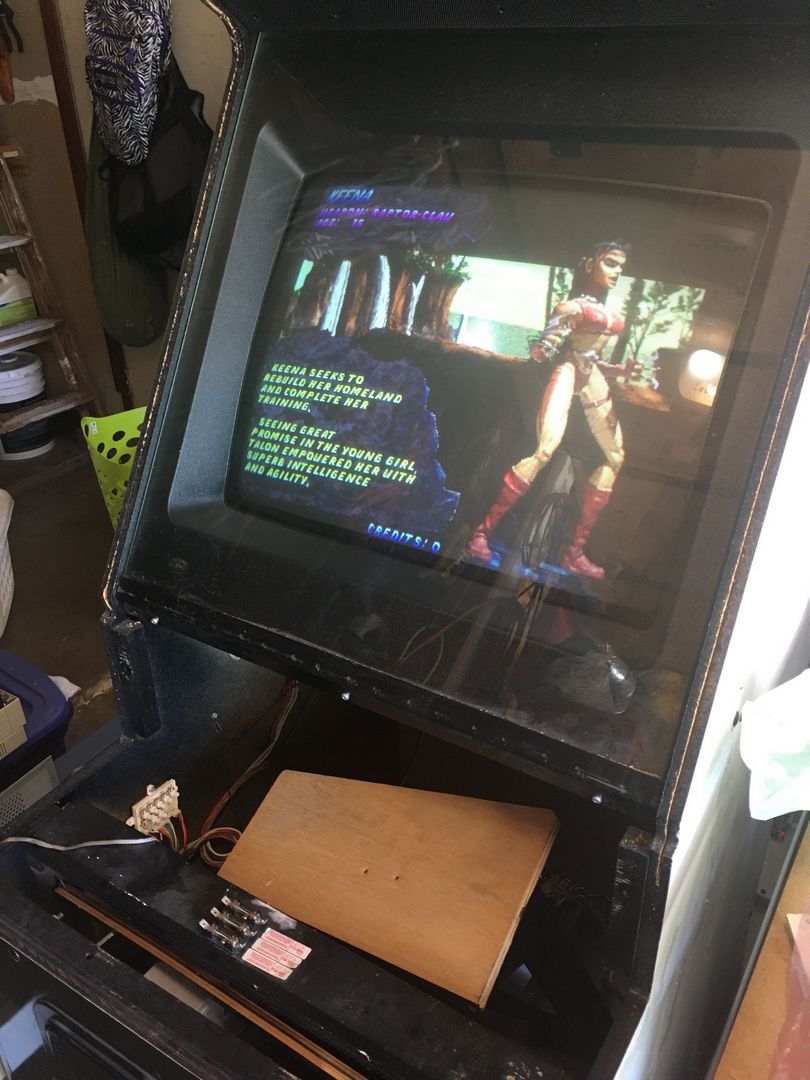

  5. Working monitor with a recapped chassis
  6. Took off all the Skins/War art
  7. Replaced speakers
Things to do:
  1. Secure Primal Rage 2 art (oh boy)
  2. Wire up everything
  3. Buy a plastic cover for the panel

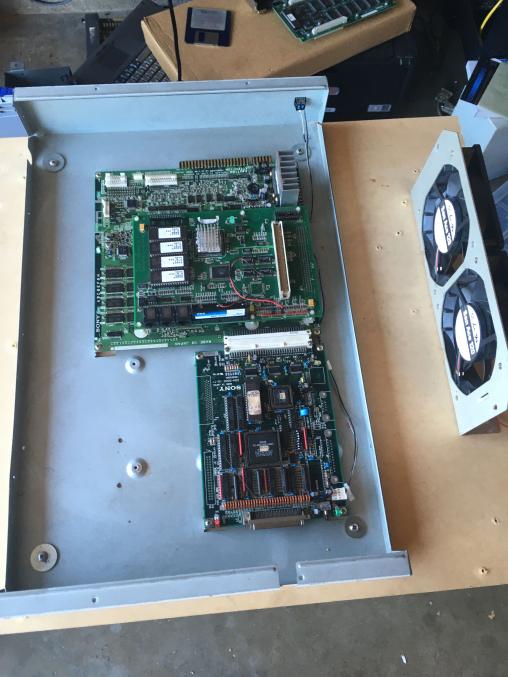

Attached the PCB case to the board inside the cabinet and also added 2 fans on it to push some air. There's a top for the PCB case and I'll keep the top, but it limits air flow and it's hard to service the PCB when there's a million screws to take off.
