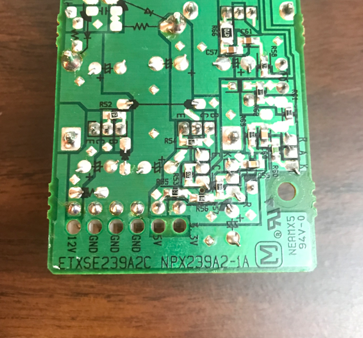

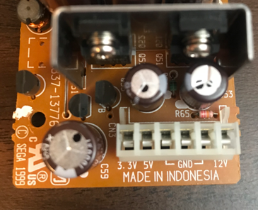

Hi everyone, I'd like to check with more knowledgeable people here about my plan to use my Dreamcast PSU for my Naomi so I don't blow anything up. The Naomi won't be in a JAMMA cab or be using any I/O board that passes along power, so the Dreamcast PSU will be purely powering the Naomi directly.
I found the power pins on the Dreamcast PSU. Should I desolder and remove the white connector? Or is it okay to just solder the wire from the underside into the connector pins?
Here's my wiring plan. I'm planning to use 18AWG wire. It's okay to solder 2 wires together from the same pin on the Dreamcast PSU, right? Will it negatively affect power flow?

Little update: I desoldered the white terminal block from the PCB and found that the through holes on the PCB are way too small to fit an 18 gauge wire through, much less two twisted together. Does anyone have experience or ideas about soldering on a different terminal block to fit 18 AWG wire?
I'm thinking I can find a screw terminal block for wires on mouser or digikey.
I did this with a broken Dreamcast I had, someone else here I believe has run it before. It does the job but only downside is you can't adjust voltages. I used the pins from the DC shell, I believe lemonyvengeance could make a custom harness also.

Arguably you could solder them to the white block pins.

Thanks for the replies, everyone. I'll just solder the white connector block back on and try soldering the wires to the provided pins, even though they're intended for metal rails.
I think I'll end up getting a Meanwell or an ATX, though, because I honestly don't know how safe or sustainable using the Dreamcast PSU in this way is. I'm concerned about creating bad solder joints that have air gaps and whatnot which might cause overheating (if I understand correctly).
I'll at least post back if I get the Dreamcast PSU working.
