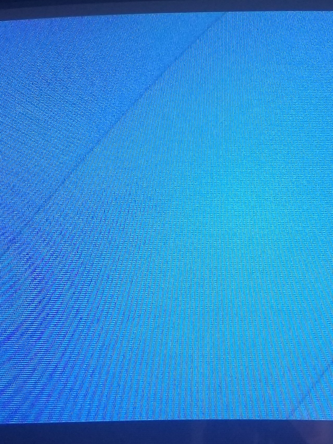

The 1st picture is the screen i get with some of the latest rom pack games.

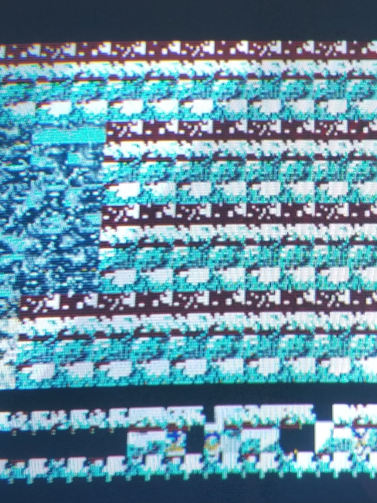

2nd image is what i see, when flashing a rom.

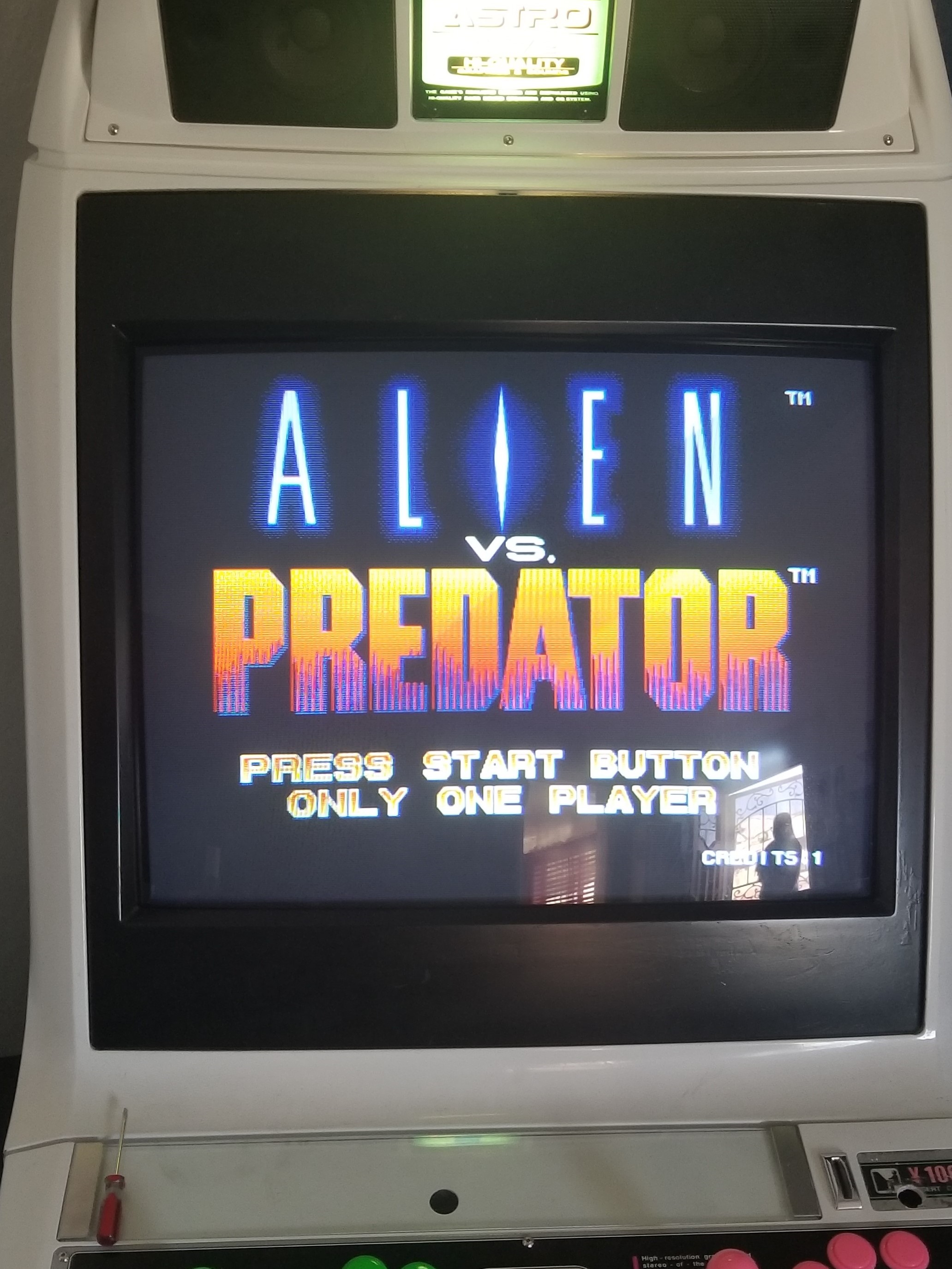

3rd is image after the flash process end and " have fun"

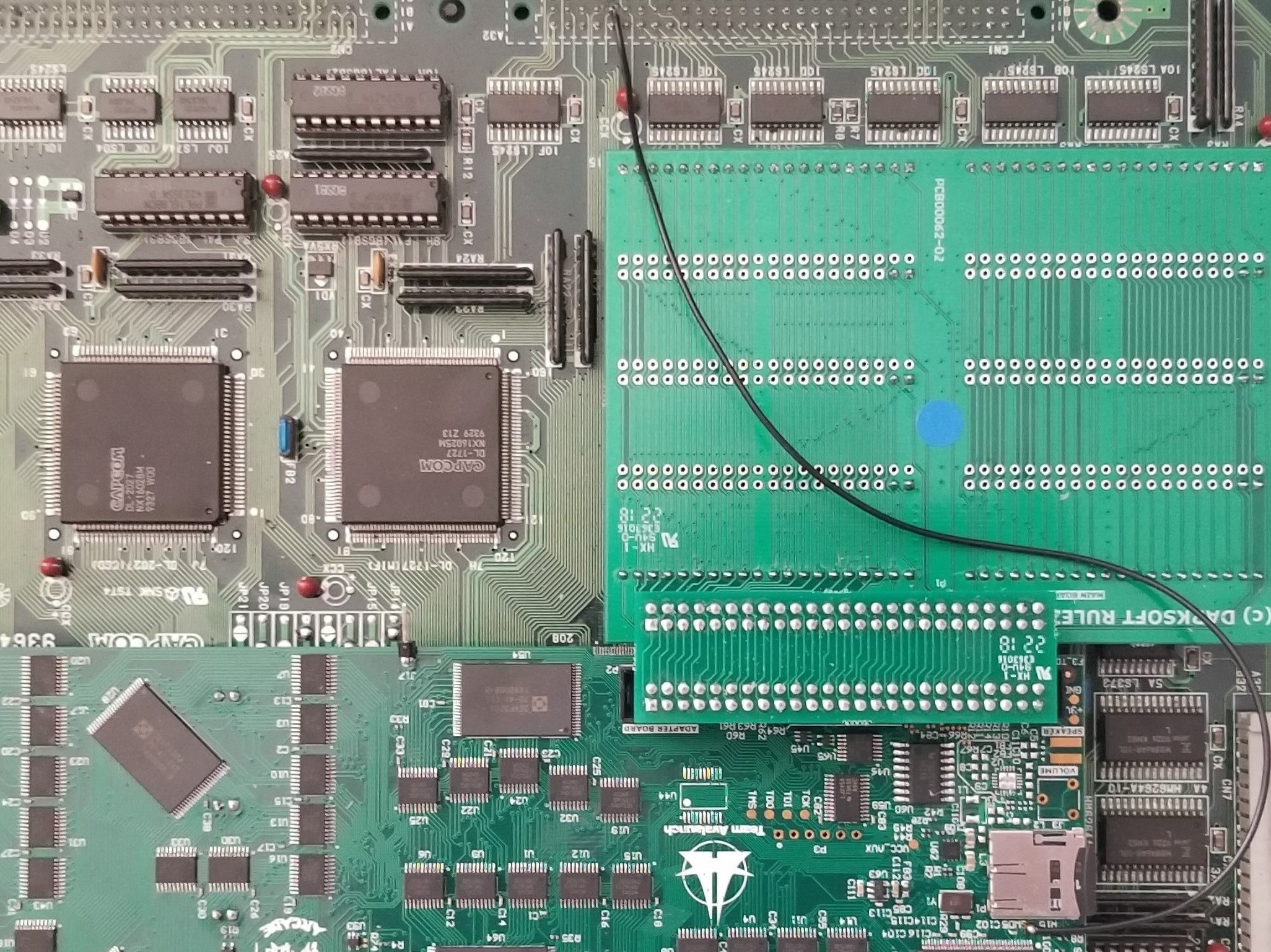

4th image is screenshot to show that proof that the rom fires up (sometimes experienced jail bar graphical lines) (improved with proper seating of board)

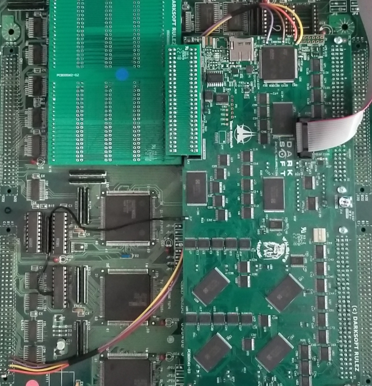

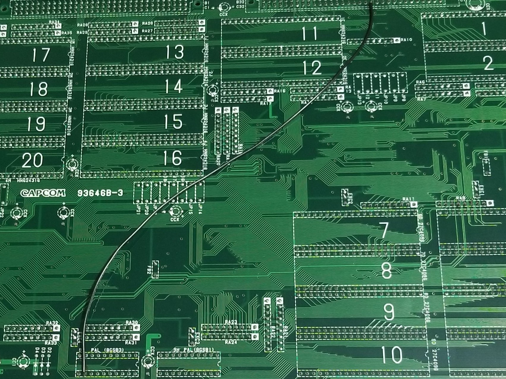

Pictures of my Dark Soft board. (had crop down due to 1mb max file size, can provide better full pictures if needed)

Here are some things for you to look at :)
- You do not have key writing wires installed
- You are definitely not running the latest ROM pack if you don't have key writing wires installed
- The jumper wire for PAL F needs to have the IC leg lifted out of the socket, a jumper wire on the bottom of the board like you have will not work properly (this will be causing your sound and other issues)
Jailbars are generally caused by boards not seated correctly but it sounds like you fixed that already
You need to install the key writing wires, use the correct ROM roll up pack and correctly jumper the PAL and you should be fine
also hat the pal issue. the guide is really confusing there.
also use multimeter and be 100% sure about all the jumpers.

Remove the wire from the bottom of the pcb.
Remove pin 7 of the PAL from the socket and connect a wire between pin 7 and J15 on the main multi pcb.

Sounds like you haven't installed the bodge wire on your F PAL. You need to either do that or replace with a G PAL
Looking back I see you had the wire connected on the bottom of the board, you need to remove the pin from the socket and solder too that, not the pin on the bottom of the board
I helped work on this game, the pin on the F PAL was lifted and the wire run. In theory that shouldn't be the problem, titanren12 post a pic of what we did, maybe someone will spot a mistake.
Chipmunk sound is the PAL, the pictures are very cropped so I can't see the installation. Is pin 7 connected to CN3 C13 or J17 of the multi?
If it's connected to the board, maybe try connection to the multi pin instead.
Also make sure it's pin 7 you've jumpered, not pin 9. Pin 9 is G PAL wire for rev 3/4
Can we get the pictures uploaded resized rather than cropped?
I don't remember now, but it's the 'cheater' spot on the multi that lets you run the shorter distance, whichever that is.
Those pics are out of date, he needs to take new ones of the F PAL fix.
My board is an older revision, and a G PAL, so I can't look at mine for reference.
