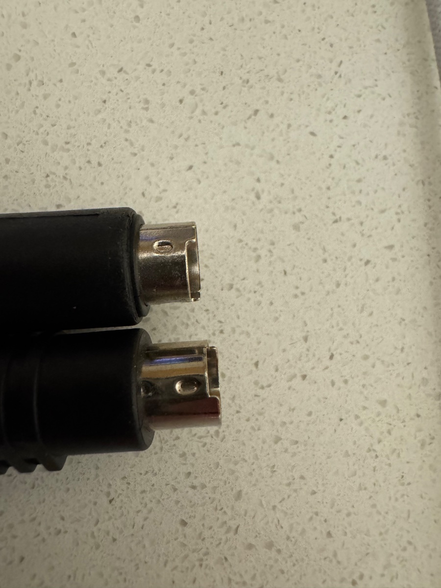

So I plugged in the new cable again for giggles and it suddenly worked on both sticks.
Then I tried out one of the old cables and it didn't work.
Plugged in the new cable again and it doesn't work on both sticks again.
Fuck me...
Hey guess what........now the new cable wants to work again. Just going to trash the old cables because maybe something with them is the culprit. That is unless somebody wants to take a look at them for giggles; I'll ship them to you free of charge. After the tantrum I just went through I'm just going to hit the "I believe" button and be done with it.

Both of the old cables don't work whatever I do.
Just had to add that for anybody else that owns a Turbo ED Pro and is wondering why the hell their stick isn't working on the menu on initial power up. It makes zero sense.
END RESULTS
1) Two possibly bad cables. Remedied with new cable.
2) Turbo ED Pro menu does not receive inputs from Retro Board upon power up, but will after selecting a game via a normal controller. If you exit the game via Everdrive Pro button, then the stick works on the menus. Makes no sense, but yeah, that's whats going on lol

Edit: If somebody wants the cables that weren't working I'll ship them to you free of charge in USA. Just post your findings on this thread. Like I said, they worked fine for years, so I don't know what is wrong with them. Will trash in seven days after this posting if no takers. I could definitely fix them, but I got pretty heated over this and just want to be done with it lol.
I got a taker for the broken cables. They can keep them; all I asked is that results are posted here.
I was going to suggest soldering a new RJ-45 Cable or something
Or even using a multi meter to test continuity first with a break out RJ45 adapter
