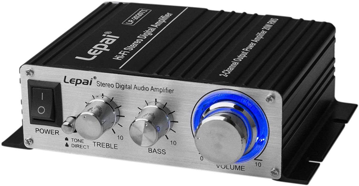

The Chewlixes come with those Lepai clones like this:
I bet literally this exact model would be fine.
https://www.amazon.com/Lepai-LP-2020TI-Instruments-TPA3118-Amplifier/dp/B071FJF4FF
