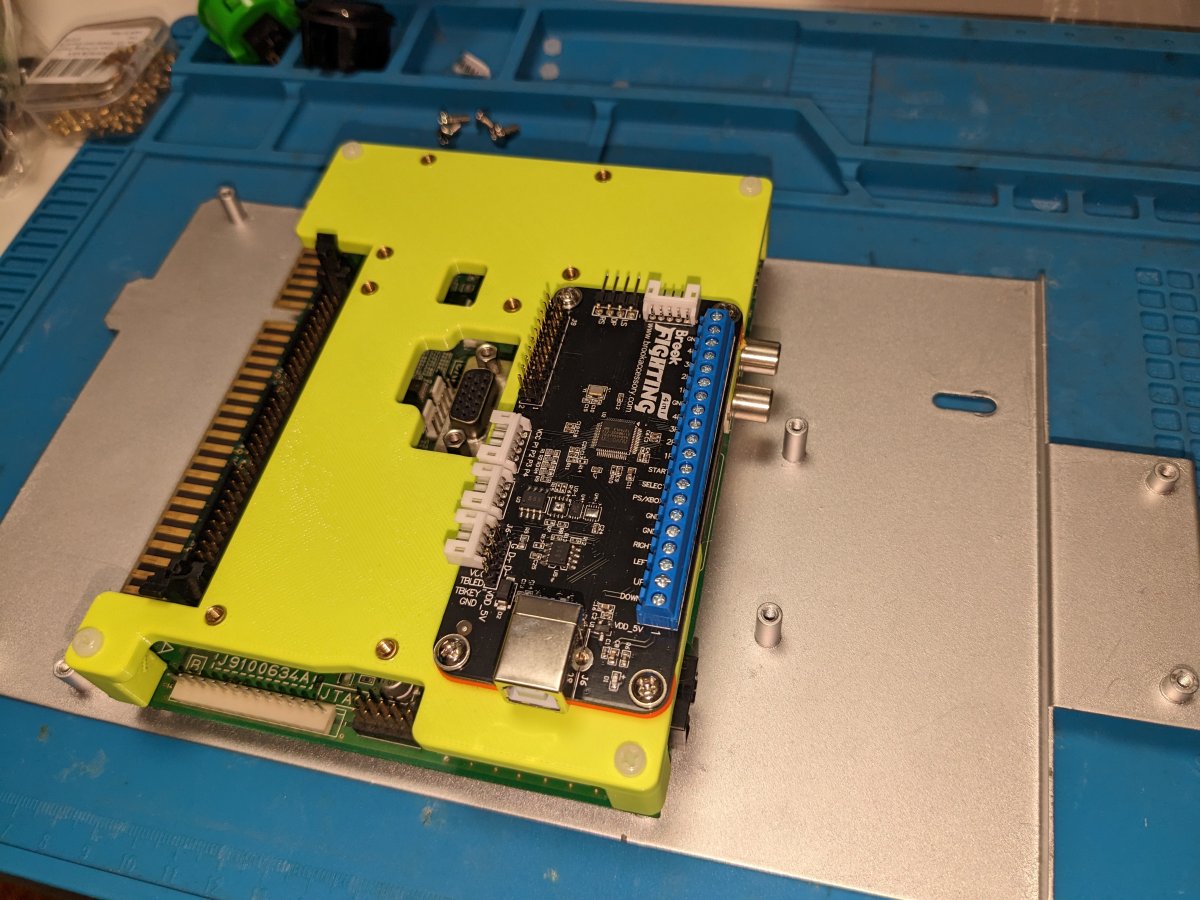

You can also keep the fast io in at the same time with Franco's brackets:
https://www.arcade-projects.com/threads/taito-vewlix-brook-ufb-jvs-pac2-mounts.21884/

I've been designing a bootleg "Vewlix console io" replacement PCB but I don't really think it's worth it. Franco's bracket solves keeping the card reader lit up (by leaving one of the stock IOs in place) and physically mounting the brook boards.
I'm printing one of Franco's brackets right now and I'm gonna make the wiring harnesses later. I'll post up results when I'm finished.

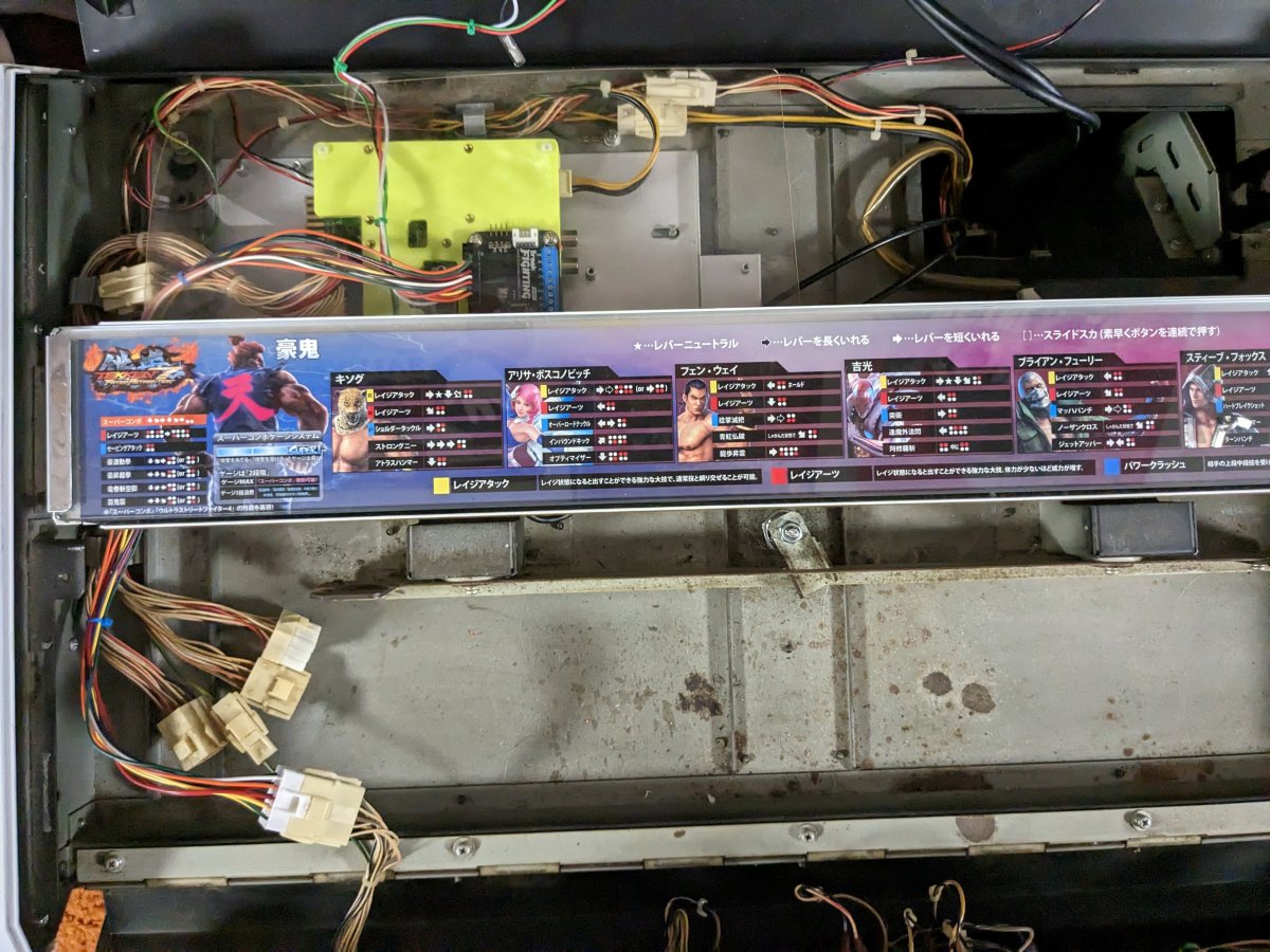

I went and printed one of Franco's mounts and made a harness. My only pro tip would be that if you have an F, it's a good idea to flip the brook boards around the other way. The 20 pin harness really has to get shoved under the light box otherwise. Also if you have an extra button panel it's a tight fit, especially if you still have the spill guard in place. I recommend using short buttons like Hori Hayabusa or even better, Seimitsu PS-15.
