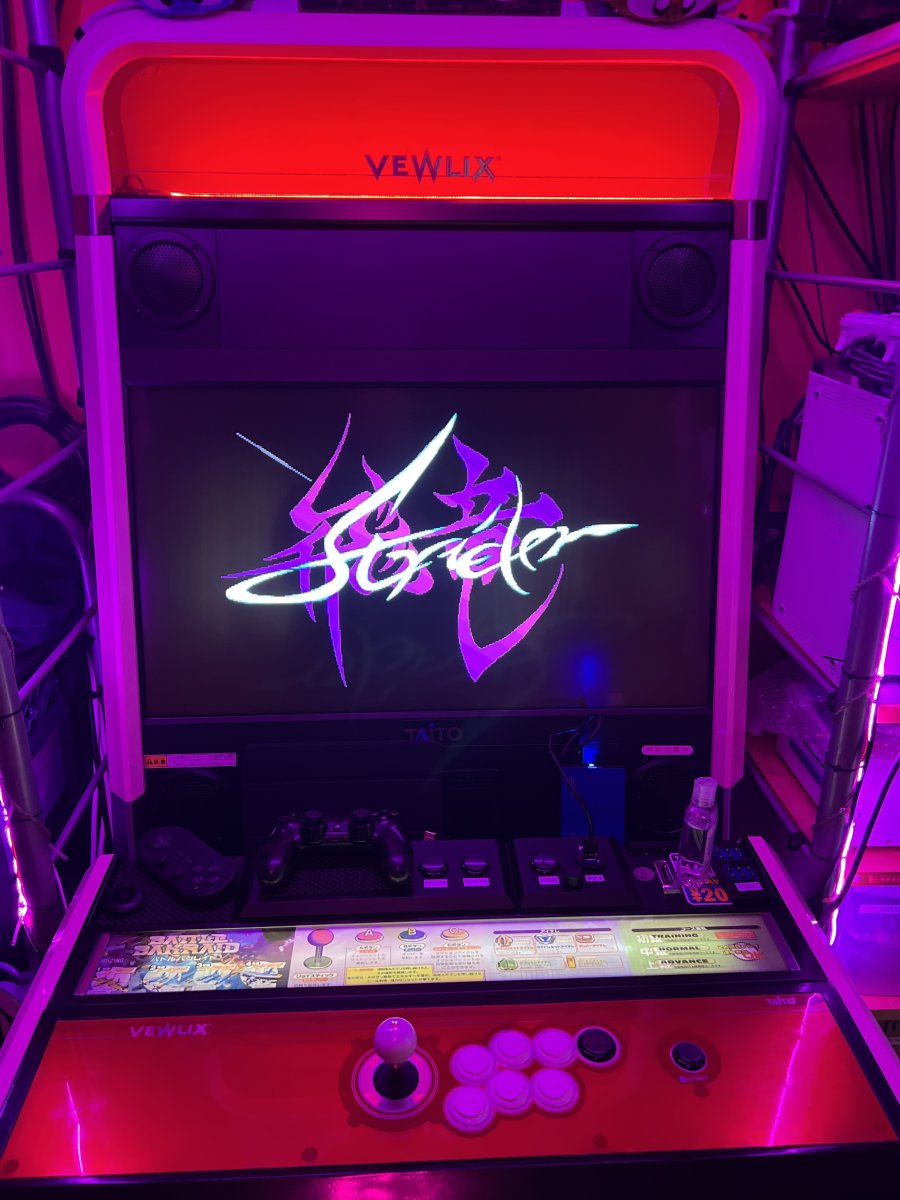

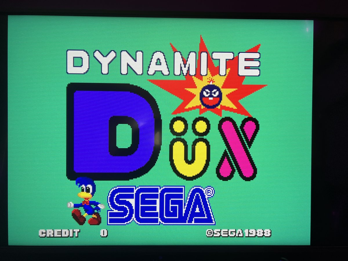

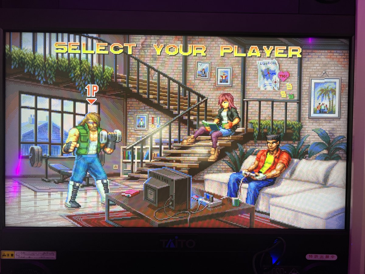

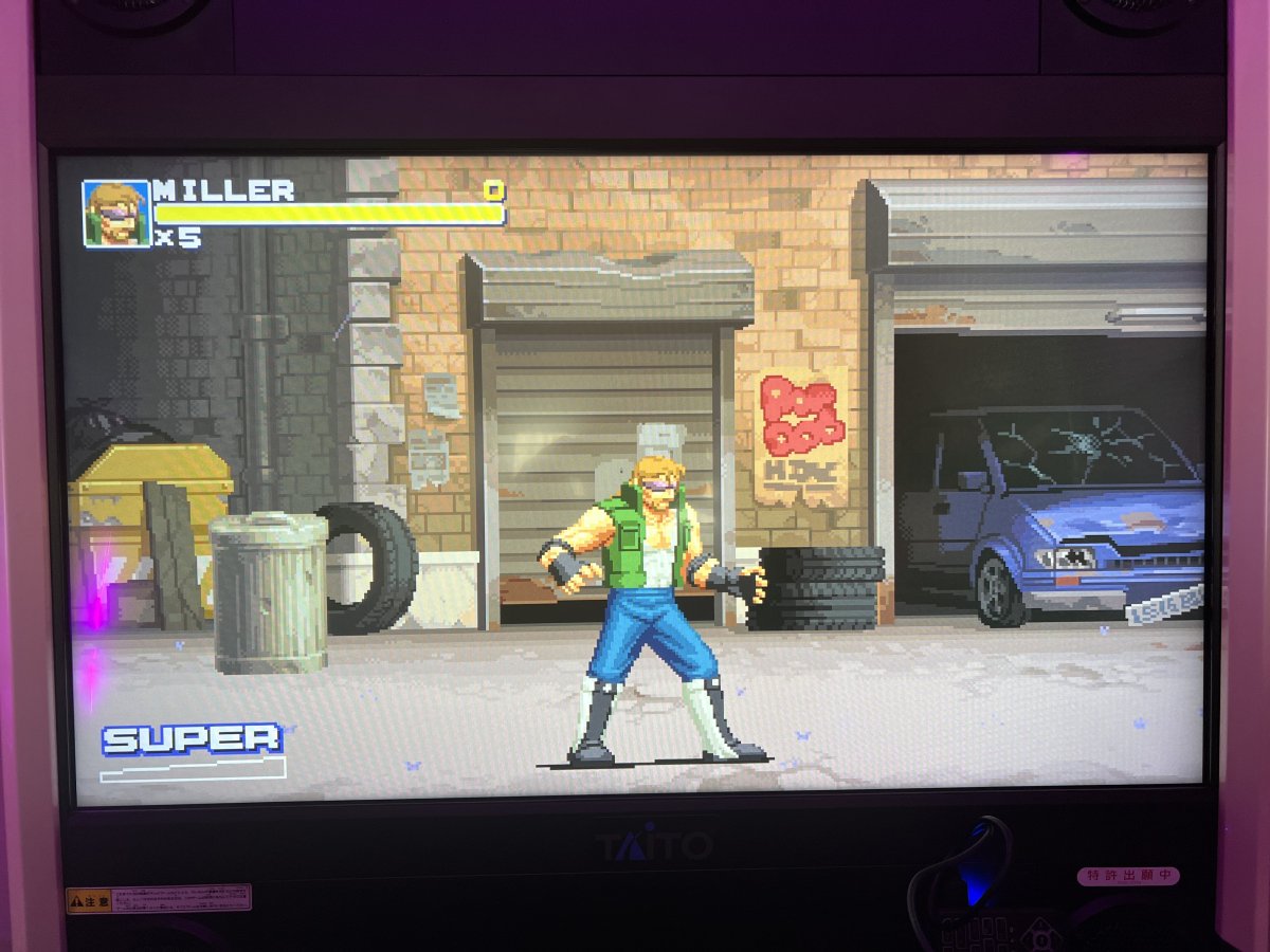

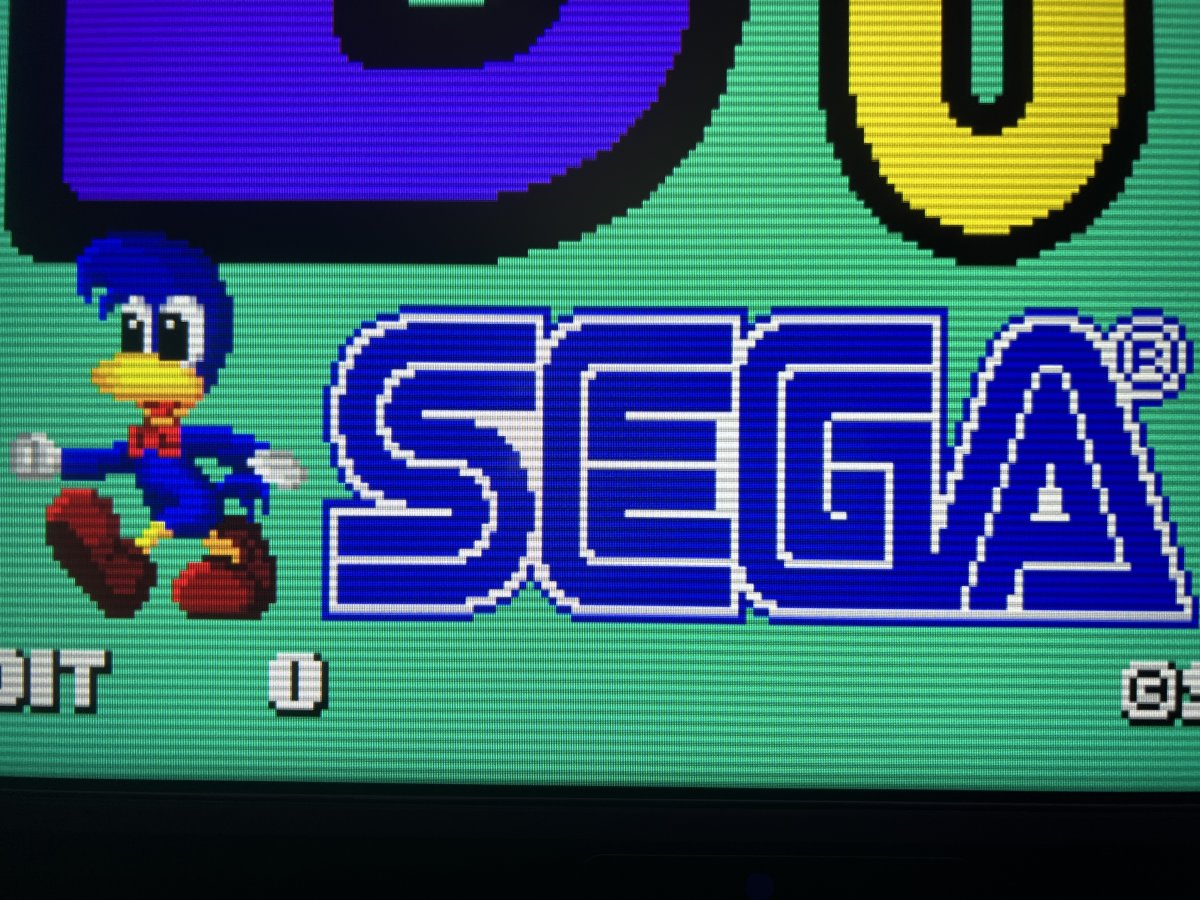

Tuna sashemie
Aug 25, 2016
15
6
Here you
