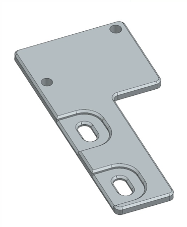

One other thing to note, I sent a Vewlix kit out to @wonderbanana to test for me and the screws just grazed his coin chute. No one else who I've sent these out too has reported this so far but just to be on the safe side I've redesigned the Vewlix mount to give a little extra vertical clearance for the screws.
I've binned about 20 I had already printed and I've replaced them with this version which will go out with any orders left to ship. If anyone else has a droopy chute (:D) and has issues then let me know and I'll send you one of these mounts out.

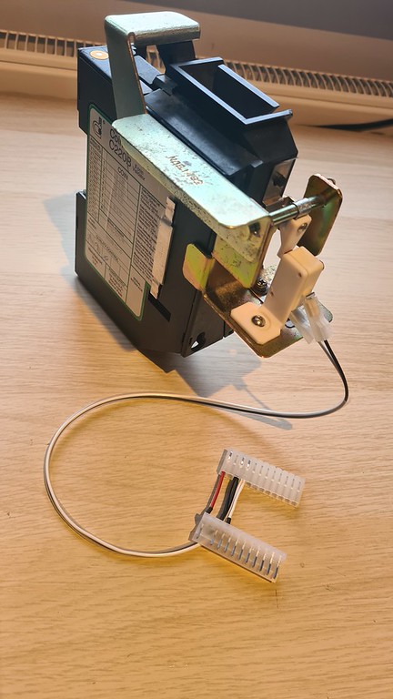

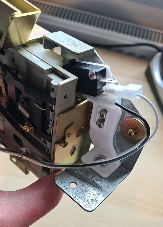

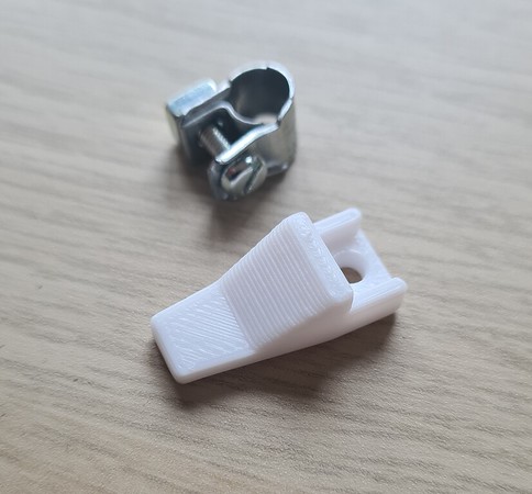

There wasn't anything to use to actuate the microswitch so I made a lever from a mini hose clip and a printed part.
This is a digital mech and so I've made a passthough adapter to plug into the side of the Excel or Klingon credit board, this needs testing but it should work.
I've wired up 12v, GND and Coin, I've been looking at other pinouts since and I just need to add the coin counter pass though wires too.
If anyone with a working coin mech wants to test this out then let me know ^^

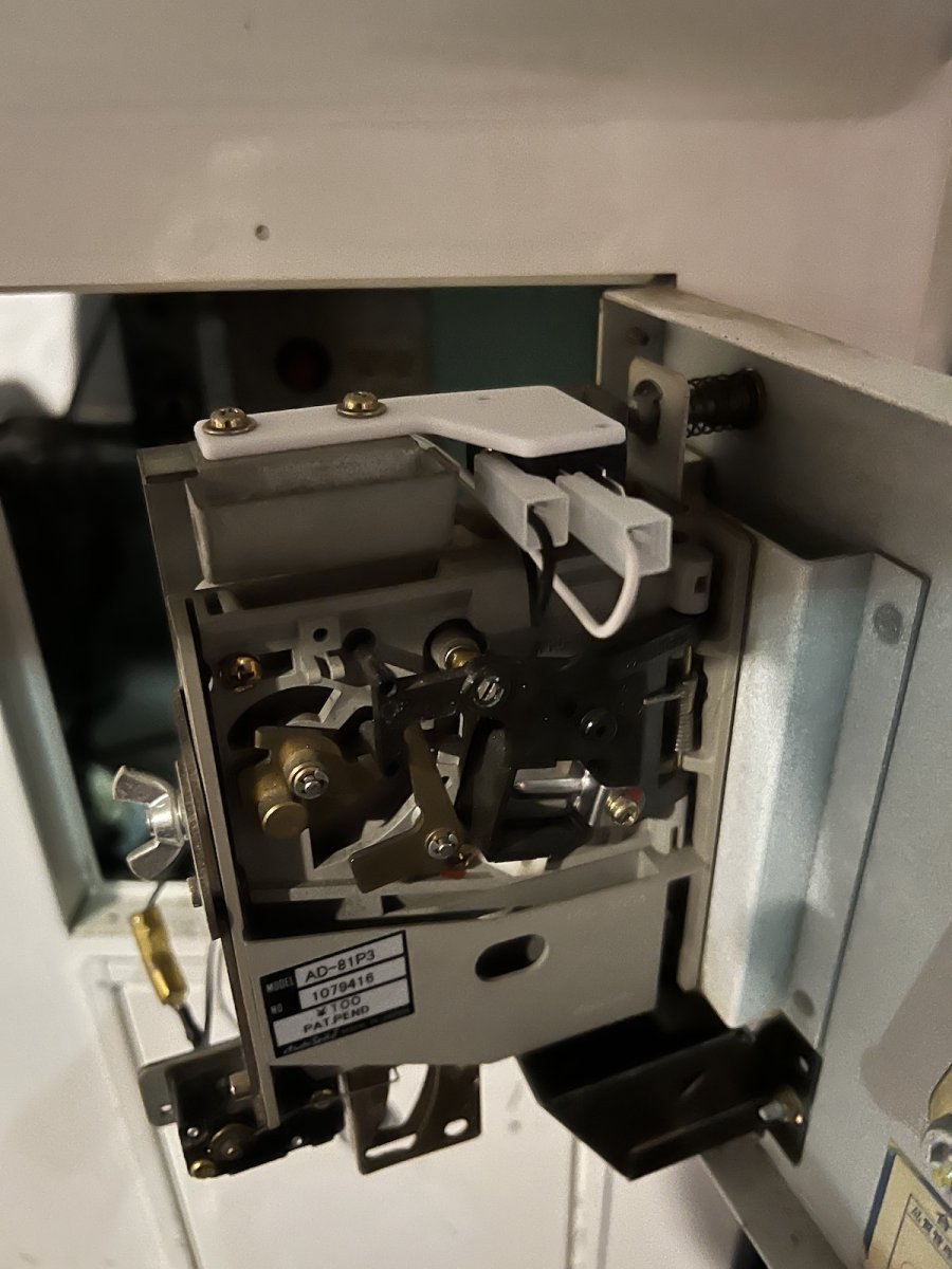

I just finished installing these in my AWSD and 2xAC and they fit and work wonderfully. Very happy with them. Great work @FrancoB and thanks for sharing this with the community.
Thanks for the feedback both of you. Glad to hear they're working well for you. I've added some adjustment into all of the kits but you never know quite how tightly toleranced some of the cab assemblies are but (touch wood) they all seem to be fitting well on peoples cabs. :thumbup:

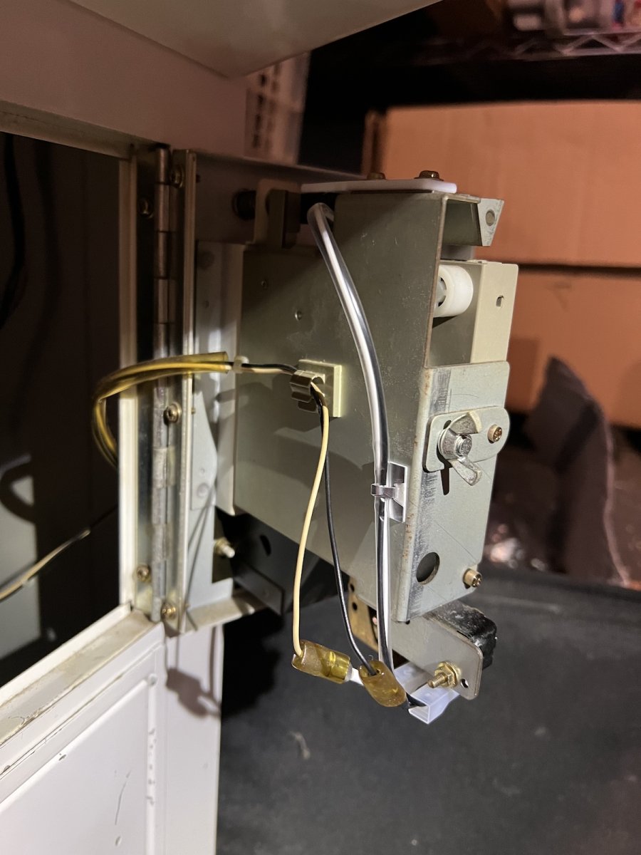

Got these today and installed into my Astro, Blast and Vewlix cabs. The install is dumb simple and took a few minutes per cab. This is such a simple idea, but is executed to beautiful perfection! FrancoB even includes zip ties and wire clips in the bag so you can make a nice, clean install. The result is a 100% stealth coin insert using the coin reject button. Freakin' brilliant! Thanks FrancoB!

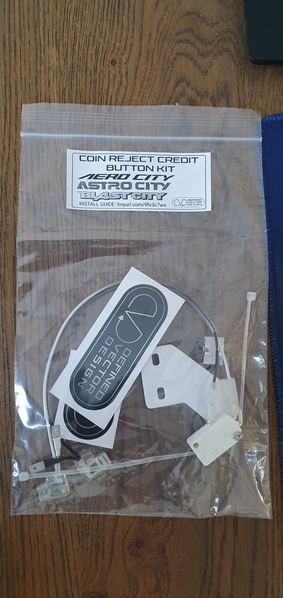

Got mine in just now! Damn customs delay...
Looks professional as always Franco, can't wait to try it out later today :D
So apparently swedish customs like to hold this package forever :x really looking forward to it after seeing everyone’s installed pictures :)
