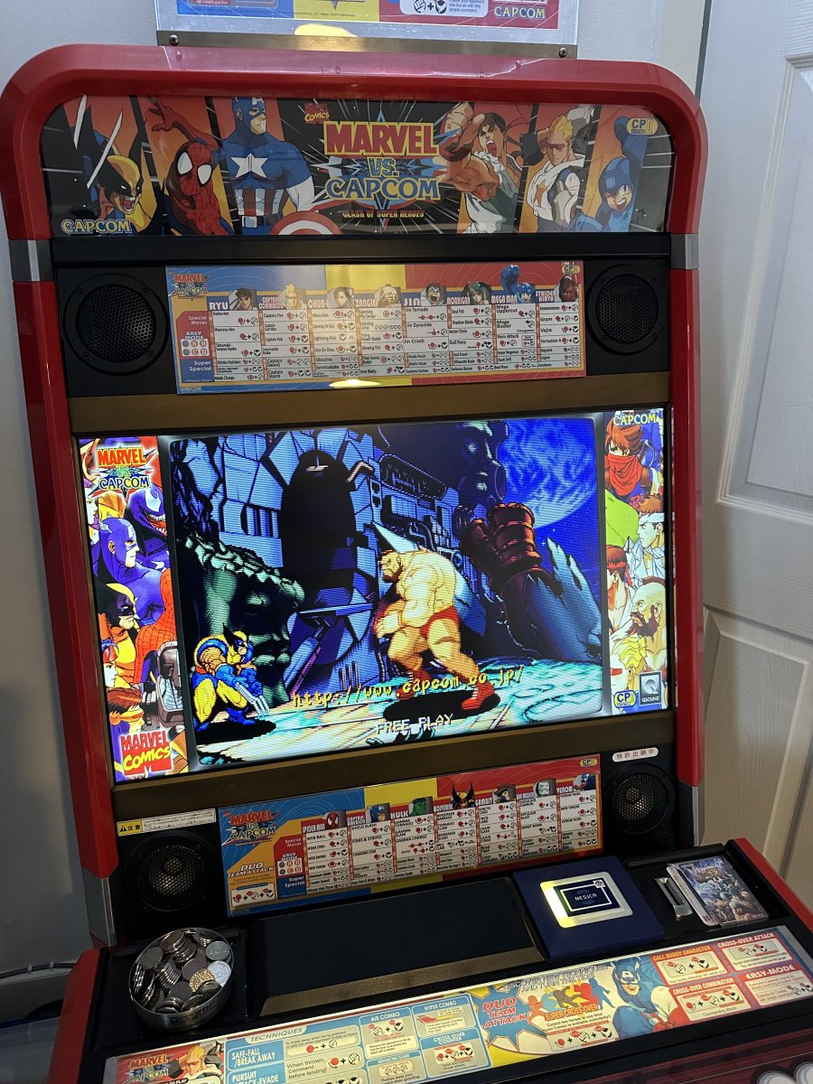

Got mine fitted smooth, it's amazing the difference a new screen makes.
Next on the list is painting the frame .

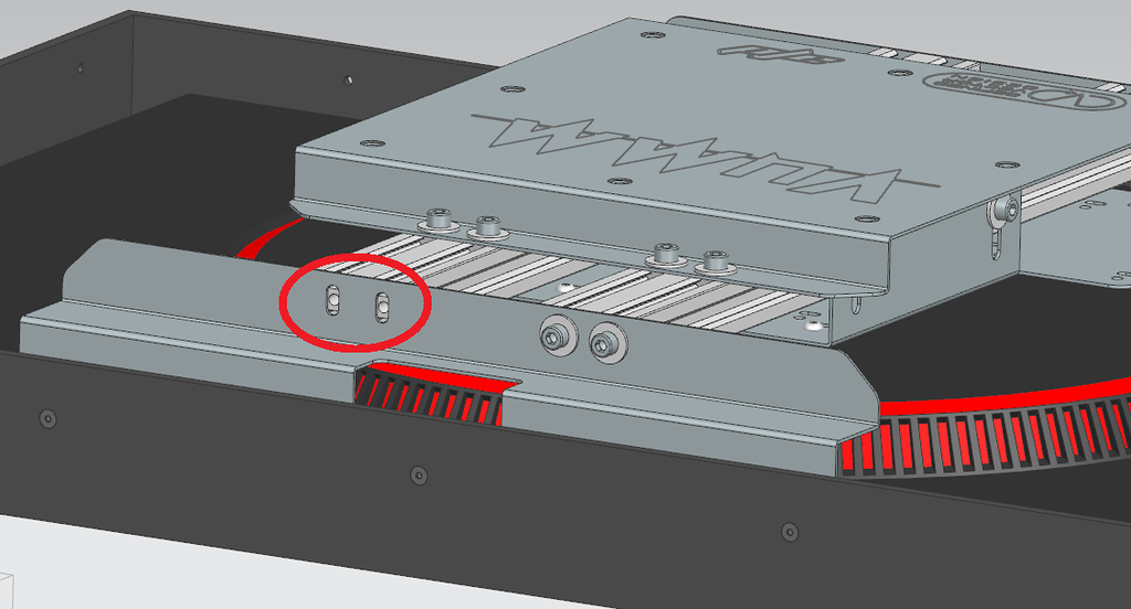

The first thing I'm thinking of doing is to elongate/slot the holes that attach the 2040 section to the end brackets:
All of the fabricated parts are precision pressed/bent and I've made a number of gauges to check that the parts are to spec, this is especially important due to tolerance stack up. All of the kits tested so far bar one have ended up with the monitor being near perfectly flush with the speaker assemblies on the front of the cab. For some reason, the monitor on one of the cabs that was tested on ended up being a couple of mm too short. I know it's not a difference/error in the kits due to the gauges/checking. The only thing I can't control is the accuracy of the cabs/original monitor assemblies and anything that has happened to the cabs since.
Slotting the holes as above would give +/-3mm of adjustment. If the mount is assembled with the 2040 section level with the top of the end brackets then this would be the '0' position. I would recommend assembling like that for a start and then adjusting from there after test fitting but only if required.

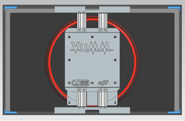

One other thing I wanted to address is the issue of the glass floating around in side the frame on Vewlix C, F and Ls. The glass is bonded to the front of the OEM LCD which holds it in place. The glass is removed from the OEM LCD and placed back into the frame prior to fitting the new display. The glass is approx 22mm shorter and 12mm narrower than the frame it sits in which means the glass can move around radially which isn't ideal. This isnt an issue for the Dia Blues etc as the glass is clamped in place as part of the frame assembly.
I'm thinking about making some ~10mm self adhesive shims/packers to take up the slack between the glass and the frame:
This should stop any radial movement.

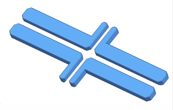

Glass shims:

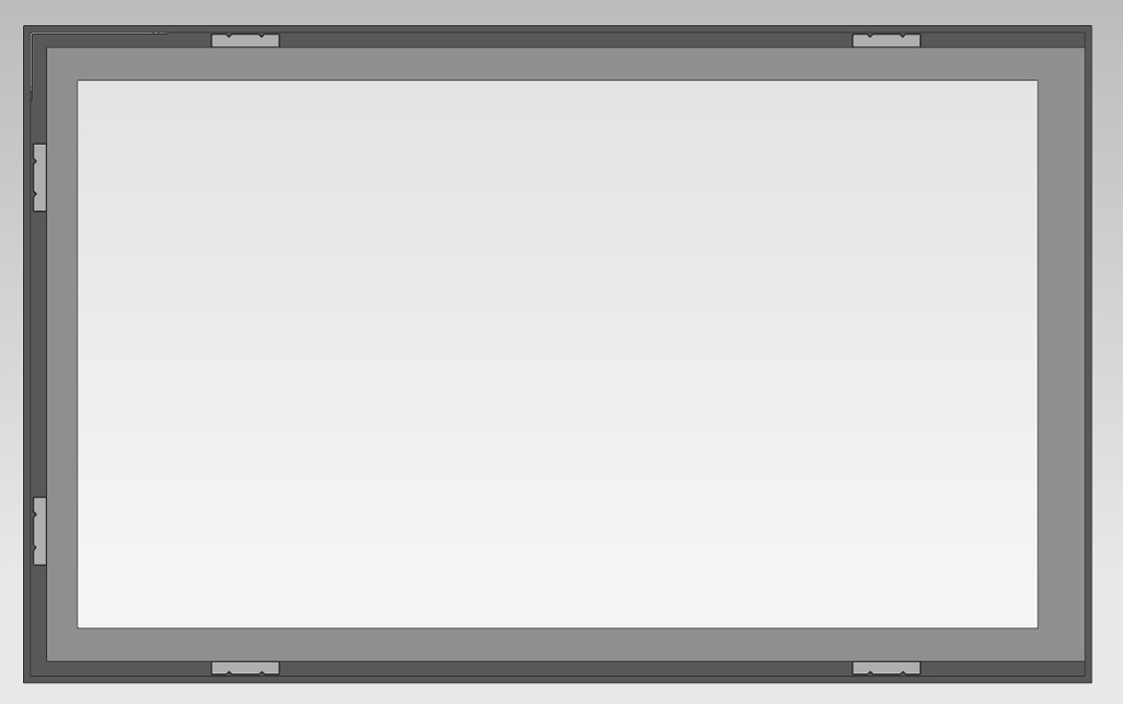

The original plan was to print 6 glass packers and push the glass up to one side as per the post above. I did this because the side shims only need to be a few mm wide and they're not really wide enough to get a decent amount of double sided tape on. Pushing the glass to one side allowed me to use a shim double the width. One friend tested these for me though and he found he has some marks on his glass that were only hidden when the glass was central.
With that in mind I've changed the glass packers to be L shaped which should still allow them to be adhered in position but the shorter legs should now hold the glass centrally:
I've sent a set out of those out for testing and I'm waiting on feedback from those.

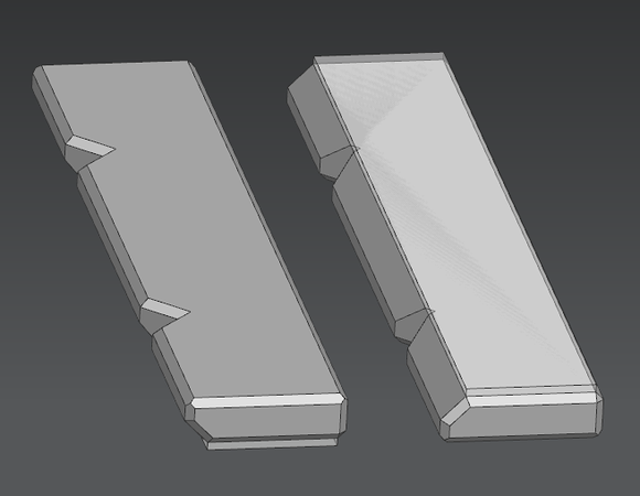

I got only one thing I would change:
the glass packers should have more height (for the loose glass frames).
When I put the monitor upright for testing, the monitor did not have enough pressure to keep the glass fully down and the glass slipped over a packer.

Thanks for the info on the glass packers. I originally made them 3.3mm thick and used 0.5mm thick adhesive which gives a total of 3.8mm and is just under the 4mm glass height. I don't really want them to protrude above the glass in case there is clearance issues with the replacement display fouling on them. I think what's happening is that the OEM foam between the frame and the glass is a couple of mm thick and so ideally I think the packers need to be a couple of mm taller too if the packers are fitted to the frame and not the foam. I just need to check that the thicker packers won't then foul on the underside of the corner brackets if someone installs one/some of them right in the corners. I might take a couple of mm off the bottom of the corner brackets to be on the safe side.
