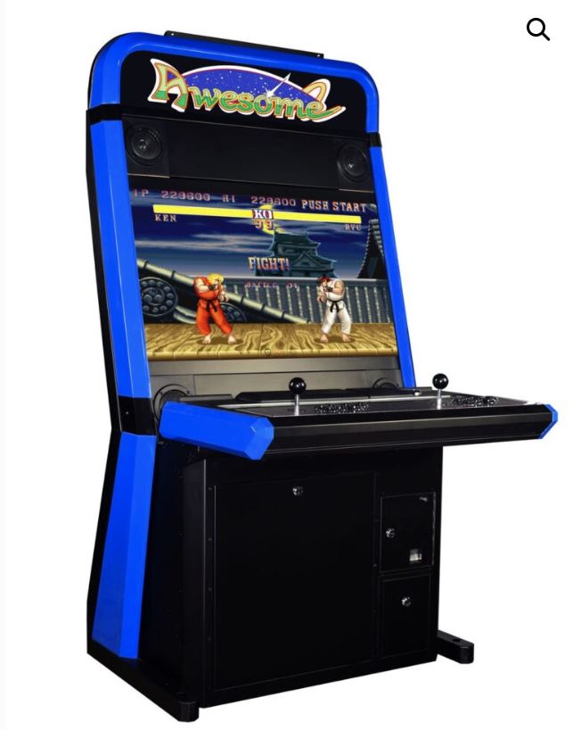

Thank you for the response. Here are two photos of the left-right lower left panels (not doors, but the colored framing). The 3rd photo is from the sales site, not my actual machine. But that's exactly what it looks like.
Well that is relatively good news! Much better than frame damage especially since they are sending you replacements and these pieces are definitely able to be swapped out without to much fuss. That seems like a Vewlix clone and I know there are a number but from some quick googling it seems the clones can be easier to swap the monitor in than the original Vewlix. A VESA mount and some bolts / spacers seemed to get it done. Again I know there a variations in the clones so hopefully someone more knowledgeable can point you at the parts necessary for that one.
Yeah its a Viewlix clone, I just had that confirmed.
