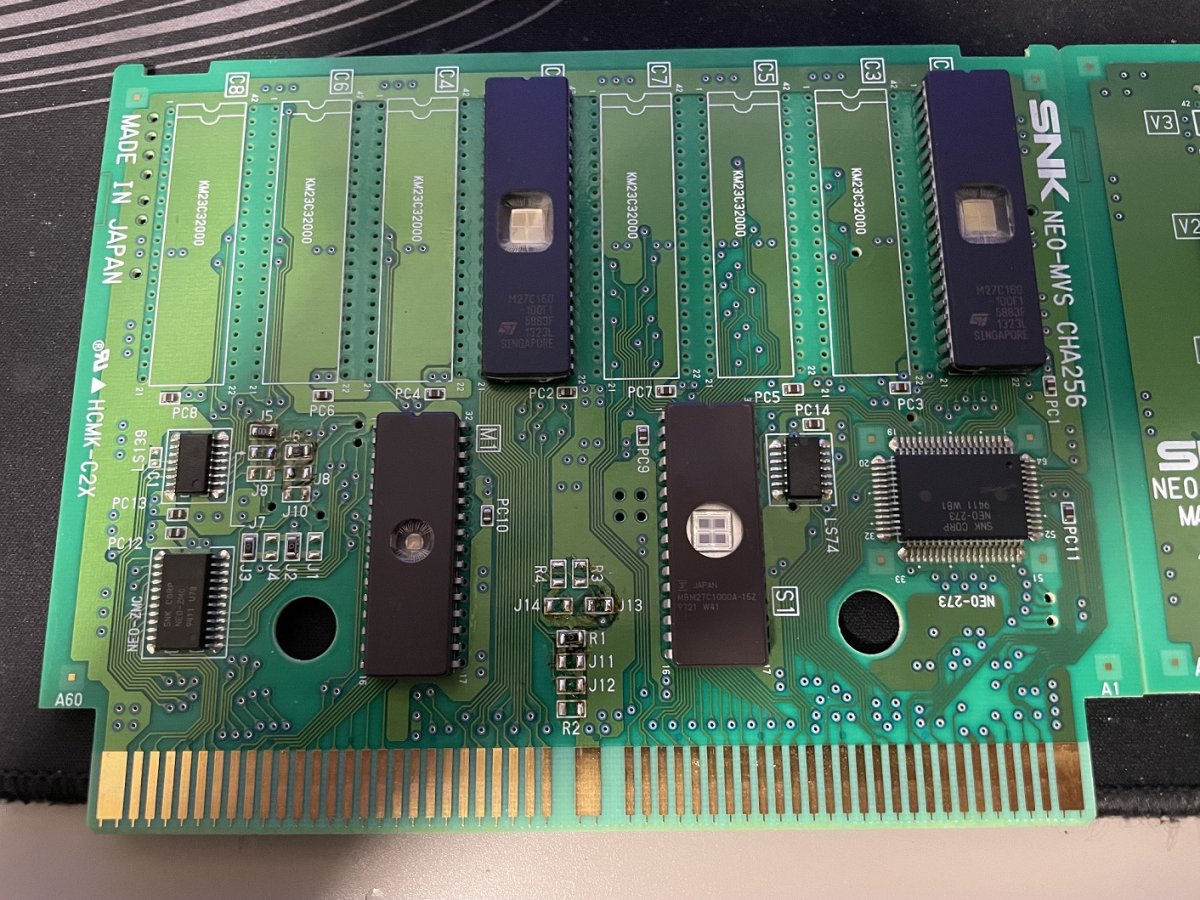

I'm trying to do a conversion of ViewPoint from a copy of Super Side Kik 2 (poor soccer game, no one love it)
All working fine, program will start so i can see P1 is good, sound also is good but someting wrong here with C roms.
View: https://youtu.be/TvlqWHcUW7M
I know the original game is on CHA42G and this roms is arranged in this way i think.
  • C1 = First 1MiB of C1 + First 1MiB of C3
  • C2 = First 1MiB of C2 + First 1MiB of C4
  • C3 = Second 1MiB of C1 + Second 1MiB of C3
  • C4 = Second 1MiB of C2 + Second 1MiB of C4
So if this is the logic i dont have to re-arrange data, but what i wrong ?
This is my last jumper configuration but i already try with J7 - J8, and CRC is correct.
This is a weird one. if you look at the MAME driver for viewpoint the first half of the C-ROMs is located at 0x000000 and the second half is located at 0x400000 So there's a big gap in there.
you'll want to use 27c322s and set the jumpers accordingly
you'll need to split the C-ROMs
C1_322 = C1_first half + 800mbit empty + C1_second half + 800mbit empty
C2_322 = C2_first half + 800mbit empty + C2_second half + 800mbit empty
or just to fill space:
C1_322 = C1_first half + C1_first half + C1_second half + C1_second half
C2_322 = C2_first half + C2_first half + C2_second half + C2_second half
As always you are a super user :D yes this trick is working i made the first rom settings.
Thanks.
