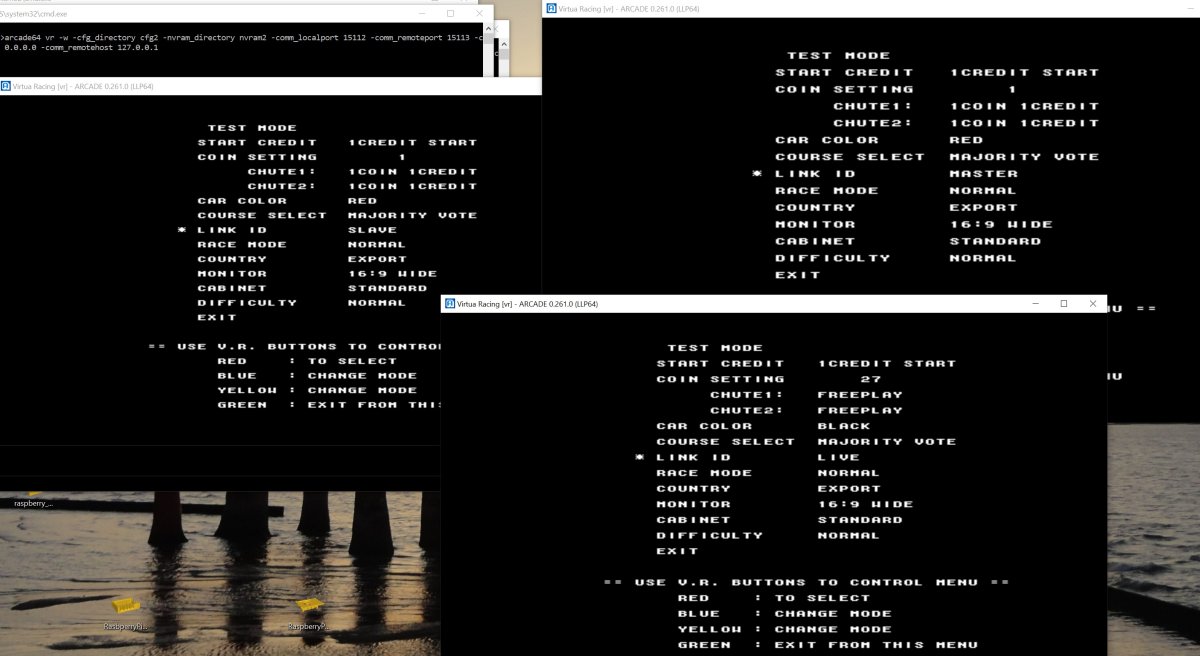

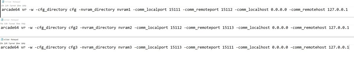

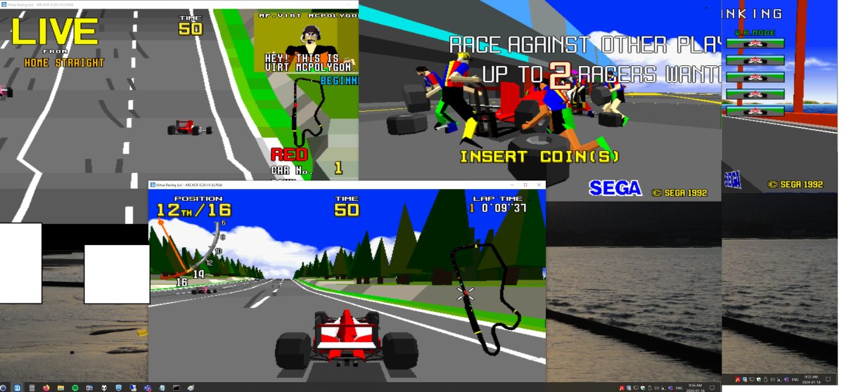

well I got it to work in mame:
1- you need to create an additional cfg and nvram subfolder per "station" and create yourself a batch files for each:
Code:
arcade64 vr -w -cfg_directory cfg -nvram_directory nvram1 -comm_localport 15111 -comm_remoteport 15112 -comm_localhost 0.0.0.0 -comm_remotehost 127.0.0.1
arcade64 vr -w -cfg_directory cfg2 -nvram_directory nvram2 -comm_localport 15112 -comm_remoteport 15113 -comm_localhost 0.0.0.0 -comm_remotehost 127.0.0.1
arcade64 vr -w -cfg_directory cfg3 -nvram_directory nvram3 -comm_localport 15113 -comm_remoteport 15111 -comm_localhost 0.0.0.0 -comm_remotehost 127.0.0.1
note: The first car talks to the next car (comm_remoteport) and the last car talks to the first car.
2- Set a master, a slave and a live in "link id"
3- Run and enjoy Mr. Virt Mcpolygon! :D

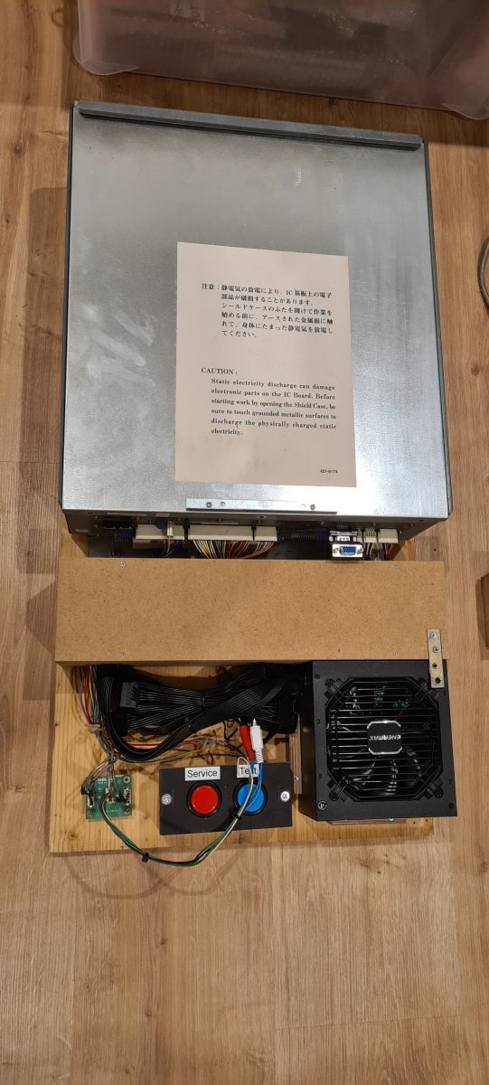

The Model 3 Daytona USA 2 has one too. Built one for it a while ago (attached picture) but currently missing an additional Rom board for it.
Still struggling with the colors. Mostly looks like grey is missing even if white or black is available. Maybe somebody is having an idea or hint?
